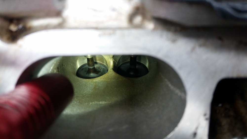

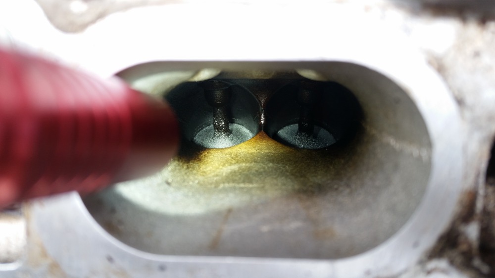

My 2017 Kia Forte 2.0 GDI engine has been misfiring and running a tad bit rough on cold starts and its only got 31K on it. I figured it was due to the valves gumming on so I was going to scrub them clean but people kept telling me to try the CRC GDI Valve Cleaner that you spray into the intake while its running between 2500-3000rpm. I never believe these miracle in a can products and I love it when I hear from people, "You should see all the crap that comes out of your exhaust!!". My response question to them is, how is it getting past the catalytic converter?
So I decided to remove my intake, get video of the valves condition before the treatment, then remove the intake again and see the valves after the treatment. Well this stuff did more harm then good. Yes a "tiny" bit was cleaned off but they are still gummed up. The biggest problem with this method is the design of the intake manifold. Since my 4cyl 2.0 engine's intake drops low before the air moves back up and into the engine head, a lot of that cleaner pools in the intake regardless how slow you go or how long you wait between sprays. Once you hit the throttle to drive off, it sucks a bunch of that crap up and starts pinging away and smokes like hell. Sounds like the engines is tearing its self apart.
I tried to be as cautious as I could with this crap. They say to empty the whole can in one treatment. I did it in two treatments with a long drive in between with light throttle to get the pooled fluid to evaporate and get consumed little by little. Still had a good amount get consumed at once, once in awhile. I only sprayed the can for about 3-4 seconds at a shot the first treatment, and only about 1/2 - 1 second the second treatment, both times about 30-60 seconds in between sprays.
My thoughts.....I will NEVER use this stuff in that fashion ever again! It MIGHT be ok with 6-8 cylinder engines that don't have a valley in the intake manifold where the stuff can pool up. It also leaves an oily residue behind which I had to clean out of the throttle body I just cleaned. How I would use it, is by spraying the valves and pooling it up in the intake runner, scrubbing the valves with a wire brush on a drill and then sucking out all the fluid and rinse them down with some carb clean or with the same cleaner.
Also within 31K miles, my throttle body had a real nice carbon lip on the bore. I was very surprised as to how bad it was. After I cleaned the throttle body and gave the engine hell with the spray can I reset all the adaptive values.
So it didn't clean the valves and I will be doing it how I was planning on originally next time I get time. I have video and pictures I need to put together with before and after shots so be patient, I'll get them together.
I"ll be back with updates
Well done being careful on that one. :ohmy: I had an ACDelco class where GDI carbon cleaning came up. Apparently, dealers have had issues with techs hydrolocking engines after a cleaning service. They dump the cleaner in at flat rate speed, hit the throttle on a test drive, and oops!
  • graywave

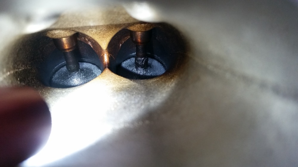

7 years 11 months ago - 7 years 11 months ago #23113 by graywave
Yup and I certainly will be keeping a close eye on my oil level and condition for a little while. It never burnt oil before so hopefully it stays that way. Its under warranty still lol. No matter how careful I was it was still not careful enough. Never ever again.

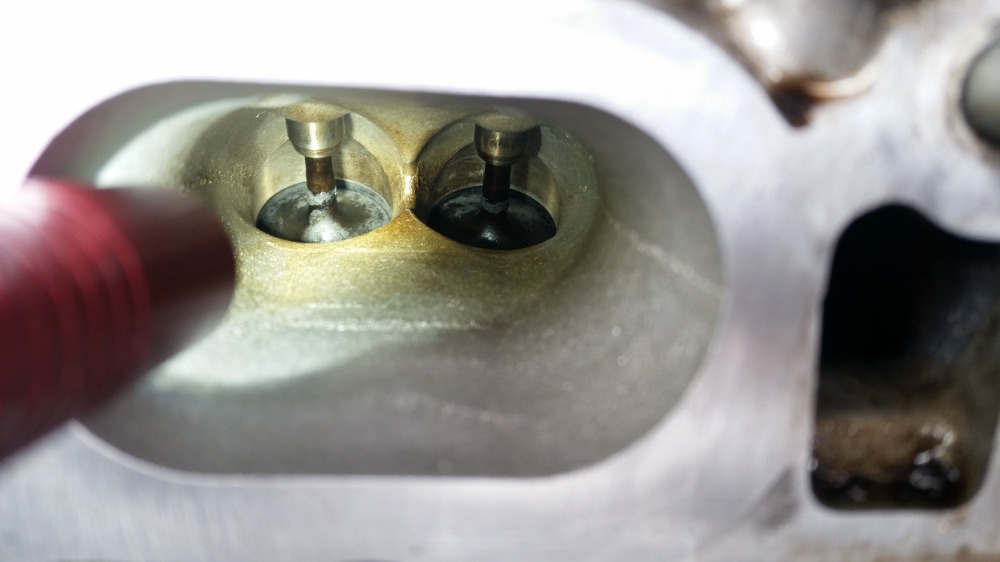

Pictures are green cause I had to use night vision to see them.
Here is one of Cyl 1 valves before. I have all the others still in video just needing to find time. All other valves look the same though.
Here is one of Cyl 1 valves After. Same one. little hard to see since its open this time. I"ll get the other pics.

7 years 11 months ago - 7 years 11 months ago #23188 by graywave

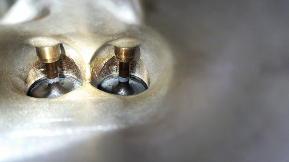

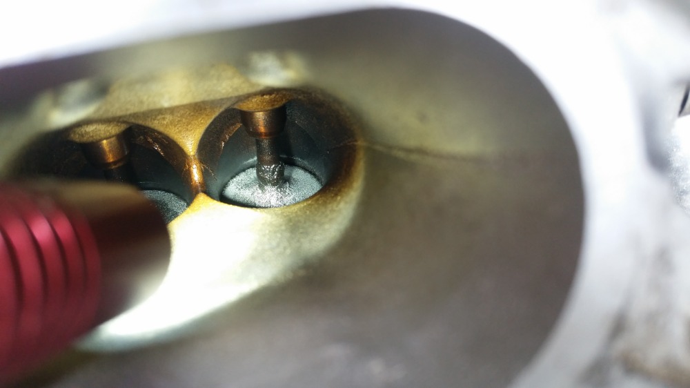

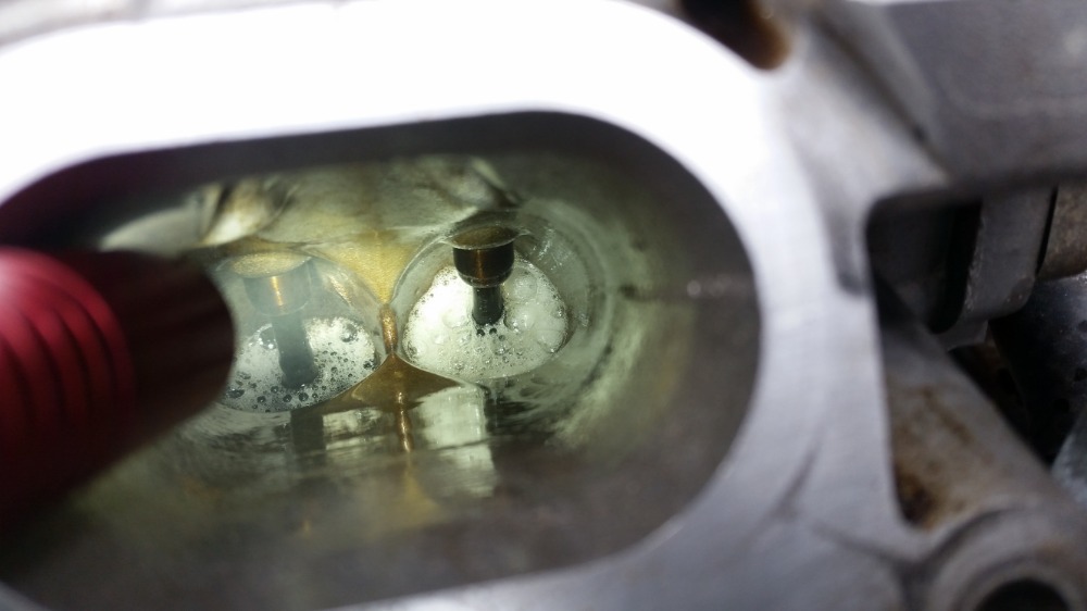

Here are some pictures of the valves after cleaning them by hand. I did use the CRC Valve Cleaner as the cleaning solution. Spray the valves bores and let it sit for a couple min. Blew everything out with an air hose while keeping a paper towel over the bores to catch everything.
I'm very satisfied with the results. Wish I could have got it all but it took about 4 hours to get them this clean using nylon brushes.

Shiny. B) Unfortunately, this is probably gonna be a regular service on GDI's like this.
