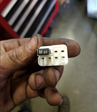

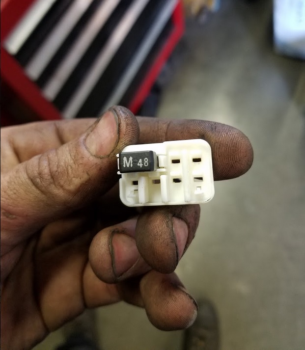

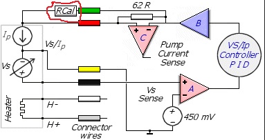

4.) Trim resistors and missing wires
Throughout this article, I’ll refer to sensor designs by the number of harness side wires, i.e. four, six, or seven wires. It’s important to note on the six and seven wire designs, you’ll actually only see five wires on the sensor side. Why? Trim resistors. See below:
The trim resistor (AKA resistor chip) is integral to the wideband sensor connector (not the sensor itself), and is installed at the factory to allow the PCM to account for manufacturing tolerances. This resistance is measured by the PCM on a dedicated circuit, and can be installed parallel to the heater power OR sensor signal. Honda even goes so far as to have two wires dedicated for the resistor circuit on their seven wire designs.
Can trim resistors cause fuel control problems? To be honest, I’m not sure, as I’ve never seen it before. Anything’s possible!

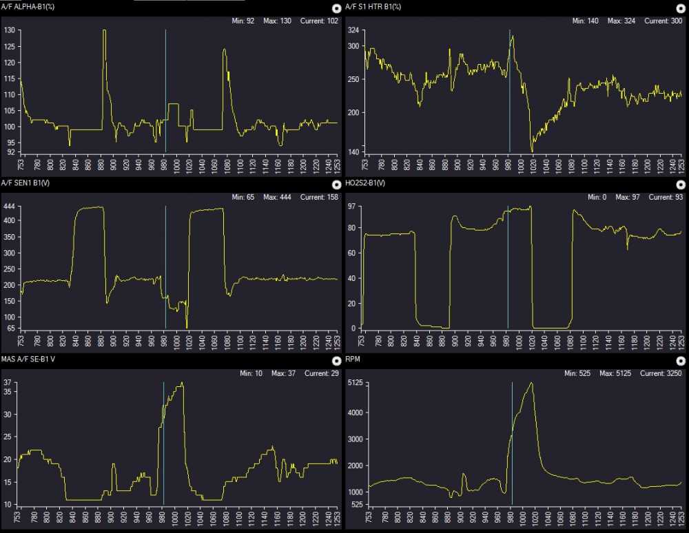

-Scan data-
www.scanshare.io/share/9ps_DognO0u_ollTdSyNEQ#0,1,24,25,26,27
Scan data will show a voltage data PID associated with the A/F sensor signal. 3.3V represents stoich, lower indicates rich, and higher indicates lean. Seeing spikes in the data is not unusual during sudden changes in engine load.
It’s important to understand that, while the scan data displays the A/F sensor signal as a voltage, this is NOT the true sensor signal. The actual signal is a changing current, while the voltage at the sensor never changes. The A/F sensor data PID is merely an interpreted value based on the current signal.
Toyota sometimes provides a sensor current PID in mA, in addition to the voltage PID, but not always.

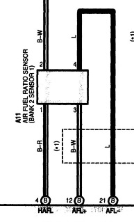

-Wiring checks-
Wiring checks on these sensors are fantastically simple. Four wires, following the typical Bosch O2 sensor-side wire color format - the two wires colored alike are the heater circuit, the other two are for the sensor circuit.
Plugged in OR disconnected, you’ll find 3.3V on one sensor circuit wire (AFL+ on the diagram), and 2.9 - 3.0V on the other (AFL-). NEITHER will change significantly during mixture variations. 12V on one heater wire, and a computer controlled ground on the other, just like your typical heated O2’s.
The voltages seen on the two sensor circuit wires are provided from the PCM to the sensor connector, and therefore makes for easy circuit checks. If the above sensor circuit voltages are found at the connector, then the wiring is good!

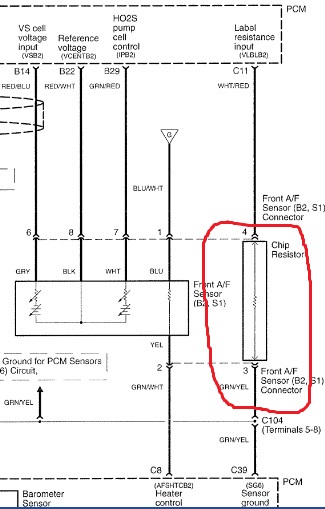

Honda/Acura
The Honda four wire wideband sensor is VERY similar in design and operation to the Toyota sensor, most commonly found on their four cylinder engines. The V6’s usually get the seven wire sensor, which I’m not addressing just yet. Perhaps in the future!

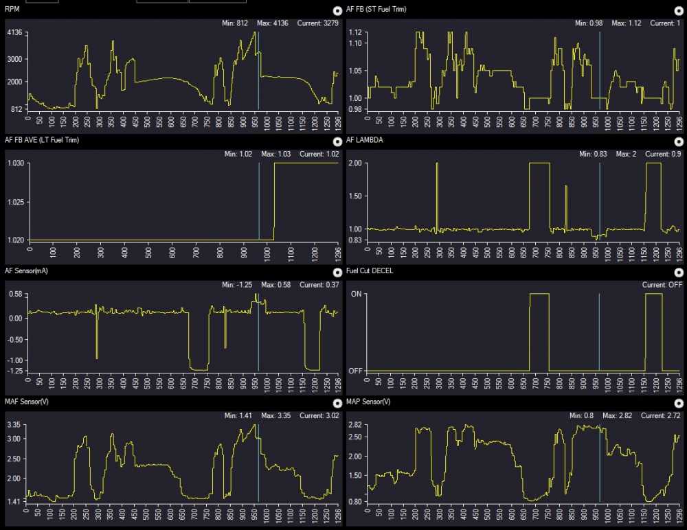

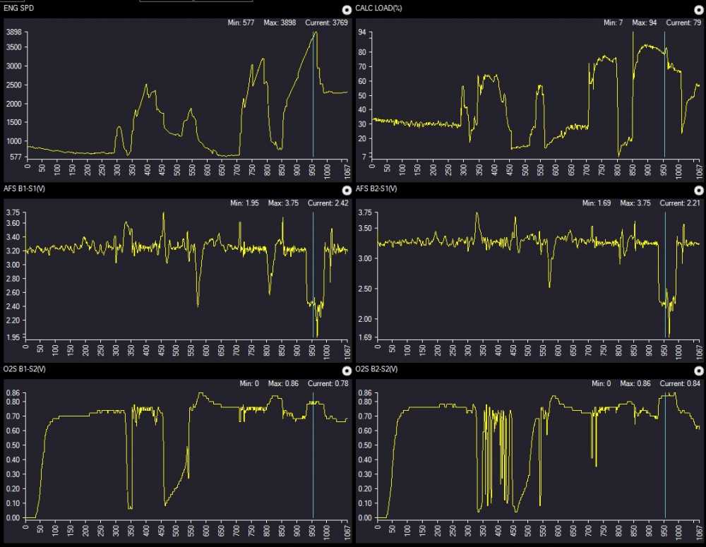

-Scan data-
www.scanshare.io/share/ZsdIdUM6zkK47APTf-fFqw#0,2,3,4,5,42,43
Honda will typically display the sensor current directly, no voltage conversion shenanigans. 0 mA represents stoich, negative current indicates lean, and positive current indicates rich. Have a close look at those current values: Around .4 mA during power enrichment, and 1.5 mA during fuel cut decel. This is why measuring the sensor signal directly is so difficult!
Note the AF FB and AF FB AVE PIDs - these are Honda-ese for short and long term fuel trims. Snap-On was kind enough to add the translation in, but I can’t say that all scanners will do this. They’re also not displayed like typical fuel trims, so remember this: Values above 1.00 represent positive trims, and values below 1.00 represent negative. For example, if your data showed AF FB at 1.13 and your AF FB AVE at .98, that would translate to a short term of 13% and a long term of -2%.

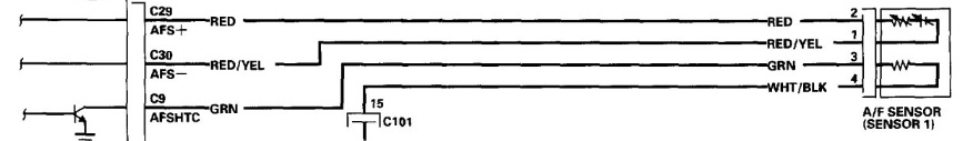

-Wiring checks-
Circuit checks are almost identical to the Toyota sensor, with a similar Bosch sensor-side wiring color format, and similar wiring diagram designations. Plugged in or disconnected, you should find 2.2V on AFS+ and 1.8-1.9V on AFS-. Again, neither voltage should change significantly during typical operation. 12V feed for the heater, computer-controlled ground.
Like the Toyota sensor, this design makes it very easy to quickly verify circuit integrity, even without a wiring diagram.

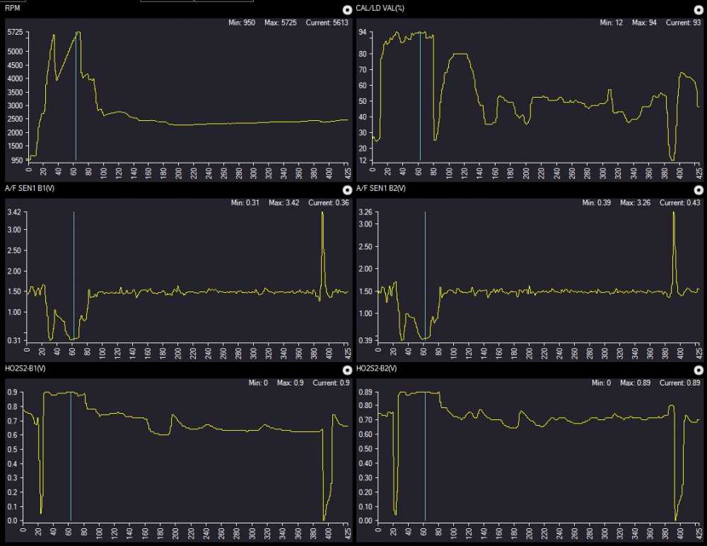

-Four wire scan data-
www.scanshare.io/share/acu6f1Lofk6YwAmKhhrDyw
The Nissan four wire sensor is another ‘current critical’ design that produces a current signal, but gets (mis)represented in scan data as a voltage. Again, this is smoke and mirrors - see Toyota wideband sensors above. 2.2V represents stoich, with over 4V seen on fuel cut decel, and 1.6V or less at WOT.
-Six wire scan data-
www.scanshare.io/share/RhcQ5whqU0mPCutDLNC56w#0,2,5,6,7,8
The six wire signal also uses a voltage signal PID, with 1.5V representing stoich this time. Another converted value… Why can’t OE’s treat us like adults? 3.00V or higher during fuel cut decel, and .7V or less during wide open power enrichment.
With both types (and conventional zirconia O2’s), Nissan has it’s own designation for short term fuel trims, ‘Alpha’, and they function just like the Honda AF FB PIDs. Values less than 1.00 are negative trims, greater than 1.00 are positive trims. I do occasionally see long term fuel trim PIDs in the scan data, but have NEVER seen them change or adapt to mixture problems. Take them with a grain of salt, IMO.

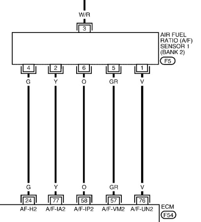

-Four wire wiring checks-
Checking this sensor is so similar to the Honda and Toyota sensors, I can’t help but think they’re all made by the same manufacturer. Bosch sensor-side wire colors, as usual.
Note the shield around pins 1 and 2 - dead giveaway that these wires are the signal circuit. Look for 2.2V on one, and 1.8V on the other. Just like the other four wire sensors, neither voltage will change significantly with the sensor unplugged or during mixture changes. Heater power and ground on pins 3 and 4.
-Six wire wiring checks-
All voltage values described here will be from the harness side, with the scope/meter connected to battery ground. You’re probably thinking, “Duh!”, but some test procedures will have you connected to the sensors floating ground instead. If you choose to do this, just subtract 2.5V from all values below.
Unlike the four wire sensors we’ve covered, the Nissan six wire sensor voltage values WILL change during mixture variations, and if the sensor is plugged in or unplugged. For that reason, I’ll make the distinction between plugged in and unplugged below. Refer to the above diagram for pin numbers.
Plugged in:
Pin 1 (Sensor input) = 3.00V
Pin 2 (Sensor signal) = 2.5V at stoich, varies +/- 1.0V with mixture
Pin 3 (Heater power) = 12V KOEO or KOER
Pin 4 (Heater control) = Pulsed ground from PCM
Pin 5 (Floating ground) = 2.5 - 2.6V
Pin 6 (Trim resistor) = 2.5V at stoich, varies +/- 1.0V with mixture
Unplugged:
Pin 2 (Sensor signal) = 0V
Pin 4 (Heater control) = 5V pulses
Pin 6 (Trim resistor) = 0V
First, notice the sensor signal on pin 2. 2.5V is stoich out at the sensor, but 1.5V on the scan data. Second, notice that all voltage disappears from pins 2 and 6 with the sensor unplugged. That means there is no PCM-provided bias voltage to use for circuit integrity testing on these wires, and must be tested by other means if you’re chasing a no signal issue.
