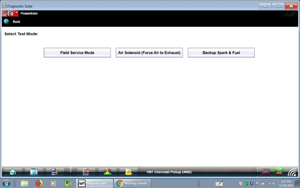

I need a that is bi directional and will still do obd 1 . My 1991 chevy truck it keeps going. My question is should i go solous or go apollo D8?
6 years 10 months ago - 6 years 10 months ago #36228 by Noah
Either one will do the same thing, as long as you can get your hands on the correct OBD 1 GM adapter. Later software versions are more desirable.
You may be disappointed in the level of bidirectional tests available for that truck.
here's a screen shot of what my Verus Edge has for your truck, running 19.4 software:
