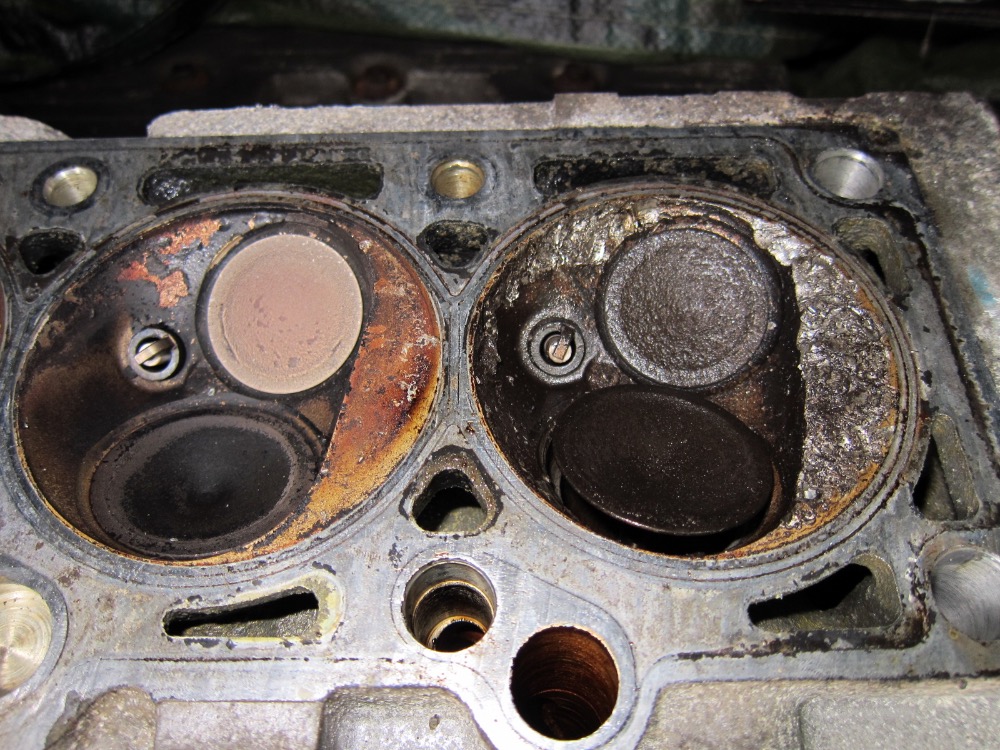

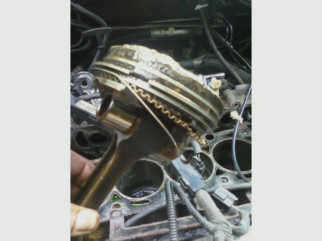

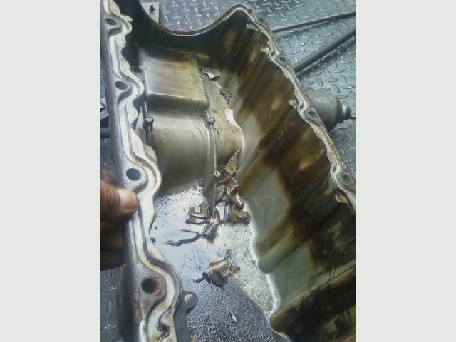

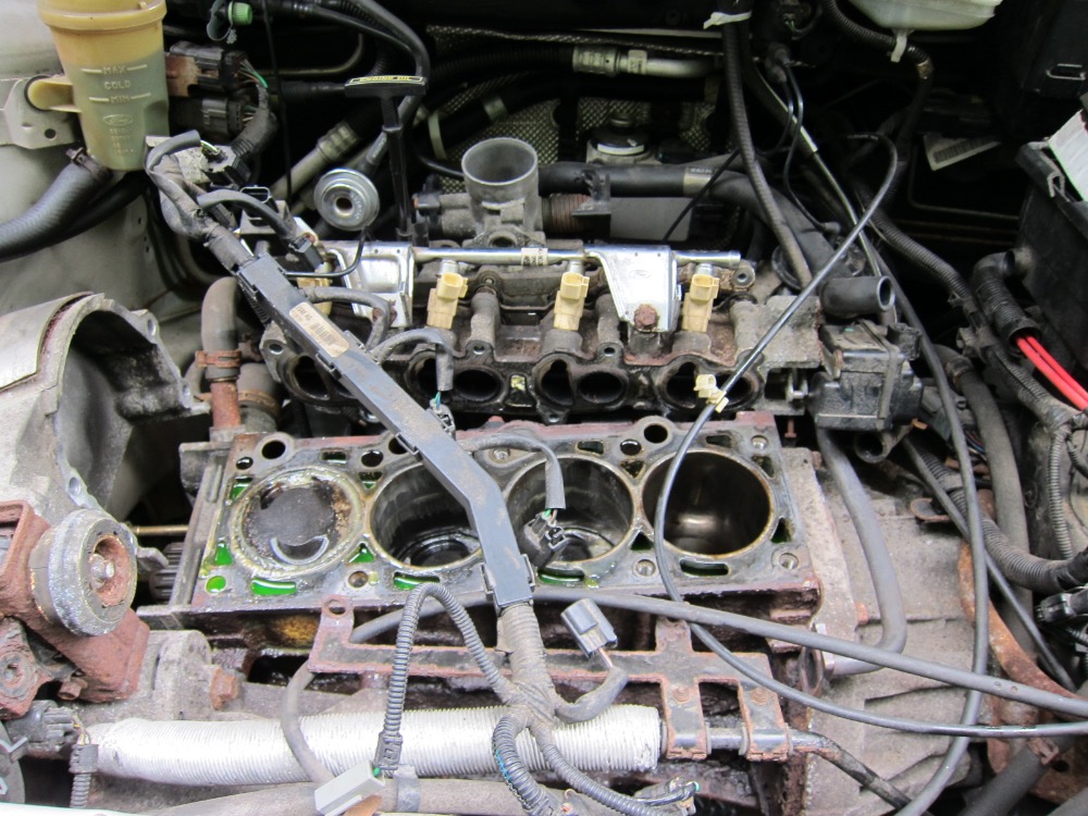

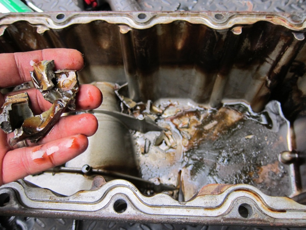

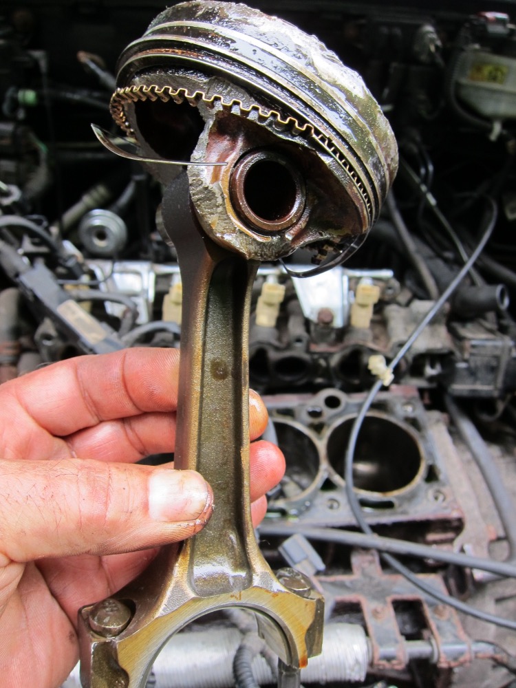

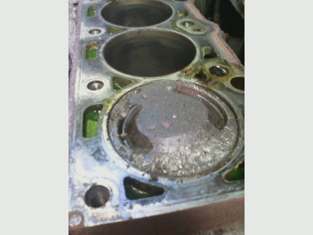

First up is a 2000 Ford Focus 2.0 engine. My cousin sold me the car for $500 back in 2012 as it sat, not running. Said it just quit. Well, as soon as I yanked the head I knew I was in for an adventure! It's the notorious valve-seat-spitter. Long story short, I repaired the carnage with a reman head, and just slapped a new piston and rod in it. We drove it for 8k miles trouble free, and decided to sell it (since it was a 4th vehicle). I threw it on eBay, and it's new home is somewhere in Africa now. :cheer:

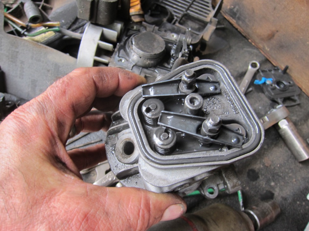

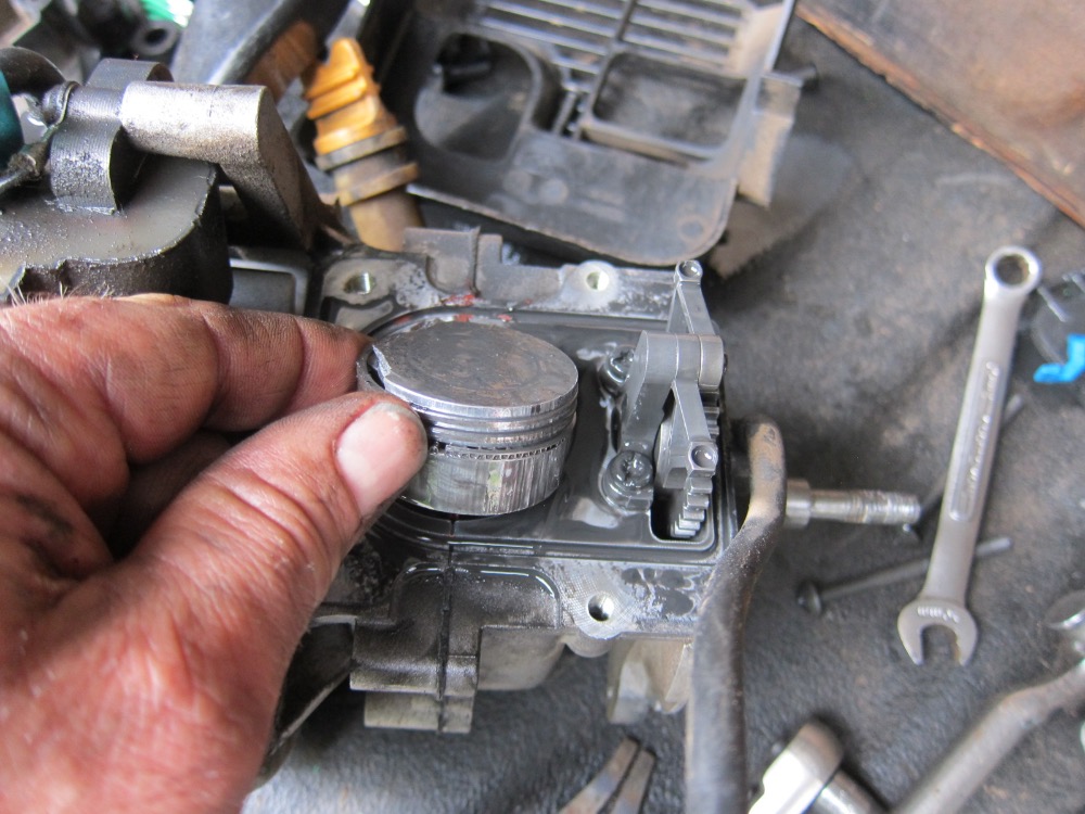

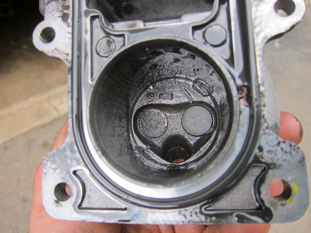

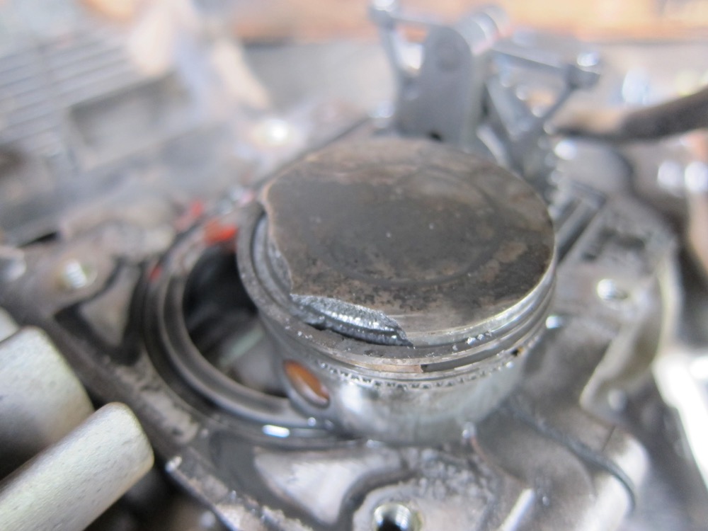

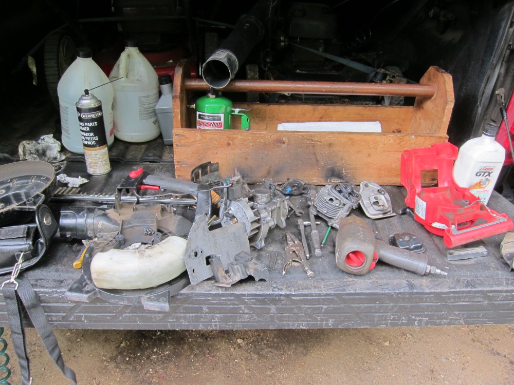

Second up is a Toro 4-stroke leaf blower. My neighbor brought it to me from his boss to get running. Figured just a carb clean, valve adjust, and oil change and she'd be on her way. Well, turns out nobody had changed the oil in this one ... EVER! It's a 2010 model, lol. Long story short, after doing the above and getting her running probably better than it ever has, she promptly grenaded in my hand. :lol: Lack of maintenance caused wrist pin bearing failure, which caused the piston to contact the head, and smash & break the ring land on the piston!

Leaf blower pics:
8 years 11 months ago #10194 by Noah
Replied by Noah on topic Engine DESTRUCTION / CARNAGE thread
Well there's your problem!

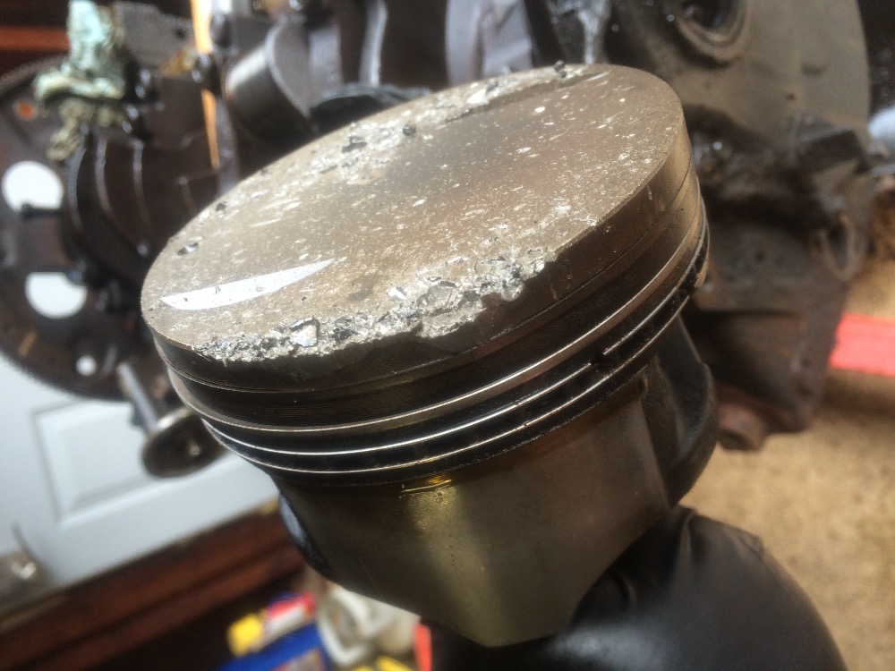

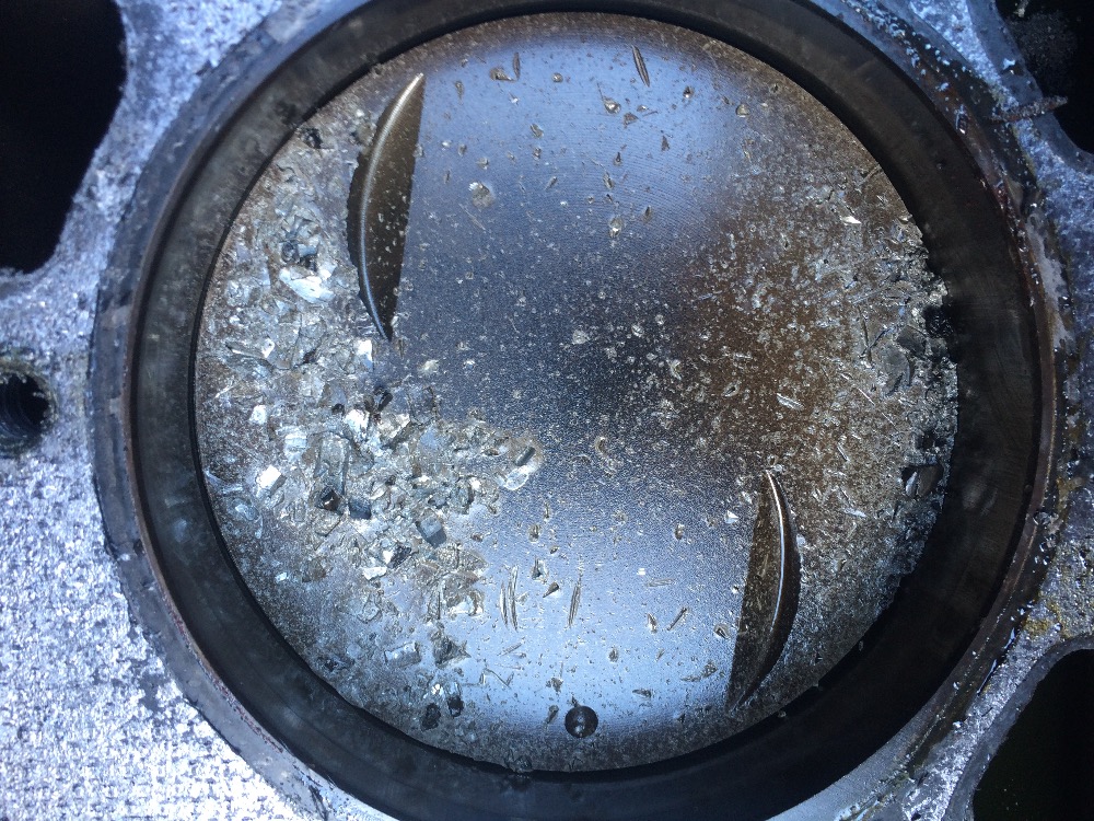

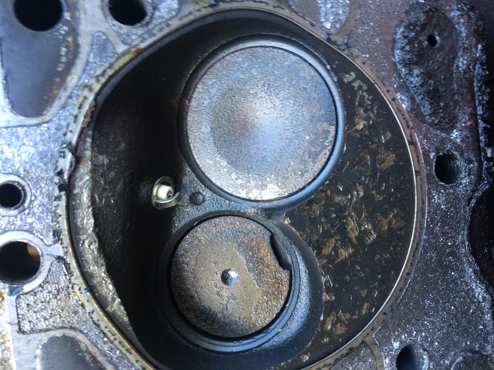

As long as we're sharing. My current ride 97' k2500 burb 454. Bought it with a "noise". And for sure, a valve seat makes a funny "noise" when the piston is relentlessly pounding it into the head.

Yikes!

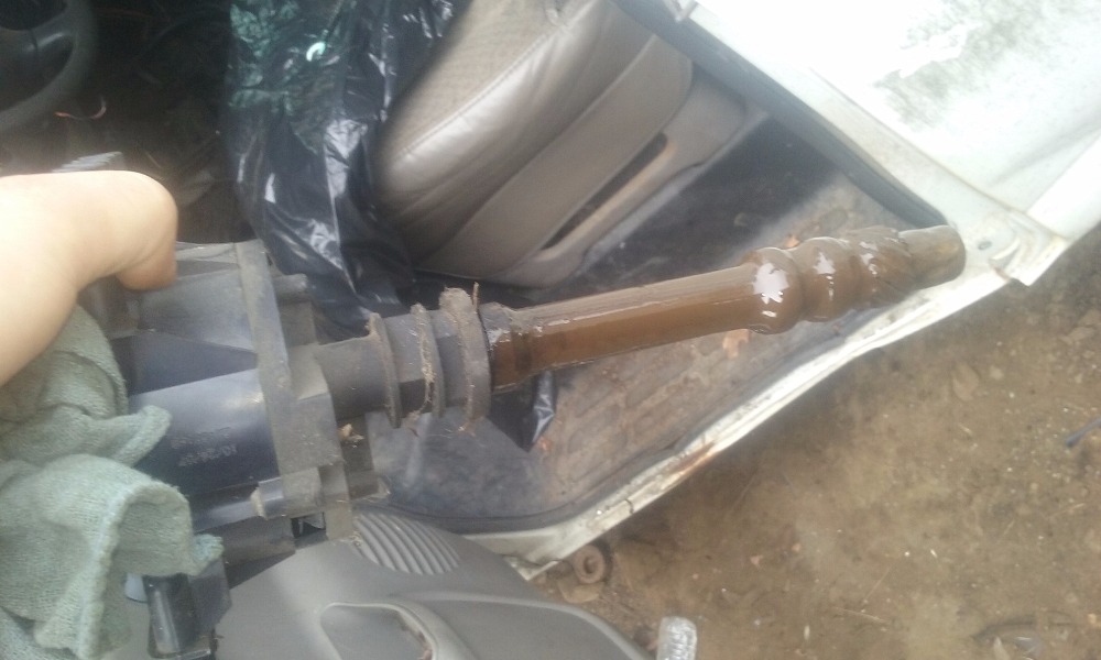

That's what the big knob all the way to left of the stereo it's for, right?

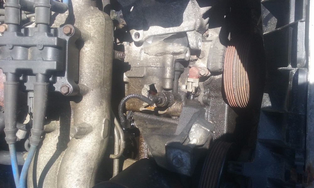

8 years 10 months ago #10889 by Noah
The old left knob only helped this Subaru for so long...

OUCH! That piston took a pounding, similar to the Focus I had.

Nice hole in the block there, Noah! :D

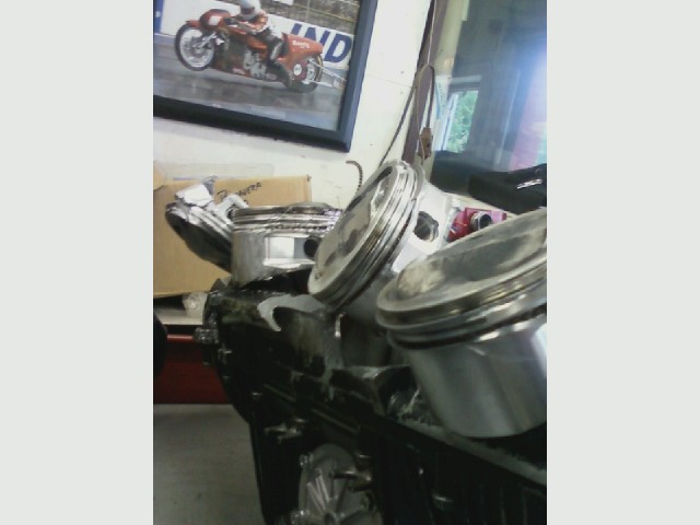

Always epic destruction when they come apart at high RPM ... especially over 9 grand. :) Great story Andy!
You just reminded me that I have a pic of an older air-cooled Kawasaki drag bike engine that was fed too much nitrous. I saw the block sitting there when I came to pick up engine parts for my RD350 from the machine shop about 7 years ago. On the piston in the back there, the ring lands were crushed flat! Crappy cell pic doesn't do it justice. Thing was mangled! :lol:

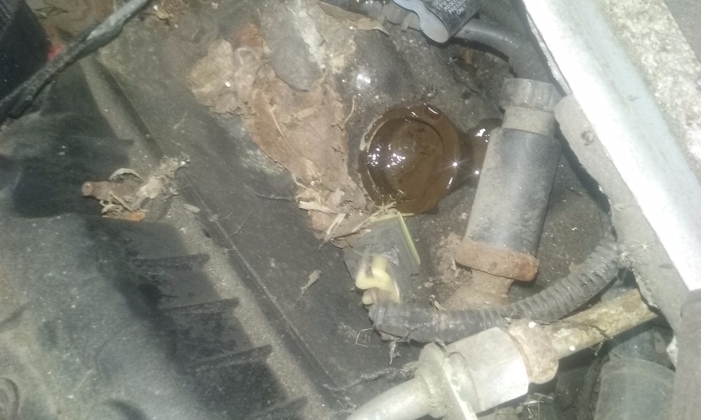

This poor GMC Van with a 5.7l Vortec was full to the top with a lovely coolant/engine oil slurry.
Seriously, to the top. Level with the distributer hole in the lower intake!

Oh wow, HAHAHA! Won't be cranking THAT one over ... :D

Holy CRAP! :woohoo: That's horrible. What was the reason you were looking at this one? Lemme guess, the A/C wasn't working? :lol:
