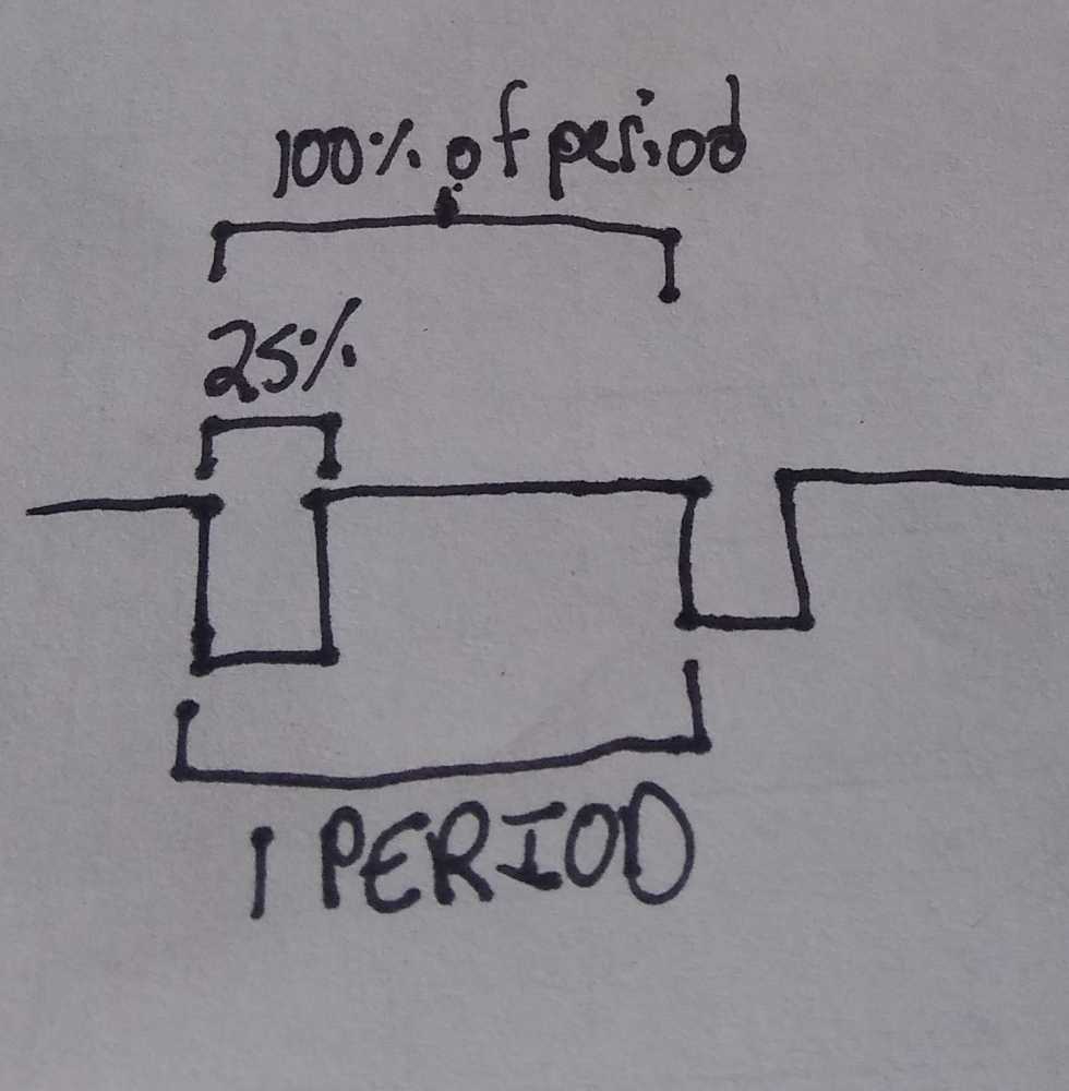

In a certain digital waveform, the period is four times the pulse width. The duty cycle is ______?
A= 0%
B= 25%
C= 50%
D= 100%

9 years 7 months ago #7617 by SniperDan
Replied by SniperDan on topic Test question
One period is the amount of time between the start of a cycle, to the beginning of a new cycle. The answer to this question would be 25%

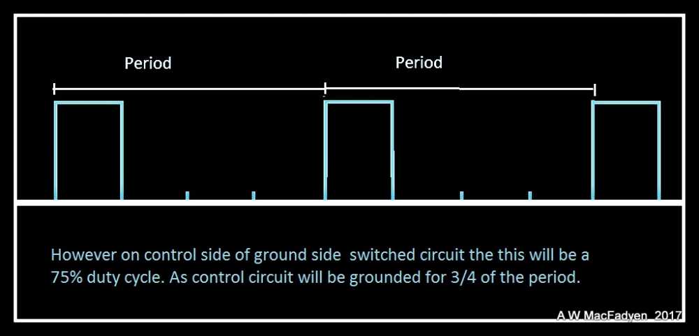

On a 12v solenoid that is duty cycled and ground side switched, a digital multimeter is used to measure control side voltage. The voltage reading on this circuit read 3 volts. Assuming this solenoid is duty cycled continuously, what is the duty cycle of this solenoid?
A. 75%
B. 33.33%
C. 50%
D. 25%
~W. Edwards Deming
Last edit: 9 years 7 months ago by SniperDan.
9 years 7 months ago #7621 by Knoxtech
Replied by Knoxtech on topic Test question
Here goes another probably wrong answer but I would say Answer A. 3volts /12 votls = 25% but because the device is ground side switched and measured with a multi-meter the reading is the off time so you have 75% on time.
9 years 7 months ago - 9 years 7 months ago #7623 by Andy.MacFadyen
Replied by Andy.MacFadyen on topic Test question
I have come across two different ways of defining duty cycle.
This is the one that makes sense.
en.wikipedia.org/wiki/Duty_cycle
Key is current flow the percentage of the time current is flowing --- what proportion of the time the device is powered up.
Ground side switched circuits have to be considered with care. As measuring across the pins of groundside switched circuit will give a different wavefom than measuring between the control wire and chassis ground.

9 years 7 months ago #7627 by Dylan
Replied by Dylan on topic Test question
Knoxtech wrote: Yea I'm a little confused even after looking a waveform diagrams on google. So a period is one cycle or basically in a duty cycle "on time" plus "off time" (some one please correct me on anything this wrong). So I that's why I had had picked 50% but the. You take the 4 times pulse width I can see how you get the 25% . Still pretty confused. I assume Dylan know the correct answer and with a explanation. If you use my math of the clue from the questions I feel like the the correct answer is B 25% with 12.5 on time. Please Dylan let me know how badly I missed the " easy question".
Correct! Don't doubt yourself. Reasoning is good. Thx for answering :)

9 years 7 months ago #7629 by Dylan
No challenge for you SniperDan. Thx :)

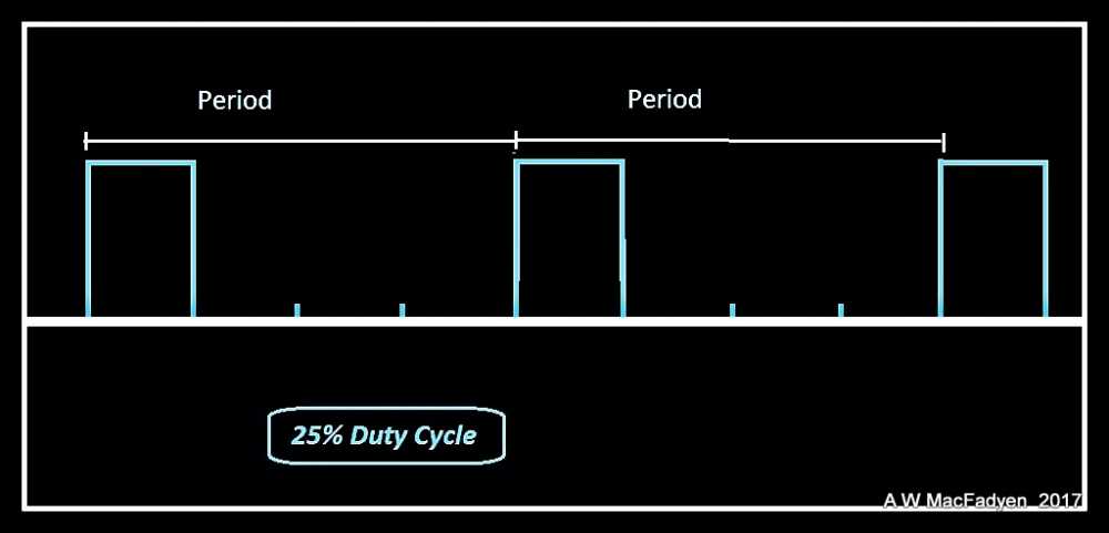

9 years 7 months ago #7630 by Dylan
Andy.MacFadyen wrote: I have come across two different ways of defining duty cycle.
Yes. 2 periods with a 25% duty cycle

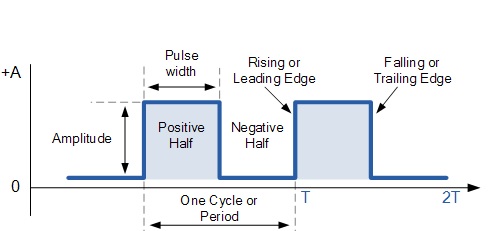

Duty cycle equation:
D=PW/T X 100%
D (Duty cycle)=Pulse width (On-time) divided by T (total period of the signal) multiplied by 100%

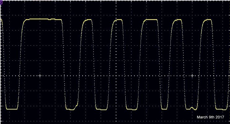

9 years 7 months ago - 9 years 7 months ago #7637 by Andy.MacFadyen
This is the the duty cycle output from a Denso alternator signal wire to the PCM.
High load on the alternator pulls the duty cycle down, normal duty cycle at idle is roughly 60% . This is the effect on the duty cycle of turning the heated rear window on.
If the alternator is loaded up using a carbon pile tester the alternator will go full field and the output amps will max out under these conditions the duty cycle will flat line at zero.
