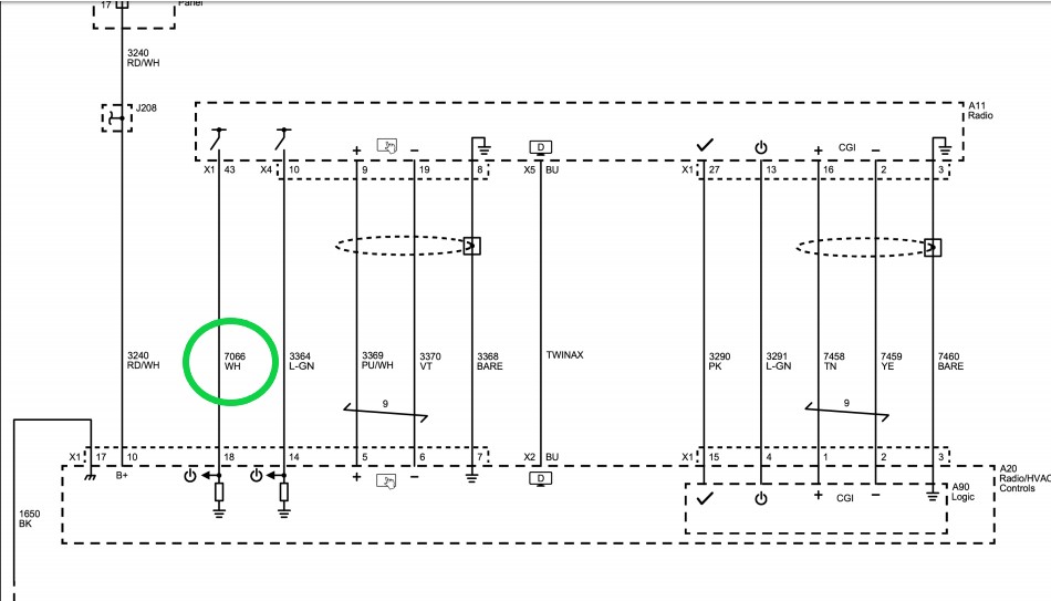

9 years 6 months ago #9005 by victor1979
Hey guys have any of you had a problem with a 2013 Camaro were the radio screen and the hvac go on and off and then no radio at all and no control on the air conditioning.. customer got a diagnostic at a Chevy dealer and they said he need it the a/c blower resister module and the radio/hvac controls which is one unit complete however the labor was too much and he decided to buy the oem parts and had me installed them well we did that yesterday and was a complete waste of money because it didn't fix the problem.. help guys thank you.

7 years 11 months ago #24991 by JanaJayyy
Replied by JanaJayyy on topic 2013 chevrolet camaro v6 RADIO/HVAC CONTROL UNIT
I just fixed mine by cutting the white wire behind the radio, there’s videos all over YouTube on how and which wire. I own a 2013 2LS..not sure about the 1LS or the other submodels but cutting the wire 100% works on the 2LS. My radio/ac/heater/door chime/blinker would randomly flicker on and off, as soon as I would put in a cd it would eject it, loud pops from the speakers..this happened every single time I drove the car. I’ve had not a single issue since I cut the wire. Saved a lot of money just by watching YouTube lol. The video is posted on this guys page: Kjdcomp1
7 years 11 months ago #25025 by Tyler
JanaJayyy wrote: I just fixed mine by cutting the white wire behind the radio, there’s videos all over YouTube on how and which wire. I own a 2013 2LS..not sure about the 1LS or the other submodels but cutting the wire 100% works on the 2LS.
Interesting! Do you recall which white wire, exactly? Wondering if it's this one:

I have the same problem as Jana with my 2013 2LS. Radio, screen, indicator lights, blinker sound, fan, going on and off, speakers crackling. The dealer diagnosed it as the radio control head. They initially thought it was the alternator spiking. The head is on backorder for over a month now. I saw on a forum about cutting the white wire but wasn’t fond of doing that without understanding it. Best I could find is that it controls the blinker. I’m planning on stopping into the dealer to find out where they are getting this part from as well as considering getting a used part and installing myself. Frustrating.

Also, I did update my case with GM. They said they would get back to me. Since then I forwarded the schematic from this site and the comment about cutting the white wire. I asked the rep to show it to GM TAC and ask for feedback.

1 year 10 months ago #73907 by malibupaul
Replied by malibupaul on topic 2013 chevrolet camaro v6 RADIO/HVAC CONTROL UNIT
I don’t know what the white wire is for. I saw one comment that said it was the flasher switch.
