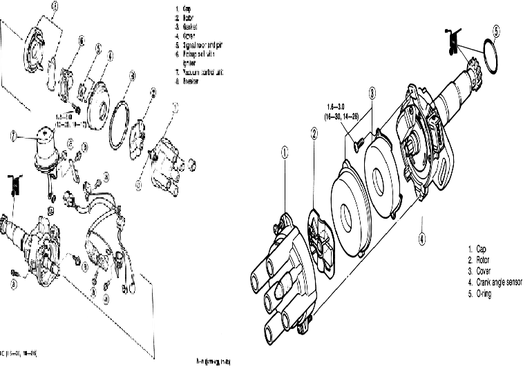

I need some help.on a 92 mazda pick up b2600i 4 cylinder. . There is no spark come out of the ignition coil..
Follow the chapter 22 page 8
I got 12 with ifnition switch on.
On the (+)wire. And on the (-)wire agot a constant light
Following my diagram. (Like u will see in the picture?)i got a igniter (transistor) and a condenser.. i take the igniter tothe auto parts to tested but it pass 3 times show its good.and the condenser got 2 cracks on the bottom.
My question. Can the condeser be bad and make the igniter not working right?
How do i test it?
Or im messing something?
Thank u sd and every one for let me be part of this new world for me .. God bless u all.

That would be sweet but if you look at the diagram, there is a coil and a "+" inside the distributor that when it passes near each other pulses the igniter and that wire will send the cluster a signal for the tachometer. Only problem would be if that diagram is wrong. Please tell me if your distributor looks like this :
www.mazdabg.com/ftp-uploads/Mazda/--Repa...s/8964/89642gA6L.gif
or if looks like this:
www.mazdabg.com/ftp-uploads/Mazda/--Repa...s/8964/89642g14L.gif
Thank you for your patience. See attachment and tell me if your distributor looks like the one with the big ball attached on the side or with the 4 wire connector.....

Its a 4 wires conector...
What i believe the igniter is bad or the bracket is dusty. .so cont pick it up a good ground..
Like i said on the last message
What i understand is the crank angle sensor send the signal to the ecu and then the ecu use that signal to send a low volyage to the igniter. And then my igniter start acting like a toggle swiching on and off to make my coil make spark.

did you got the voltages with the engine cranking ? as the crank sensor inside the distributor see the engine rotating a voltage should be pulsing at the pink (P) and the yellow/blue wire (Y/L). You should have ground at the black (B) wire and battery voltage on the black/yellow (B/Y) as the Main Relay gets energized.I think you can backprobe it and check for pulse with the pp4. Thank you.
