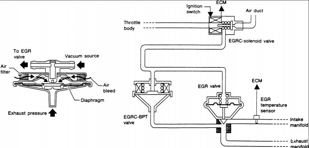

Hello guys. A friend of mine has been driving his 95 Maxima for a better part of the year with a CEL. Since I'm new to troubleshooting and finishing Paul's book, i wanted to help him and gain some experience as well. I came to the conclusion that the ECM had a faulty driver. I have a couple of questions but I'll ask them one at a time after your input. Thanks in advance.
One of the codes was the P0400. After doing some research the EGRC Solenoid Valve is grounded (On) by the ECM, the plunger will move to block vacuum to the EGR valve when the following conditions occur:
1) Low engine coolant temperature
2) Engine starting
3) Engine stopped
4) Engine idling
5) Excessively high engine coolant temperature
6) Low vehicle speed
With the KOER I remove the hose from the EGR valve and felt vacuum . i thought this was odd since the solenoid should be energized. Putting that aside for now I applied vacuum to EGR valve and the engine stalled so I know the passage ways are clear. I focused on the EGR solenoid next. I know its ground side switched so with the KOEO, solenoid plugged in, using a VOM, I had 13v feed but .225mv on the control side when I know it should be 13v when there is no voltage drop.
So here is my first question. Am I correct into thinking that the driver for the solenoid is not ON until engine is running? With KOEO doing voltage measurement the driver is OFF? If so I suspected a short to ground.

9 years 11 months ago - 9 years 11 months ago #2147 by Tyler
Hey sir! Glad to hear you're getting your hands dirty, good times :cheer:
I think you're correct in your thinking that the driver is likely off (not energizing the solenoid) with the key on, but should be with the engine running to prevent unwanted EGR operation.
Your voltage readings KOEO could suggest a short to ground in the control wire, but that would result in the solenoid being energized all the time. If that were true, then you SHOULDN'T have felt vacuum at the EGR valve. Could be that the solenoid is mechanically stuck, but we can get to that later.
To me, it's more likely that you're looking at a failed EGR solenoid, likely high resistance. That'd explain your voltage readings, and why you're getting vacuum at the EGR valve at idle. There's lots of ways to test for this, but the easiest would probably be the good ol' test light. Here's a great ScannerDanner video demonstrating this, if you haven't seen it already:
He's testing an EVAP solenoid in the video, but the procedures are identical. You won't have bidirectional control, but you can get the driver to activate by starting the engine. Please feel free to ask questions if you're unsure of this test!
The EGR solenoid aside, I'm curious - if you felt vacuum at the EGR valve at idle, then was the valve open at idle all the time? If my memory serves, these systems employ some kind of mechanical transducer that works off of exhaust backpressure. Am I thinking about this right? Could be way off, lol.

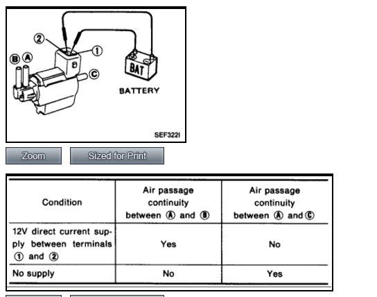

Thanks for your reply! Since I suspected a short to ground, I started moving the harness to see if I lose it. It didn't happened. With the ignition off,, disconnected the the connector and back probed the control side. DVOM red lead to positive battery and black lead to control wire and I read system voltage. Used a incandescent test light, it didn't light but with a LED test light it did. My next step was to plug the connector back in back probe the control wire, disconnected the ECM, 12 volts came back with KOEO and 12 volts on the ECM female pin. Plug the ECM back in and I lost 12 volts on the control side. I suspect a bad driver to the EGR solenoid.
According to AlldataDIY the solenoid when energized moves the plunger to stop vacuum during any of those 6 conditions i mentioned earlier. When I revved up the engine the was more vacuum.

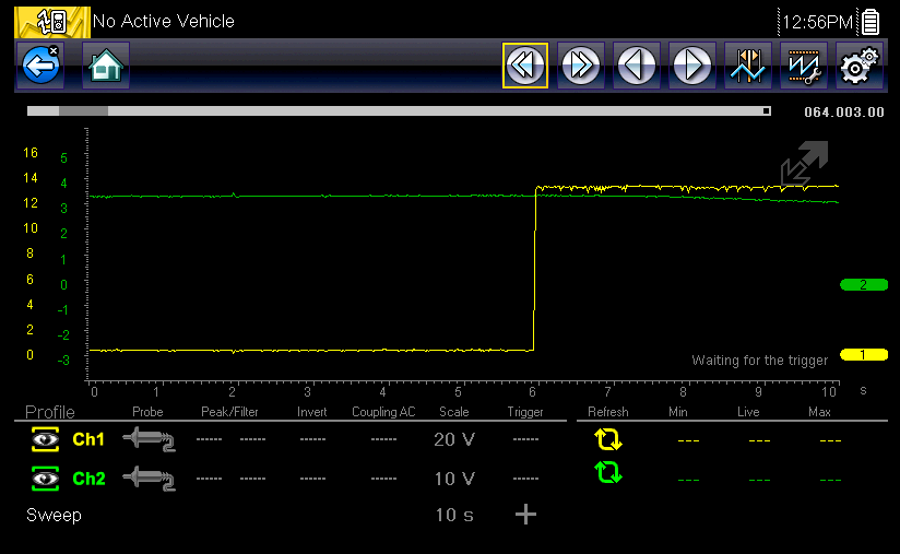

When I had the solenoid unplugged, test light to B+ and control wire the incandescent didn't light but with the connector plugged in, the incandescent did light. The video you posted for me (thanks BTW!) it showed the connector still plugged to the solenoid.
When I disconnected the ECM I got 12 volts on the control side and on the ECM with KOEO when I didn't at first with the ECM connected.
When it comes to 0 volts on the control side with the driver commanded off, is the test light the only way to go? If I didn't have a test light, wouldn't the voltage reading I took the way I described it confirm a shorted driver?

9 years 11 months ago - 9 years 11 months ago #2161 by Tyler
Sorry sir, went ahead and edited your last. Things can get confusing when quoting other quotes.
tribal599 wrote: When I had the solenoid unplugged, test light to B+ and control wire the incandescent didn't light but with the connector plugged in, the incandescent did light.
If you did this test with the key off, then it's possible that the incandescent test light was finding a ground back through the power feed, fuse box, and other circuits. It's the same reason a test light connected to B+ will light when hooked to the power feed wire of a fuel pump - the test light can find enough of a ground through the pump motor to light brightly. It doesn't mean that the pump or wiring is shorted. This is why short-to-ground testing with a test light CAN be tricky.
Maybe not the best way, but the most definitive way. The 0V reading at the solenoid control wire with the driver off can also be from an open solenoid. The test light is important because it makes it easy to distinguish between the two. Engine running, 0V on the control wire, and the test light does NOT light represents an open solenoid.
I have run into shorted ground side drivers before, and the thing about them is that they can't choose when they're shorted. If they're shorted, then they're shorted all the time, even with the key off. Thus, if you connect an incandescent test light from B+ to the solenoid control wire, key out of the ignition, and it doesn't light, then the driver isn't shorted.

Hey no problem. I did a resistance check on the solenoid I have 37 ohms. With the key on engine off my incandescent test light did lit with sensor plugged in. I'm going to retry the test again and do the one you recommended with the engine running. What caught my attention is the description mention for the selonoidr to be on one of the conditions is a stopped engine. Its not specific as to when. Is it when I turn the key off or during KOEO? We'll see.
Last edit: 9 years 11 months ago by Charles Acosta.

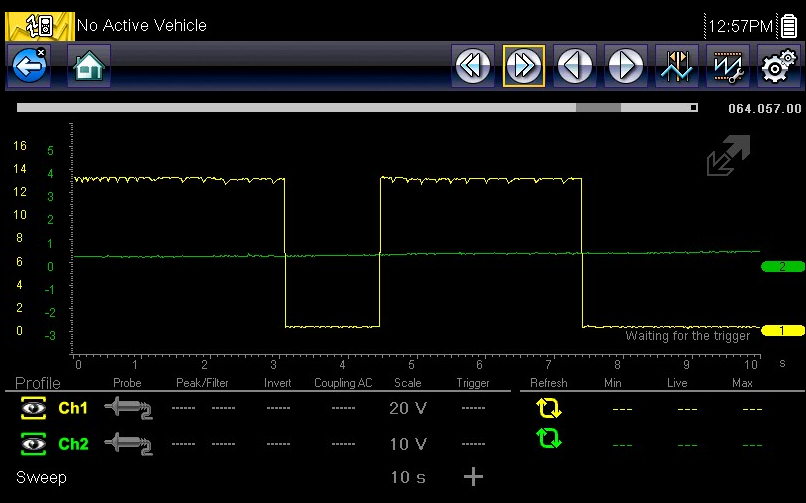

With the KOEO Incandescent test light from B+ to control wire, plugged in or unplugged, the test light lit. I disconnected the ECM, unplugged solenoid, with KOEO test light did NOT light. At the same time checked control side voltage and it was 13 volts. Put the ECM back in and repeated test and the test light lit and O volts on the control side.
In my first post the one of the conditions for the solenoid to energize and block vacuum is with a stopped engine. Does this mean with just the key on or when you turn off the engine?
9 years 11 months ago - 9 years 11 months ago #2172 by Noah
So I tried reading this though at work and it just wasn't happening. Sorry, I wanted to get in on this sooner.
I would try a less technical approach on this one. One of the tests all data has you perform is with KOEO, to disconnect and reconnect the valve. You should be able to hear the operation of the valve as you do so. This tells me that the pcm is supposed to be grounding the solenoid with just the key on.
So it seems like the circuit is intact
I'm not sure of the location or connections to the valve, but if possible, I would disconnect both vacuum hoses from the solenoid and try to blow each way through the valve while disconnecting and reconnecting the solenoid. If you can always blow air through it both ways (even a little) while activating and deactivating the solenoid, she's junk. I think that's what you're going to find based on the fact that you observed vacuum on that line while at idle.
The system appears to monitor flow with a thermistor, I suspect it's reading higher than expected temperature at idle due to the valve hanging open (mechanically), hence the P0400.
Did you do a ground to ground volt drop measurement on the control wire? I apologize if you did and I missed it.
Basically put your negative lead on the negative terminal of the battery and measure voltage on the ground side of the solenoid circuit with the circuit activated. KOEO should be fine for this test based on the description I have from all data.
I'm not implying that you don't know how to do a volt drop test, just putting it out there for anyone reading along.
You could also manually energize it with a power probe or jumper wire with it disconnected from the circuit now that you know which pin is power and which is ground (which I don't think is critical in this case anyway, but better safe than sorry), and then try blowing through it both ways, on and off.

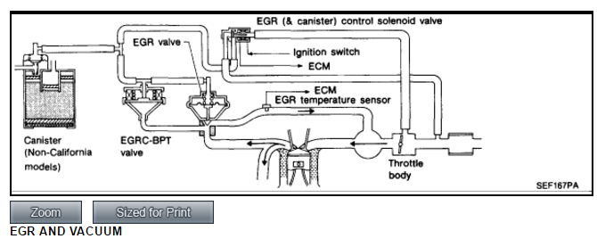

9 years 11 months ago #2181 by Noah
I think any vacuum is too much. It may be allowing just enough egr gas through to be monitored at idle.
You could prove it by checking fuel trim at idle. I'd expect slightly positive trims at idle, maybe a pending lean code. That's kind of mouse hunting with a machine gun though.
I'd try to stay focused on what we do know. That is that at idle, no vacuum should be present to the egr valve. We also know the valve opens based on the increased vacuum you noted, which verifies circuit integrity. We also know the egr passages are clear and the valve functions based on your manual bypass (good move BTW). That doesn't leave a whole lot to be setting your p0400. Either there's egr flow when there shouldn't be (which I think is the case), not enough flow when there should be, or a lying egr temperature sensor.
The solenoid does all the work and is exposed to the harshest conditions, so that puts it at the top of the suspects list in my book. Plus it's letting vacuum through when there should be none. I would make sure it seals and flows outside of the circuit before getting tangled up in the logic of the circuity.

The car was already warm when I connected my meter to the EGR Temp sensor signal wire. It was 2.6 volts and the voltage stayed the same when I revved the engine to a steady 2500 rpm and a couple of snap throttles. I manually added vacuum to the EGR valve just enough to make the engine run rough. It was only then the Temp sensor was dropping slowly to 1.7 volts. I release the vacuum because I didn't want the engine to run the way it was for extended period of time. At least the Temp sensor is responding to the exhaust gas.
I disconnected the three hoses to the EGR solenoid and ran compress air to the port A fitting to check air passage ways. Did the test as described and found that with the solenoid energized ports A and B had good flow but with no power to solenoid ports A and C air flow was a little weaker. The weaker side goes to the EGR and BPT valves. Maybe the vacuum is not strong enough to open the EGR valve. Connected the hoses back together and put my fingers under the valve and can feel some of the diaphragm moving as I throttle the engine but doing this for the first time I cant really judge a good from weak diaphragm movement.I know when I press up hard enough I can make the engine stall.

9 years 9 months ago - 9 years 9 months ago #3320 by Charles Acosta
Replied by Charles Acosta on topic [FIXED]P0400 Code and My First DIY Troubleshooting
My friend brought his car back to me and says his MIL light didn't come back on. So it turns out the two of the three vacuum hoses I found routed wrong to the EGR solenoid was the problem. To verify I took the opportunity to run one wire each from the EGR solenoid control wire and EGT temp sensor signal wire to my Vantage Ultra to look at data while I drove his car. Once I picked up speed the the solenoid opened {voltage at control wire} allowing vacuum to the EGR and the temp sensor was dropping voltage indicating exhaust gases passing to the intake.
Last edit: 9 years 9 months ago by Charles Acosta.
9 years 9 months ago #3322 by Tyler
Hey, nice fix sir! :woohoo: Very glad to hear this one got resolved.
So, had someone worked on the EGR solenoid before you? Or, were the hoses themselves faulty?
  • Charles Acosta
  • Charles Acosta's Avatar Topic Author
9 years 9 months ago - 9 years 9 months ago #3323 by Charles Acosta
I think someone was there because I also noticed the control wire was pierced. The hoses were good but routed wrong. The valve was getting vacuum during idle which explains 2.5 volts at the temp sensor when i was troubleshooting. Now in the first capture it was 3.5 volts. I believe this was a high flow code. Thanks Tyler and Noah for your help.
