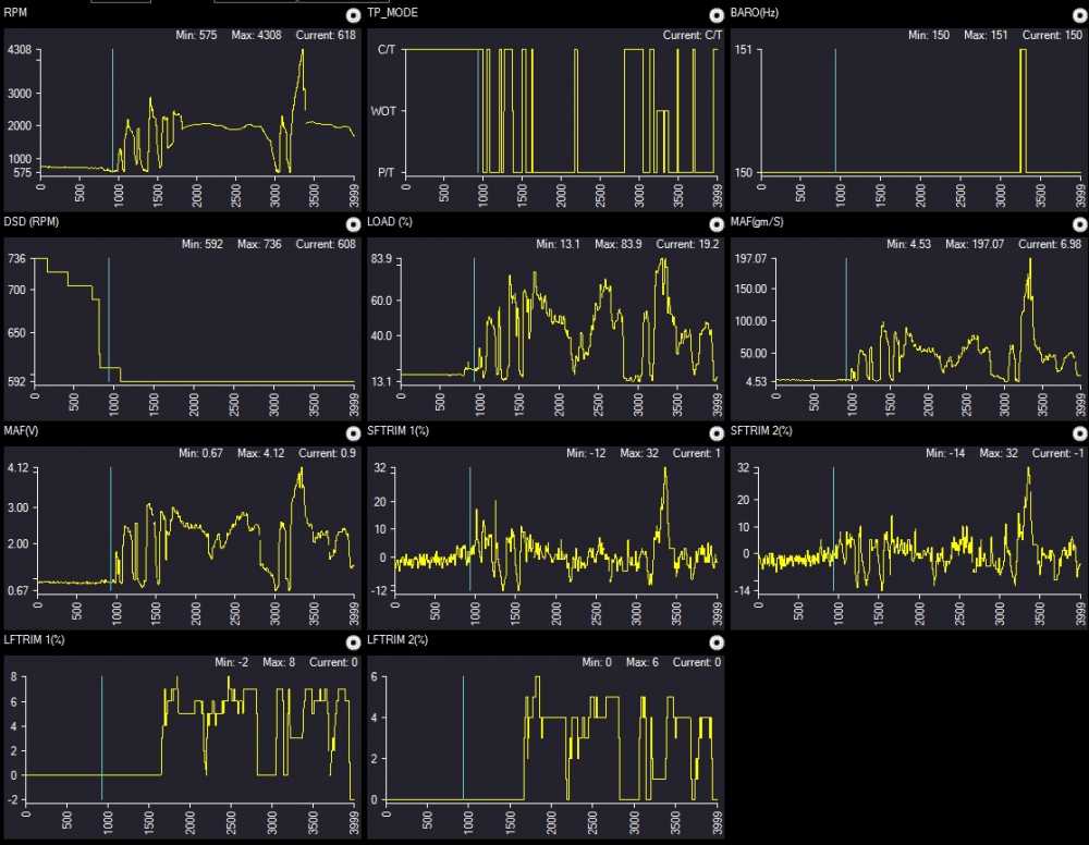

2004 f150 5.4 liter p0172 p0175 was created by cheryl hartkorn
checked maf g/s at idle had 5.5ish baro reads 150hz. im in ohio. checked fuel pressure pid on scanner read 40psi. checked for stuck open purge valve. the numbers go rich at idle but they look fine driving normally. any other ideas

cheryl hartkorn wrote: checked maf g/s at idle had 5.5ish baro reads 150hz. im in ohio. checked fuel pressure pid on scanner read 40psi. checked for stuck open purge valve. the numbers go rich at idle but they look fine driving normally. any other ideas
150Hz, eh? Did some quick Google work, says Ohio is anywhere from 500 to 1,500 ft. 150Hz is more consistent with something around 3000 ft? The BARO calculation isn't perfect, of course, but maybe something there?
40 PSI fuel pressure sounds right for this truck. Any other symptoms, or just the "money light"? Just curious, how far negative are the trims at idle?
Thought for a second about an intake restriction, but you'd think that would cause the fuel trims to worsen off idle... I seem to remember a PCM reflash out there for this code and this engine on Econoline's, maybe it applies to this truck, too?

tyler both banks were around -25 for short term. not really any other symptoms.
9 years 11 months ago - 9 years 11 months ago #2296 by Tyler
Replied by Tyler on topic 2004 f150 5.4 liter p0172 p0175
cheryl hartkorn wrote: tyler both banks were around -25 for short term. not really any other symptoms.
Gotcha. I had a glance at some data I got off an '05 F-150 that I looked at recently, just to have something to compare to.
www.scanshare.io/share/LSMwrX9cbEy44uGhyucV4Q
I did notice that the MAF g/s is higher on my capture than on yours, around 7 g/s compared to 5.5 g/s. Thought I was onto something, but I don't think that matches a rich condition? Your MAF would have to be over-reporting to produce a rich condition, rather than under-reporting. Oh well :(

I thought the newer ones did? The 5.4L in that scan data capture I posted did, anyway. :huh:
Is this the intake style where the throttle body sits horizontally, with the flat air filter that gets inserted into the intake tube on a plastic carrier? I've seen missing or damaged air filters cause rich codes on those designs. One of those cases when the filter is required to create laminar air flow over the sensor.
