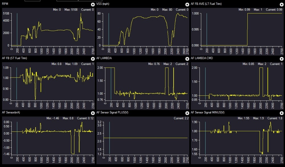

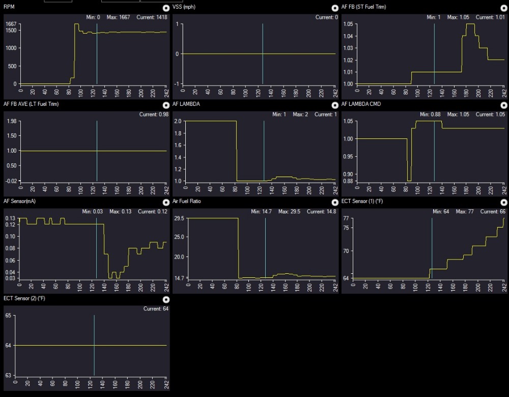

I dug up a comparable CR-V on ScanShare.io. The data shows the sensor current reading at zero or very close to it KOEO.
www.scanshare.io/share/Lu2V8lwLqE6LamAHEKTdjg#0,1,2,3,4,5,6
Some others I found in my files. Both 2008 (closest I could find quickly). Both show a very near zero reading KOEO or cold sensor.
Again, I'd be interested to know if that -127mA reading goes away KOEO with the sensor unplugged.
Weycraze's suggestion to lean and richen the mixture is a good one. If all else fails, we can test the signal wires for shorts to ground with an ohm meter. It's a hassle, but I can't think of much else that'd cause this.
