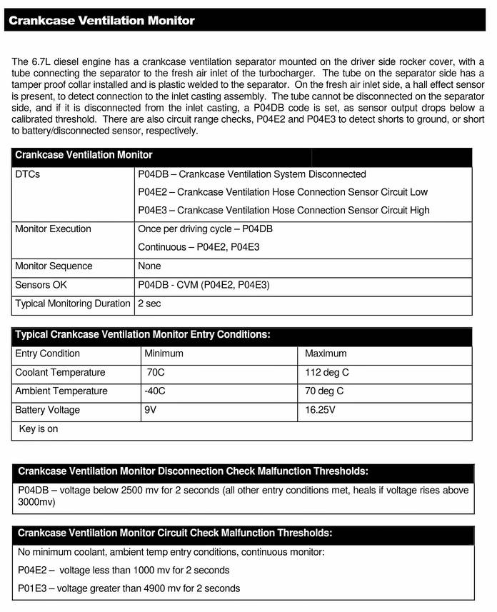

10 years 3 months ago - 10 years 3 months ago #298 by Tyler
Replied by Tyler on topic P04DB00
Found this on iATN for the code provided. Looks like good info, assuming this IS a Ford we're talking about.
They added a hall effect sensor just to make sure a breather hose was connected... Wow.

10 years 3 months ago #301 by Noah
Replied by Noah on topic P04DB00
Google shows the part number as a Chrysler/Fiat part...

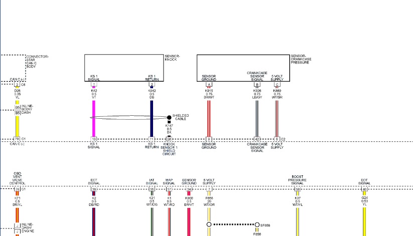

There's not a whole lot of information on this vehicle, but I did manage to find some wiring diagrams at www.bbbind.com/tech_database.html
I downloaded all of them for the 2015 Dodge Dart Aero 1.4L Turbo
In the Wiring diagram section under Engine - Fuel Control System - Intake Air System, last rectangle on the top right (Sensor - Crankcase Pressure) of that section is what I think they replaced. The three wires match in color to the one in this schematic with a 5V reference, sensor signal and ground. I don't have much faith in these techs at this dealership. Before I would replace that sensor I would have checked those 3 wires and checked the waveform of the sensor signal wire against a known good one. They replaced it and it didn't fix the problem. They took out the K&N air filter that had been in it for 8,000 + miles and put a new Mopar filter in it and gave it back to her to drive yesterday. She drove it into work and when she started it up to come home, engine lamp illuminated again. As I type this she is on her way into the dealer again with her car. These newer vehicles are getting so complicated it's hard to fix 'em anymore. I told her when she bought it she'd be getting to know the dealer and now I think they'll be glad to get it fixed and not have to see her again (I hope). I don't really want to work on it unless I really have to.

10 years 3 months ago #356 by Tyler
Nice find on the BBB Industries site, johnbkobb. I've had trouble finding diagrams for newer model year vehicles, pleasantly surprised to find this vehicle in there.
Posting this image for anyone else following along:
Given how quickly the code resets, I'm wondering if it's a hard fault that just takes time to code for... Also, I wonder how sensitive this sensor is? Thinking about it's potential for piston ring/lower end diagnostics.
