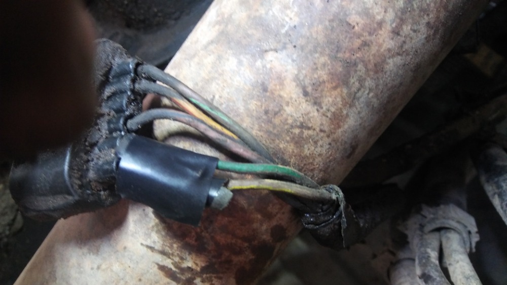

2002 dodge ram 1500 5.9l:
I have a no-start; no com. at data link; replaced cam and crank sensor; I have good ground; 5v ref. Is 5.2 volts; all fuses and replays are working; I only have 1 power source at transmission relay (pin 30), I checked for second voltage supply to relay with key on and cranking engine but no second voltage supply to relay.
I did find transmission range sensor (park/neutral) bare wire rapped are another bare wire.
Any suggestions?

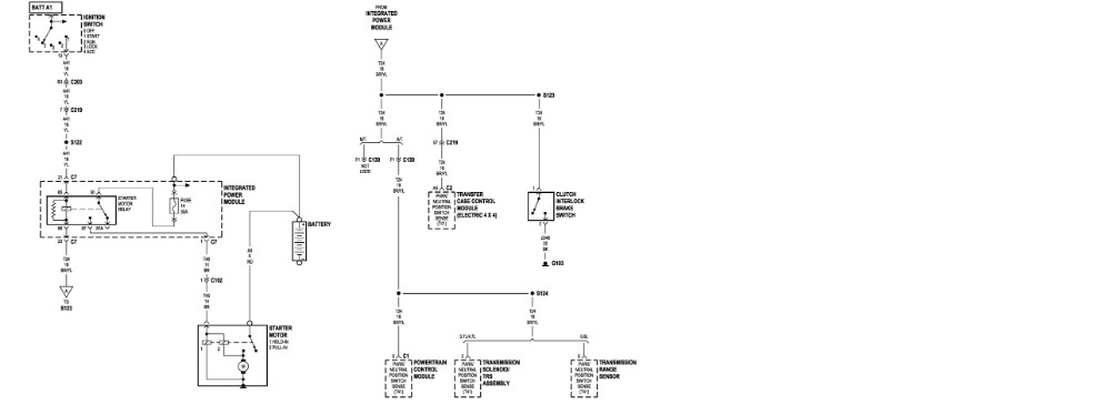

  • chief eaglebear
  • chief eaglebear's Avatar
7 years 6 months ago #28555 by chief eaglebear
Replied by chief eaglebear on topic 5v ref
is there power at dlc

maybe monitor crank signal at computer the fact that it is intermittent might be an ignition switch but with no fuel pressure and no spark leads me to believe your crank signal is cutting out somehow I would go through crank and cam circuits thouroughly make sure signal is getting to computer also we must determine what module is in charge during cranking and which one is in charge during run

I separated the 2 wires that were touching but I still don't get a signal to the switch wire, brown yellow wire
  • Ernrod
  • Ernrod's Avatar Topic Author
7 years 6 months ago #28609 by Ernrod
Replied by Ernrod on topic 5v ref
Looks like those 2 wires have been touching for some time. I'm thinking those wires may have shorted the signal from the pcm (Brown/yellow). Or caused a open somewhere

If the transmission range sensor sends a signal to pick would that be sent through the brown/yellow wire?
  • Ernrod
7 years 6 months ago #28611 by Ernrod
I'm assuming the transmission range sensor is bad, because I get no signal during cranking

Should I have 2 powers at transmission relay?

I'm still stuck on the transmission relay, park/neutral switch. I only have one power feed at the relay, with key on and cranking. I checked for signal at computer (pin 6 brn/yel) I get no signal on cranking.
I placed the truck in neutral and received a signal at Brn/yel wire but not in park. The signal in neutral is intermittent.

What I discovered, I tested the "engine control relay" and I have the 2 power sources but during cranking I'm not getting voltage at pin 87 from pin 30.
Do I have a bad ground or a shorted 02 sensor or injector? Which share pin 87
