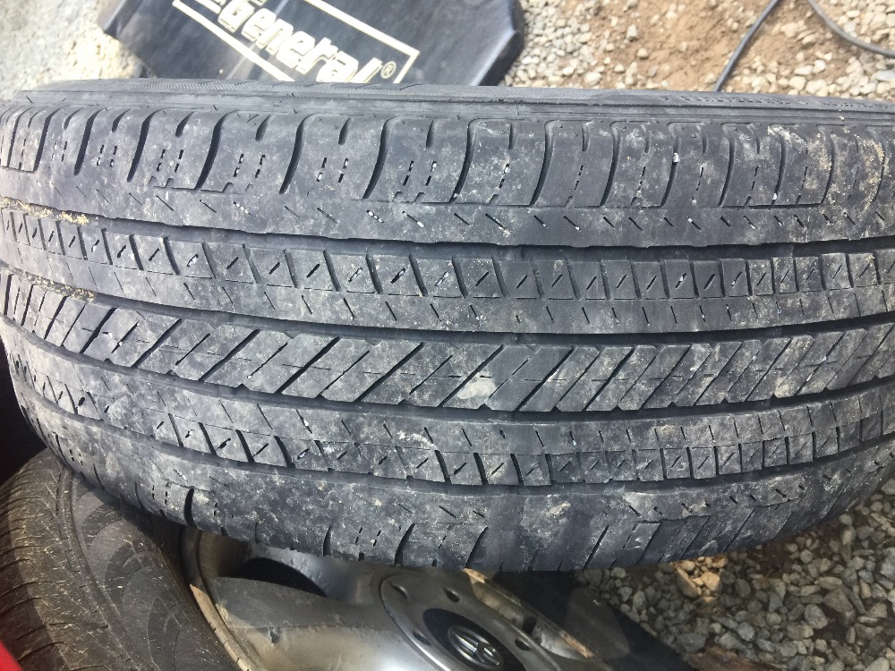

Finally had a chance to pull the wheel and look at this car. Yes, it does have ABS so I was able to order with confidence the correct parts. Interestingly, I noticed this zig zag wear pattern all over the tire. Wow, I have seen scalloping before, but the wear regions extend from the deep scallops on the inter tread, to all the way across the tire. Am I correct to assume this is a result of the bad bearing? (See pic) In any case my son is going to need a new tire...
7 years 3 months ago #32423 by Tyler
Replied by Tyler on topic 2005 Ford Taurus SEL (DOHC) 4-wheel ABS?
I usually see that associated with blown shocks/struts, or severe lack of tire rotation. As in, the new tire went on and never got rotated in 30K miles.
Bearings usually don't result in tire wear unless they're excessively loose, causing negative camber.

7 years 3 months ago #32433 by Tyler
No problem! I'd be tempted to have those tires replaced first, or while you're doing other work. They look pretty thin on tread where the cupping was worst.
The wheel bearing test I've used for years has been to lift the car and spin the wheel while keeping one hand on the coil spring. A truly noisy bearing will resonate through the coil spring. With this method, bad bearings are obvious compared to good ones.

7 years 3 months ago #32439 by tim.smith1
Replied by tim.smith1 on topic 2005 Ford Taurus SEL (DOHC) 4-wheel ABS?
those tires have to be making a rumbling noise that can be misinterpreted as a wheel bearing and i agree check the shocks/struts on the rear if a problem is not found i would check the alignment i have seen that cause wearing on just the inside but the scalloping seems to be from shocks/struts.
7 years 3 months ago #32452 by Noah
Replied by Noah on topic 2005 Ford Taurus SEL (DOHC) 4-wheel ABS?
Another vote for rear shocks. All the Taurus sedans need them, lol

7 years 3 months ago - 7 years 3 months ago #32460 by popoften
Replied by popoften on topic 2005 Ford Taurus SEL (DOHC) 4-wheel ABS?
Yes, the noise is almost deafening.
How can I test the shocks? I have heard conflicting advice about the bounce test. Some say it is useless on modern cars, others disagree. Some say you really can’t tell as a diyer, you need special equipment.
What say ye?

7 years 3 months ago - 7 years 3 months ago #32461 by Noah
Honestly, the wear pattern on the tires tells the story. That's all the evidence I need to condemn the struts.
Sometimes you can judge by bouncing the car. Some say they should be changed every 50k regardless. Sometimes you can just look at the car say "wow, the tire is stuffed all the way up in the wheel well!" If the cartridge is sticky, oily, covered in dirt then it's been leaking and needs to be changed. You can inspect the coil spring for a broken section. If you follow the spiral of the spring with your hand, it should end in a recess designed to hold the spring at the bottom of the strut. If the end of the spring is sharp or jagged then it's broken.
For what it's worth I've seen more broken rear springs on Taurus struts than probably just about anything. If it was my car I would change the strut assembly including the springs and not just the cartridges.

7 years 3 months ago #32467 by popoften
