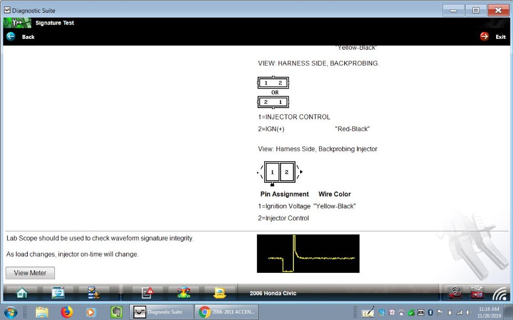

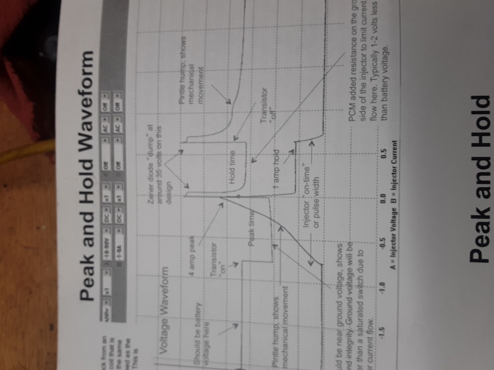

6 years 11 months ago - 6 years 11 months ago #35153 by Noah
Replied by Noah on topic Civic elusive misfire
That looks kind of like a peak and hold injector waveform.
I don't remember how to access the e-book, so a picture of the hard copy will have to do:
Did you repeat that test on a cylinder that is not reporting misfires?
Yours looks like it's being pulled fully to ground for the second half of the pattern while the examine does not.

6 years 11 months ago #35163 by Noah
All Data doesn't specify, but if the Snap On troubleshooter is to be believed, then it doesn't look like it would be a peak and hold type. It's not always correct though. I am curious to see how a non misfiring cylinder's injector behaves under the same conditions. It would be cool to see them both at the same time if you've got more than one channel

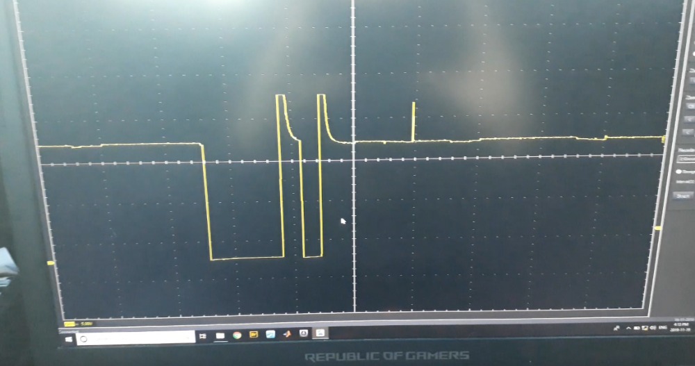

Update 20 Nov 2019
video of Cyl3 and Cyl4 injector control wires.
Misfire condition appears only on Cyl3 at about 1900 rpm and light throttle application. At idle it disappears. At more open throttle it disappears. Can anyone help identify the cause of this weird waveform?
6 years 11 months ago #35180 by Noah
Wow, that's pretty cool. Nice capture.
I would scope the cam and crank sensors during that event.
I don't know if the PCM could "double tap" that injector on purpose if it was pulling too much amperage, but I would also current ramp that injector at idle and during that event and compare that to a known good cylinder under the same conditions.

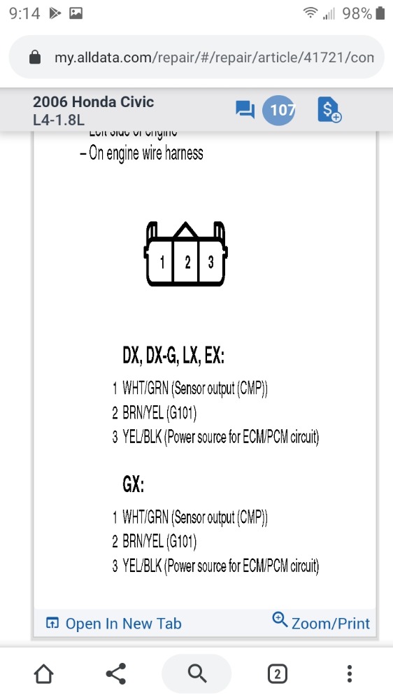

  • hoddy2000
  • hoddy2000's Avatar Topic Author
6 years 11 months ago - 6 years 11 months ago #35244 by hoddy2000
Replied by hoddy2000 on topic Civic elusive misfire
From what I can see from other Hondas online, the CMP signal shouldn't look like this at all it should be a form of square wave. Am I right thinking the sensor has an internal failure?
It's a 3 wire sensor. Signal to the ECU is white/green. The ground wire seems good I checked voltage and resistance. the other wire YEL/BLK is from the Main relay. I capture battery voltage there. Maybe it should be 5 volts I don't know.

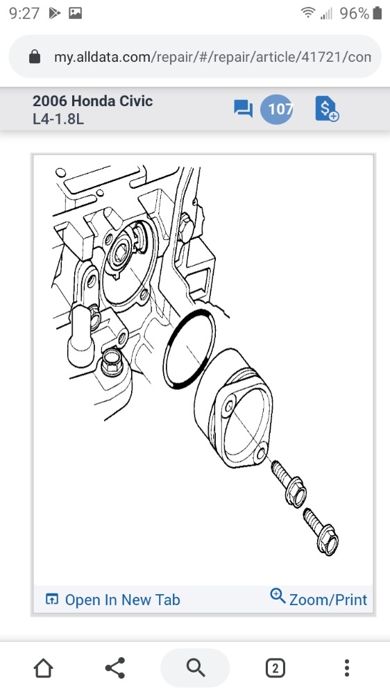

6 years 11 months ago - 6 years 11 months ago #35276 by Noah
Thank you for clearing that up, again, sorry for the confusion on my part.
The yellow trace certainly does not look like what the cam sensor should be producing.
It should be a square wave as you had mentioned.
As far as testing the sensor, I believe you said you tested and found power and ground at the sensor all ready.
That's good. If you're certain you were making good contact on the signal wire during that capture then there's something wrong there.
Before condemning the sensor, I would check the signal wire for a short to ground by disconnecting the sensor and the computer and then ohm the signal wire to ground. Looking for OL mohms.
I see the trace stays around 1-2v on the scope, so I don't think you'll find a short but I would check before replacing the sensor anyway.
You could also yank the end cover and check the tone generator for damage, can but given it location I don't think it would likely be damaged.
I would imagine that with what amounts to no cam sensor signal there would be a trouble code set...
