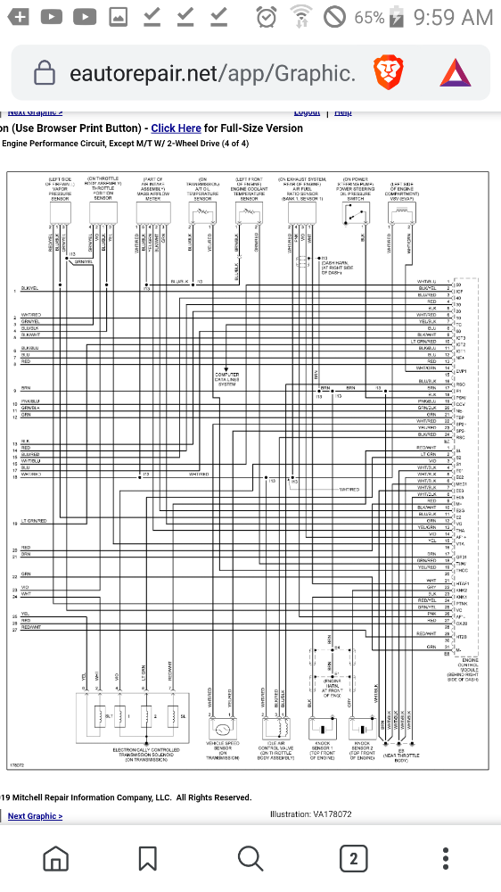

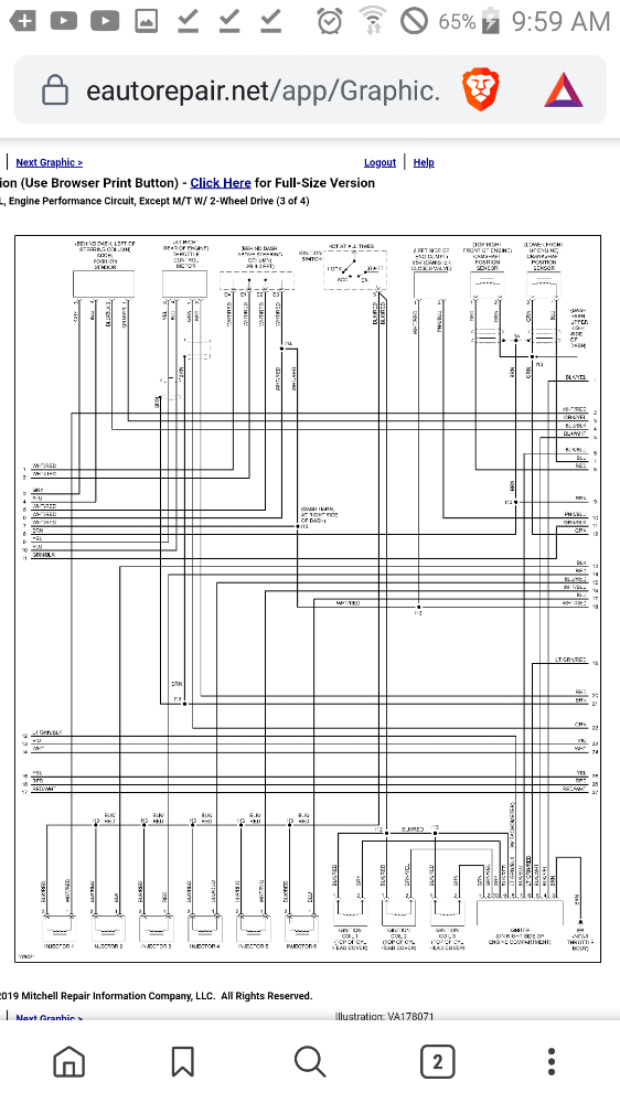

Ah...ok. What I have is an ignitor with a total of 10 wires.
3 IGT wires come into the ignitor from ECU and 3 wires go out of ignitor to the coils. Now please correct me if I'm wrong. The remaining 4 wires are the common wires shared by the 3 IGT wires. The coils don't have ignitors built in, I have just coils. The 4 remaining wires are 12v, 5, ground, & IGF. So if IGT#2 & #3 are pulsing @ 3.9v which in turn fire cylinders 2,3,5,& 6...then possibly those 4 common wires aren't the issues? You've got me thinking now. I performed a pull-up test on IGT1 at ignitor and at ECU. Both places fired corresponding cylinder plugs. (#1&#4) I tested cam/crank sensors (not under load) which were good. I assumed since IGT2 & IGT3 were working that it wasn't an input problem. Could it be a sensor failing under load? Doesn't make sense to me. BUT brother might have messed with or something happened to crank gear and or reluctor ring. ScannerJohn could you tell me if some kind of issue with either, especially the reluctor ring could cause a IGT no signal? Thank you sir for the conversation.

the wiring diagram I have is different from yours. The diagram is small, can you post a full pdf.
A single igniter works the same, the common connections are in the unit. The 3.9v has me concerned. Should be a 5v on off signal. The IGF circuit should be the same. Unplug one coil at a time and see if you get a 5v signal. I'm thinking the 3.9 is pulling down the IGT1 circuit. You used a good known ECM and igniter and still had the same readings, can you check voltage on your friends system and compare readings.

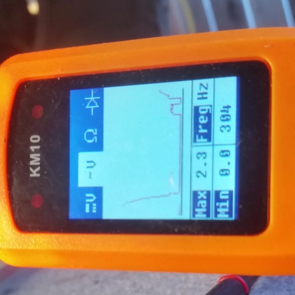

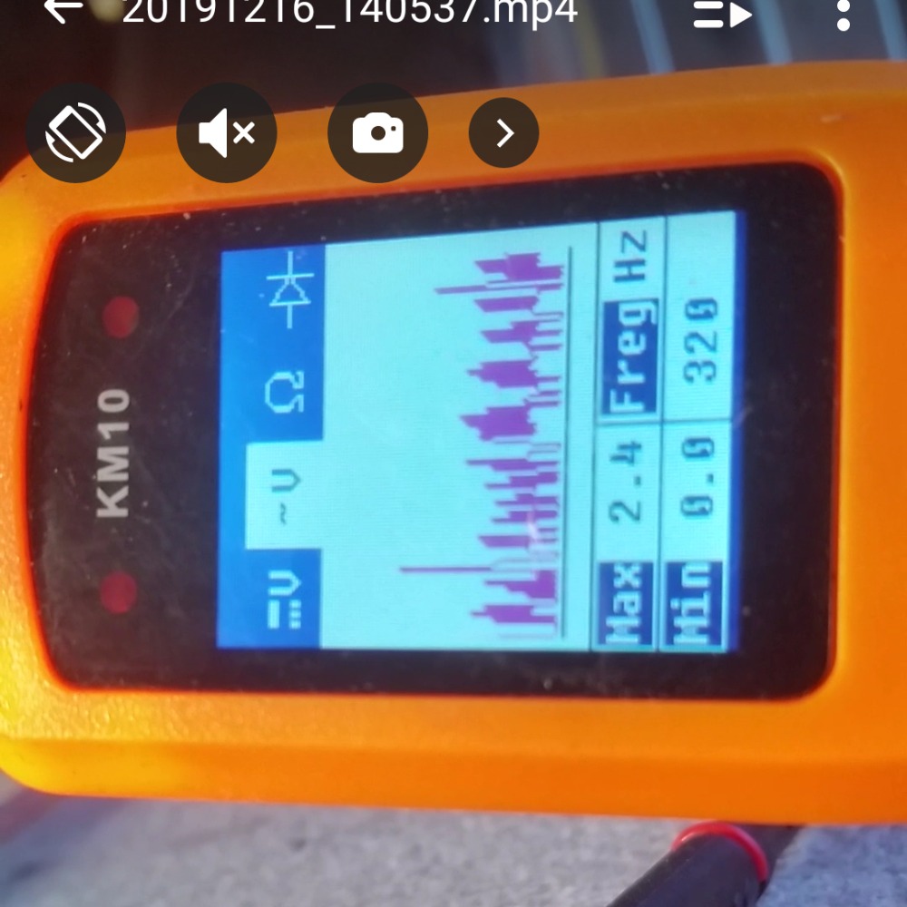

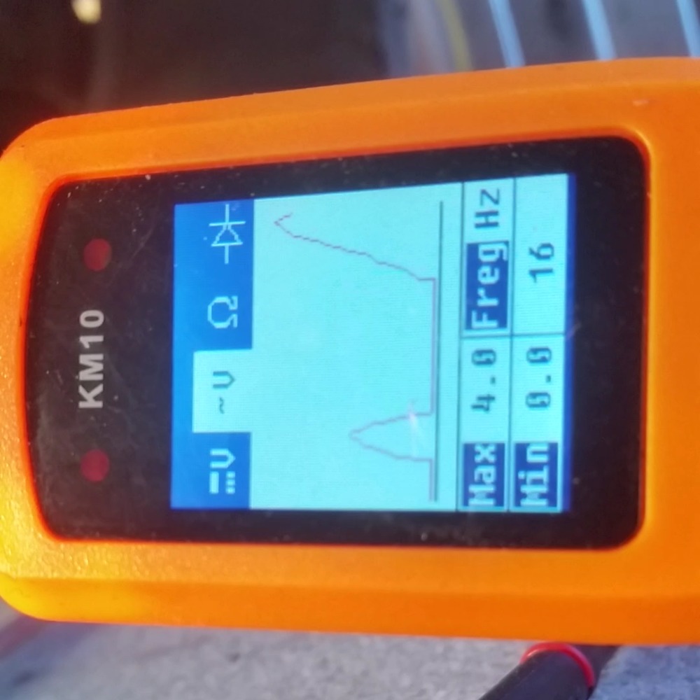

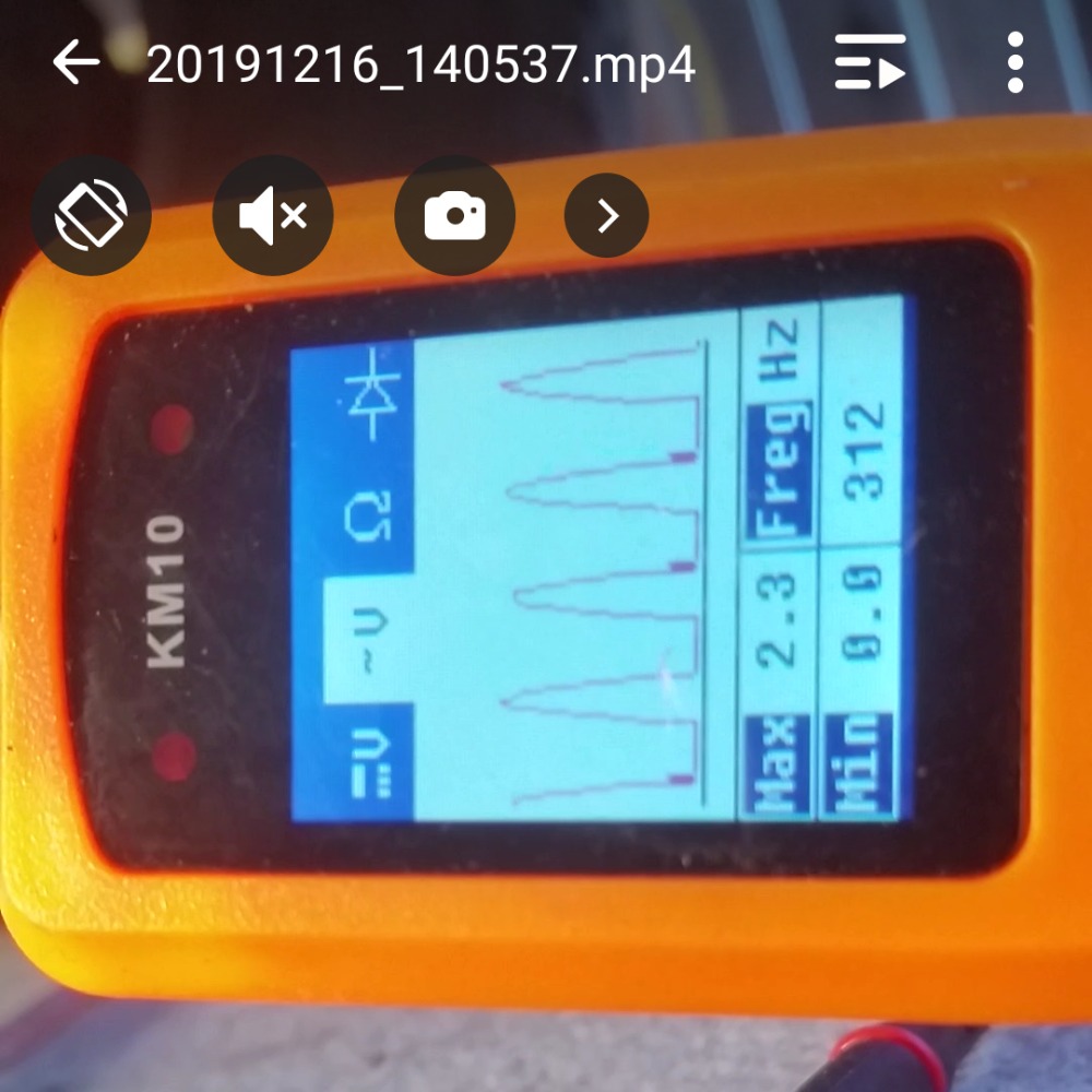

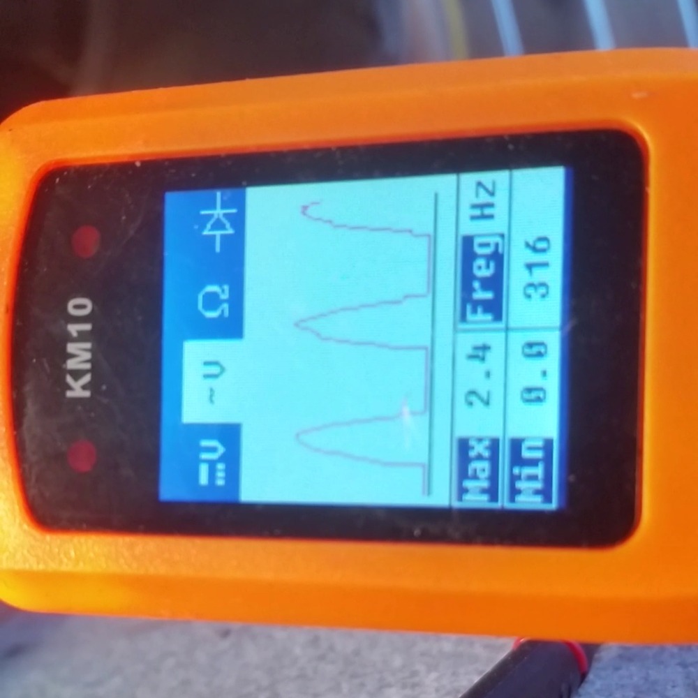

6 years 10 months ago - 6 years 10 months ago #35844 by Otbrecords
Replied by Otbrecords on topic IGT1 The plain and simple fact.
Here you go. I have a Power Probe knockoff, the Kzyee KM10, that performs a max/min showing the wave form a single wave at a time. I can get an idea if the wave is square or not. I also have an oscilloscope with no skills which to use it. I though I might start with the sensors and examine their wave, see if anything jumps out unusual. I going to have to learn how to use that oscilloscope, I can tell that this is where it's all leading. I was wondering how serious this would get, little did I know it would involve an oscilloscope. It might be easier to break down the engine. 3.9v is the right voltage, I'll find the info that talks about it and post it.

Do the tests on page 2 and let me know the results. You have a scope so the waveform on IGT1,2,3 and IGF will tell all. Back probe each pin at ECM. Use 4 channels and set scope to 20msec and 10v.

I performed the whole procedure and of course it led to a bad ECU. This was the very last thing I did and what made me concede to not being able to fix it. I can't fix a computer but the problem is they don't include sensor or wires as part of the testing. Right? Sensor are still a question? If so could you explain how they might be suspect so I can keep an eye out for it. I asked brother and crank gear, the washer behind it, and pulley of course were removed. It's not a procedure that he's extremely familiar with. I don't discount mistakes but problem is I'm not familiar with timing belt replacemen either. I almost wouldn't recognized a mistake just by inspecting it. That's why I ask for a short explanation. On page two, was it the checking for open short? It had no shorting/grounding issues with a good 12v on IGF. I can do it again if there was a particular thing you were looking for or a way that you want me to do it, no problem. A list of things in an order you think I should do them would be helpful. Today I put back together the truck, second ECU will be sent back and installing original. Figure since the problem wasn't computer that the original would be best. I plan to do oscilloscope tomorrow on a fresh vehicle. Thanks

Not looking good to me... check this pdf from your manual. www.markofshame.com/fsm/03_Tacoma/Repair...g2rzfe3/cip0335p.pdf the sensor wave form should be like this.
What I'm looking for is a missing signal. Should have 11 signals the same then the pattern starts over again. If you have a missing or distorted signal, I believe this would be the #1 crank signal for IGT1. This suggest to me that the crank gear may be damaged. This would be consistent with working before timing belt repair and not after.
