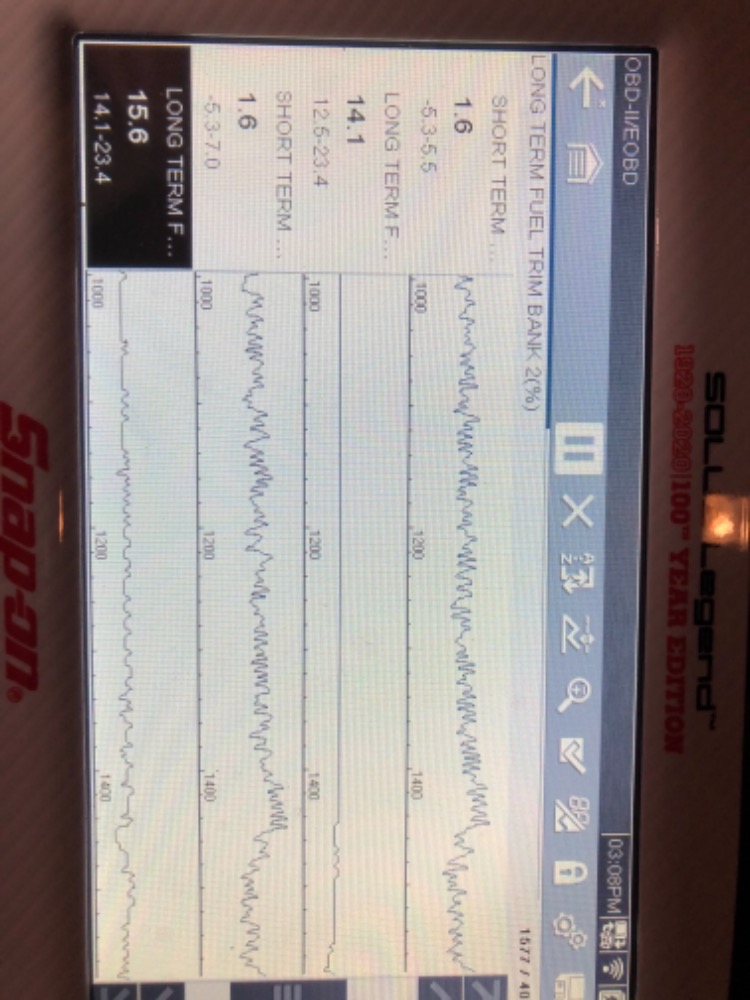

Well I smoke tested the intake today and found a Rubber plug in the Side of the air intake pipe and it was leaking a little so I sealed it and it got a little better but that’s all I found and the MAF g/s reading was 4.0 ish at idle so I’m still at a loose. I didn’t get to do the 3rd gear WOT. They had to take the truck this evening and don’t know when they will bring it back for sure. But I have to be missing some simple test or something I haven’t thought of this lean code is kicking my ***. Incase the pic don’t send theLT fuel trim is around 15 and 15 now

O and ST fuel trim goes negative when I bring up the rpm now like it should I believe not a lot just some.
