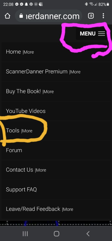

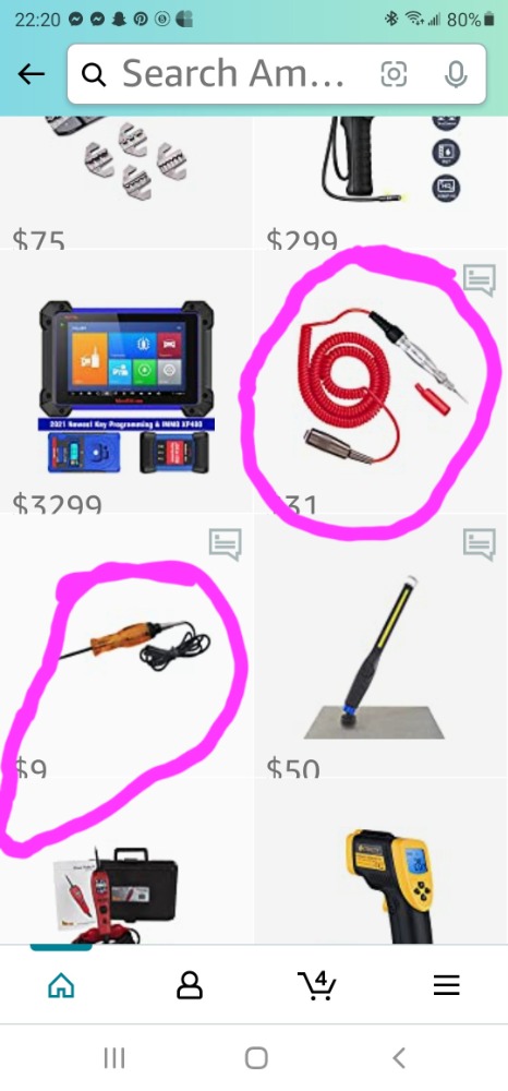

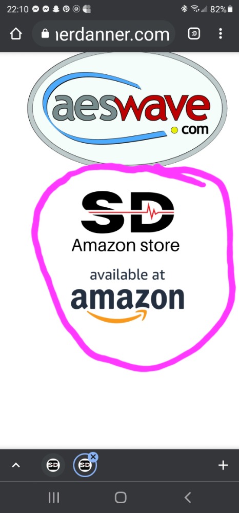

5 years 3 months ago #50488 by Dtnel
Replied by Dtnel on topic I made a very big mistake..
When you're posting a photo from the chrome Browser, mobile version you only need to select go to editor if you don't see the word attachments in black box with red lettering.
I've taken a screenshot to show how I do it from Android. Also don't worry about it "cluttering up thread space" as the saying a pictures worth a thousand words goes great here in this industry.
Even photos of the wiring job work you did & the surrounding area are helpful. Sometimes more is better when it comes to information as it can be helpful in more than one way.
if you have access to Amazon you can click on the links
I'm going to add some photos to show you where to click and find a good or see what good test lights are out there.
 The Lisle test light can be found or similar ones at auto parts stores  I like the OTC one as I have multiple ones in multiple boxes for various types of auto work I hate moving certain tools around box to box or bag to bag so I bought a few and have them in multiple storage locations.
Also in the Amazon store there's clickable links that take you to T-Pins. I swear by T-Pins or sometimes if I don't have one handy I'll break the wiring adapter set out as I have alot of connector heads for various types, sizes, etc  How much you Want to spend on those connectors is limitless, literally! I purchased the KIT from AESwave.com. First 2 items in this link are great for wiring testing especially if you plan on getting into more DIY Auto, helping friends, learning more. Here's the direct link to scannerdanner's page on AESwave.com
www.aeswave.com/cart.php?m=product_list&...tIds=&venID=&stream=
That was cool as I haven't used the new copy, paste function of this web forum since they redid it.
