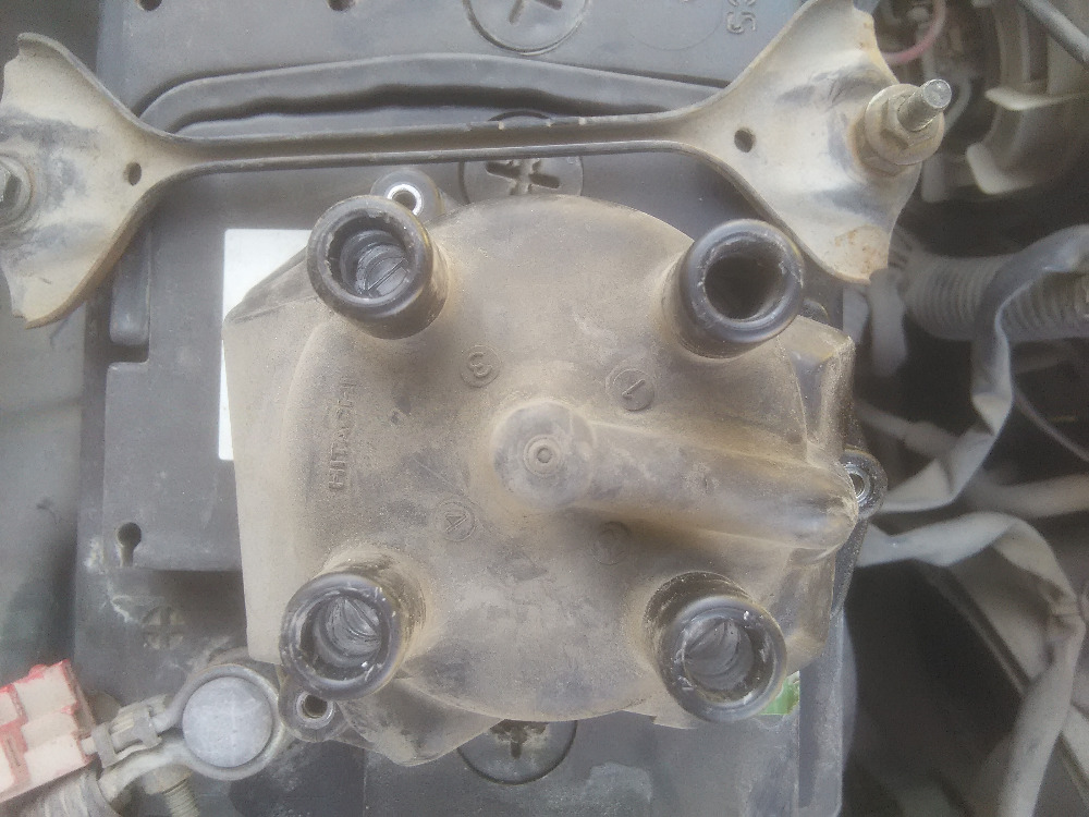

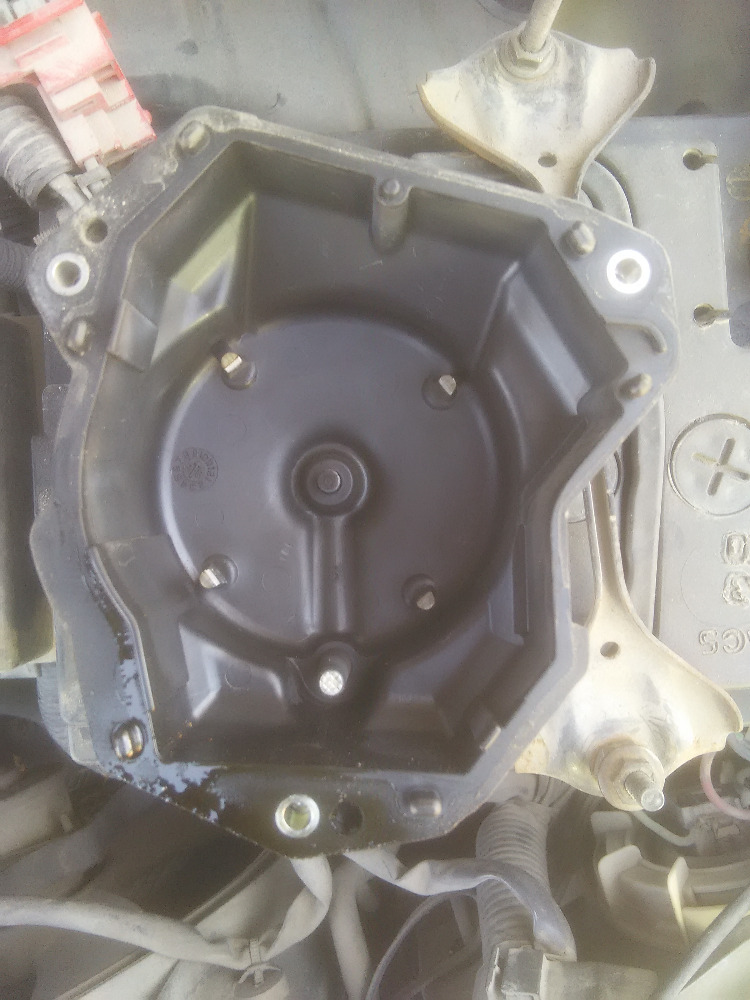

Here are the two views of the cap:
Bottom:
Top:

What you linked to is the 22162-0M300. Mine is the 22162-78C00. Many parts catalogs say they're interchangeable, but looking at pictures of them side by side, they are obviously not compatible. I've run into this type of problem with other Nissan parts as well, like my injectors.
