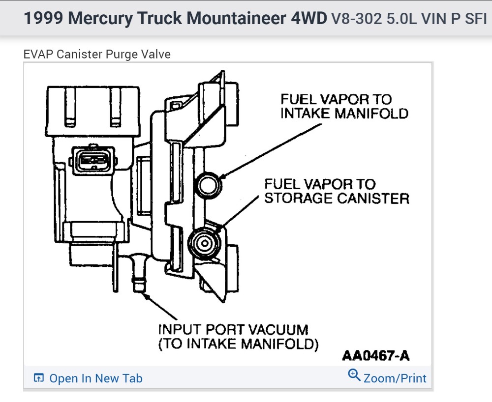

EVAP Purge Valve

EVAP Purge Valve was created by Charles Acosta
4 years 9 months ago #54053
Replied by Tyler on topic EVAP Purge Valve
You know, that's a good question. :blink: I looked over Theory and Operation in SI and couldn't get a good idea.

4 years 9 months ago #54055
by Matt T
Replied by Matt T on topic EVAP Purge Valve
It's a pilot vacuum supply which is switched by the solenoid to operate the main valve. The large round disc the two purge lines go to contains a diaphragm which the pilot vacuum pulls against to open the main valve.
Depending on where the vacuum is sourced from it may also have some influence on controlling purge flow.
