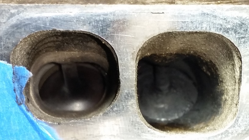

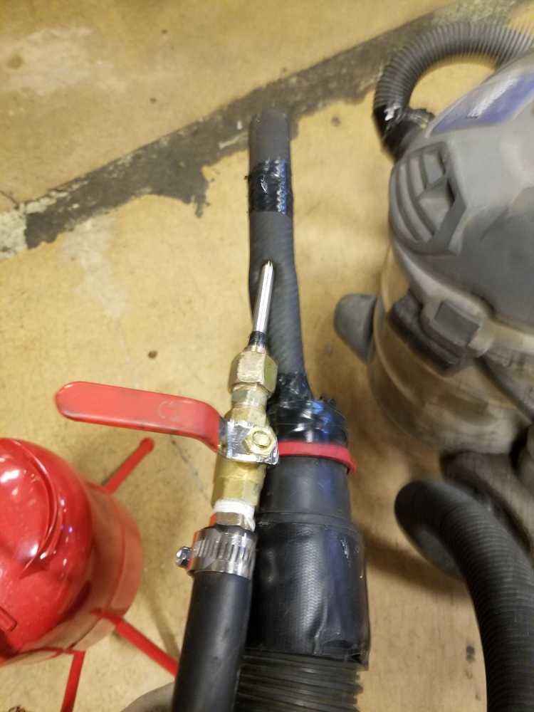

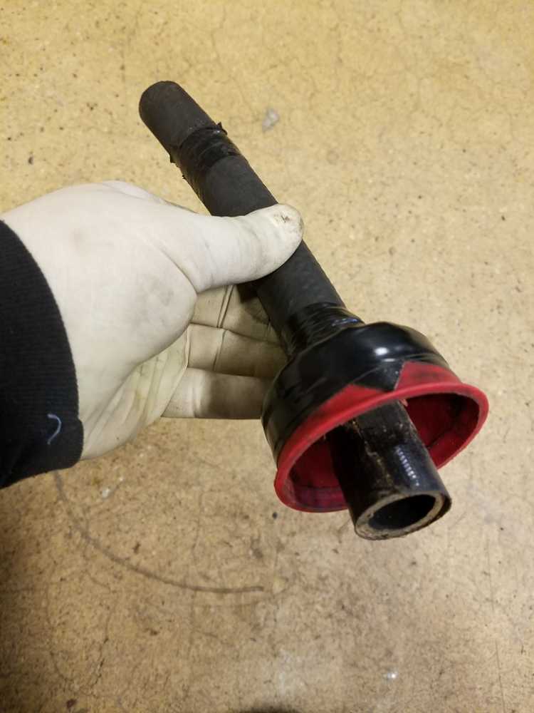

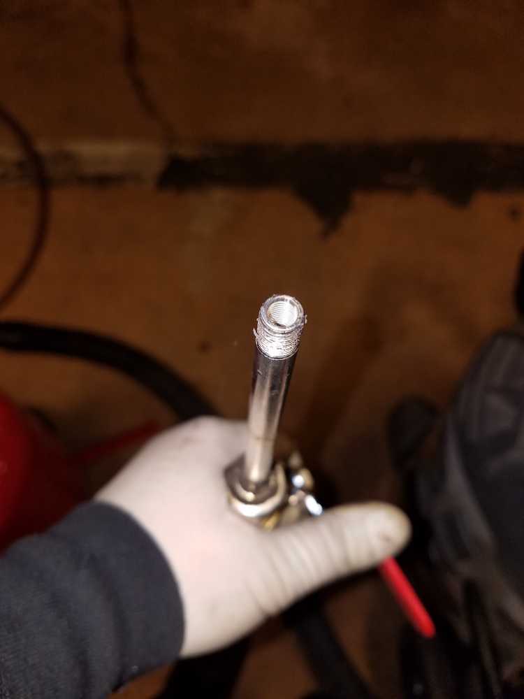

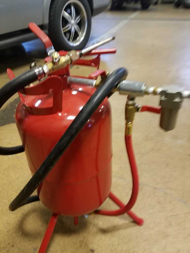

9 years 6 months ago - 9 years 6 months ago #8859 by Ro-longo
Replied by Ro-longo on topic GDI carbon build up
Ok, here is my setup.
First image is of the tank .
Here is the Vacuum hose adaptor
A view of the nozzle made from a long metal valve stem that I drilled out.
A view with everything put together
And this is from the first time I used it on a Mazda 4 cylinder GDI Turbo. The valve on the left if after cleaning and of course the one the right is before using the blaster. I had previously tried to clean the valves by soaking them over night in Seafoam (It didn't do anything but make a mess)

9 years 6 months ago #8860 by Ro-longo
Here are the links for the parts
20 lb. Pressurized Abrasive Blaster
25 lbs. Walnut Shell 24 Grit Fine Abrasive Media
I added a water separator that we had in the shop, without it the nozzle would clog up.
I need to add a pressure regulator to the set up,

That's pretty slick, sir. B) The results speak for themselves!

9 years 6 months ago #8966 by Dylan
Replied by Dylan on topic GDI carbon build up
Holy crap! That result is night and day difference Ro-longo! Thanks for sharing this.
