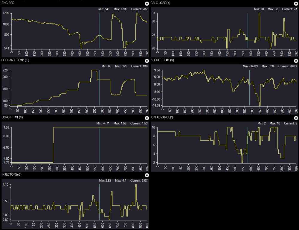

Wanted to get some opinions and thoughts from the community on this one. We're always told to watch IAT and ECT during engine performance diagnostics, as these are part of the 'critical inputs' that the engine computer uses for fuel management. But, how much weight do they actually carry? :huh: How much will they skew things like fuel trims if they're being reported incorrectly?

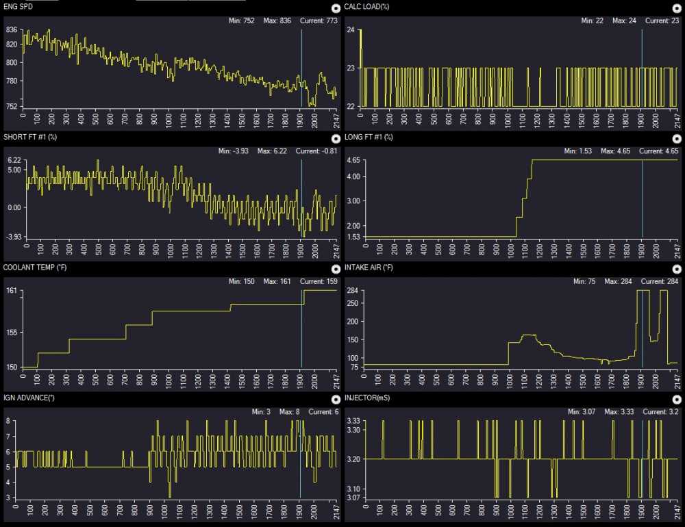

As always, I used the Scion xA as a guinea pig. Starting with the IAT, I installed a variable resistor on the signal wire and started turning the dial:
How much does it matter? Well, at idle, not much! The trims moved a few percentage points back and forth, but overall the car didn't notice much of a difference.

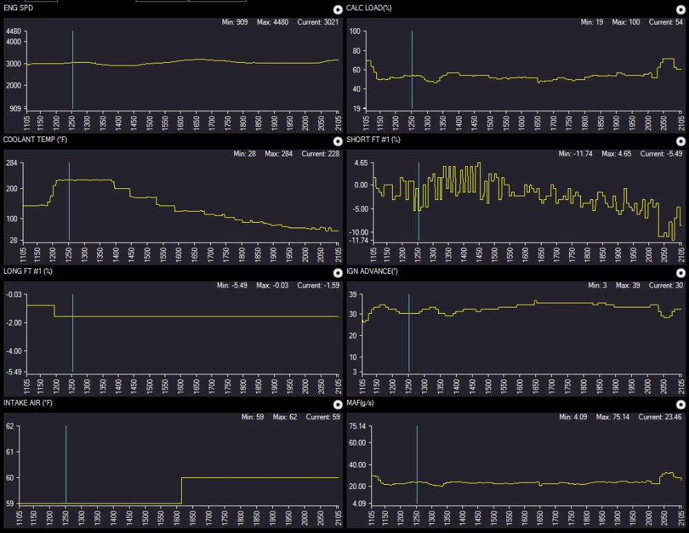

Now for the ECT. This one produced some noticeable changes:
I knew the ECT was important to idle speed, but MAN the engine was really unhappy with the resistor installed. :lol: There's a big dip in short term trims at frame 650, but I believe that's due to the flare in engine speed from spinning the resistor dial too fast. Making small, incremental changes in temperature varied the idle, but never changed fuel trims all that much. Calculated Load didn't notice anything was happening. :blink:

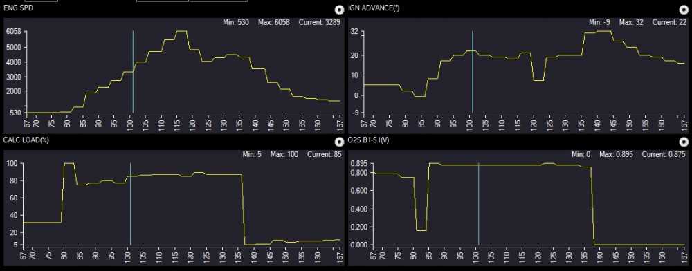

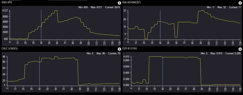

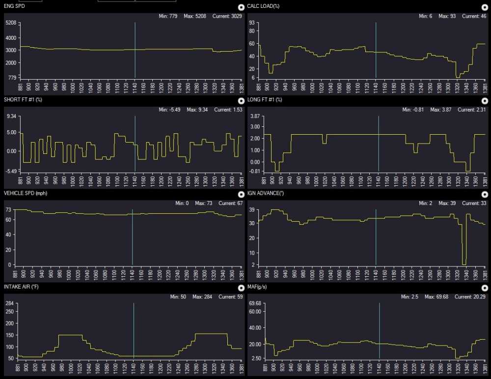

Update! Did some driving testing with a variable resistor installed in place of the IAT. For your consideration:
Cruising at highway speeds.
Varying the IAT around 100 degrees, and the car didn't really seem to notice at all. :silly: MAYBE got the ignition advance to vary a bit?
Then I decided to do some WOT runs. Because of how the Scion data lists are configured in the Modis, I couldn't get IAT and the O2's on the same screen. :angry: The first run had the IAT set at 32 degrees, while the second was set to 150.
Perhaps a few more degrees of ignition advance when set cold? This would go along with what Andy said. The acceleration might have been a bit better, but it was tough to notice. No lack of fuel or change in Load.
Welp, there's a reason I've never changed an IAT for an engine performance problem, and all this testing spells it out. :lol: Maybe a larger displacement engine would notice more? Since I did this experiment, I've stopped looking at IAT during performance diagnostics - save the data stream bandwidth. ;)

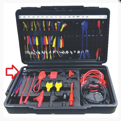

Thanks, sir! It's a part of a test set the shop bought off the Matco truck. VERY similar to the AESWave uTest kit. I have it strung into the cabin via some test drive leads.

After that, I switched the resistor over to the ECT and started monkeying around. I went for a cruise on the highway, and saw this:
Swinging from overheating to below freezing only got me a few points of short term fuel trim change, but little else. Again, more evidence that the thermistors are just along for the ride when driving.

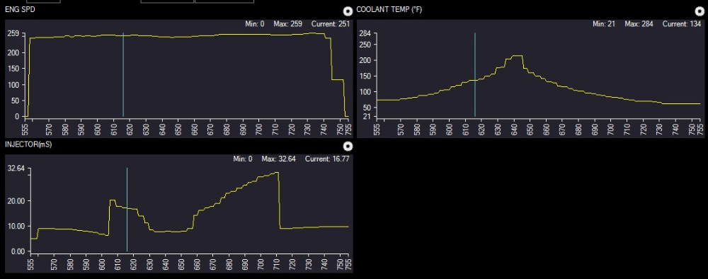

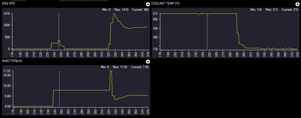

The fun came in when I started playing with injector pulse width during cranking. Just to see how much change I could get, I disconnected the injectors (no driver monitors on this car, so no codes :-)) and did some cranking:
That's what I wanted to see! :cheer: I had always heard that ECT was a big player during cranking, but this confirms it. The next step: If the ECT is off far enough, can I get it to not start? I hooked the injectors back up, turned the resistor to HOT, and cranked it:
Frame 240 is the cranking attempt, when the engine was ACTUALLY at around room temperature. At frame 290, I dialed the temp down to something more reasonable, and got the engine to start.
I wanted to do this kind of testing in light of some recent threads involving cranking pulse width. It's a subject I've never seen covered in the aftermarket. I rarely look at it at all during diagnostics, but maybe I should be? :huh:
