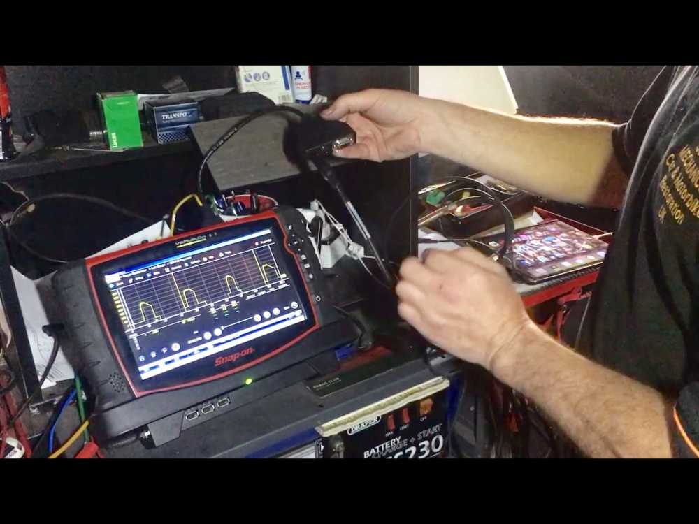

- scott.scottmechanics
10 years 1 month ago - 10 years 1 month ago #2324
by scott.scottmechanics
Replied by scott.scottmechanics on topic DIY Verus / Vantage Pro pressure transducer
Well done paul nice set up and very cheep
Good PDF file keep sharing
Picture of snap on cable at 5 times the price
