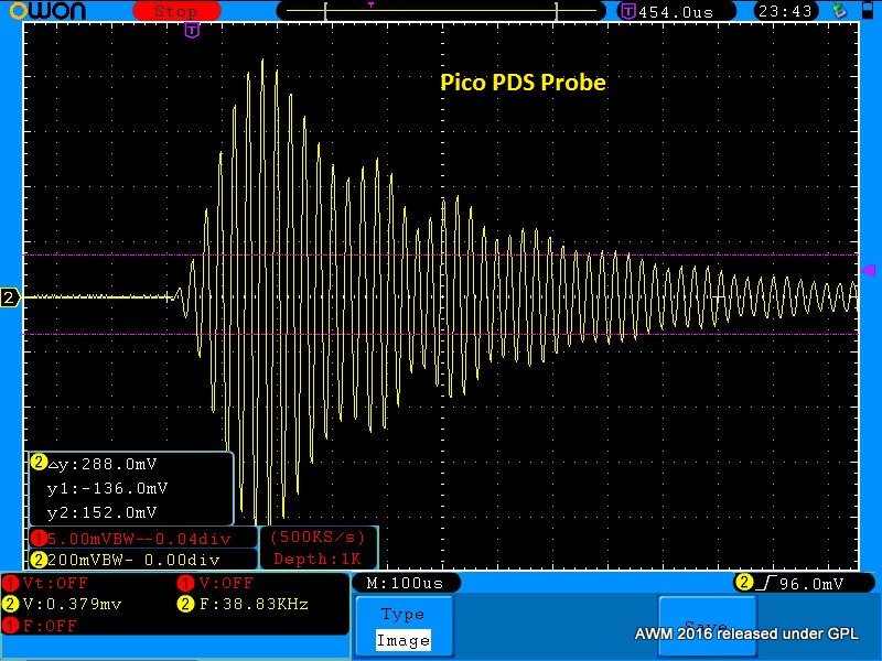

I finally go a chance to try out the Pico Parking Distance Sensor Probe.
This from a late 1990's /early 2,000s Range Rover
almost the same system as used by BMW
The customer complaint system not working emmiting a constant beep when reverse gear was engaged.
Traced turned out to be one faulty (dead) sensor

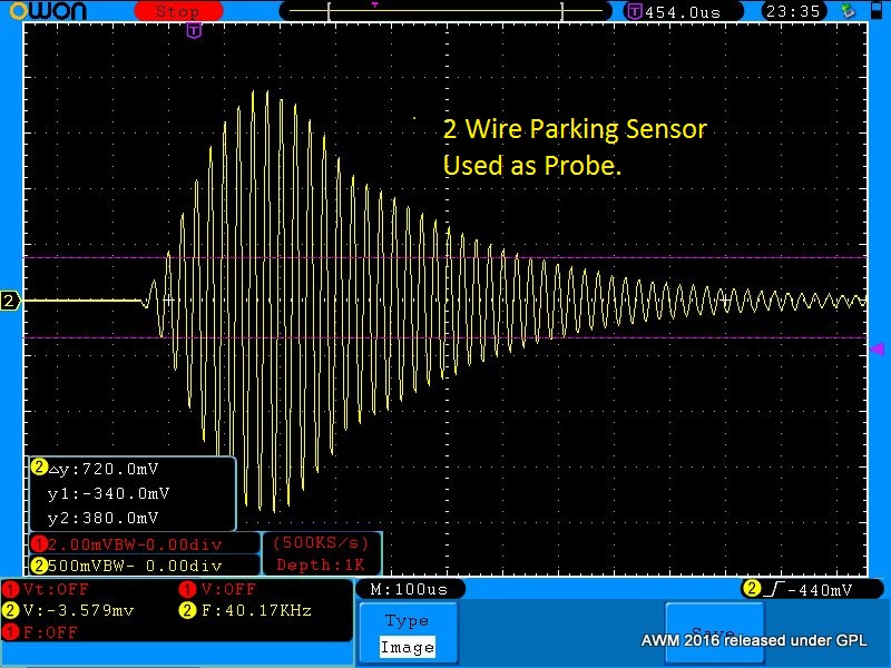

The trace below is from a home build probe which was simply a 2 wire aftermarket parking distance sensor.
Conclusions
(1) The Pico PDS probe made it very easy and quick to find the dead sensor. :) :) :) :) :) :) :) :) :) :)
(2) Scope settings took a bit of tweaking to get right.
(3) The home build probe also works and produces a higher voltage amplitude signal than the Pico PDS probe.
Last edit: 9 years 5 months ago by Andy.MacFadyen.

So Andy, what can we discern from those waveforms? Are those captures of functioning sensors? The Pico seems to show some oscillations that the home made didn't pick out.
