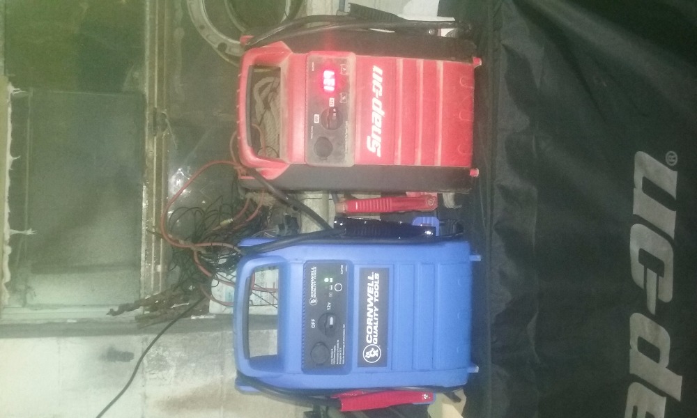

A jumper pack or at least a set of jumper cables in your own car will save you tremendous aggravation!
Sure, they'll call you right up and let you know that the car won't start, but they won't tell you they left the key on all night because "it doesn't run anyway, who cares?"
Hard to diag any complaint with a dead battery. Be prepared for that curve ball.
I currently use a Cornwell jump pack, which is just rebadged Midtronics unit (and is nearly identical to the Snap-On jumper for a fraction of the cost).

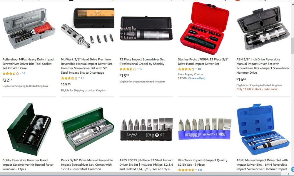

"Hammer Through" aka "Strike-Thru" screwdrivers are the weapon of choice as you can settle the driver into the head of the screw with a couple of suitably judged taps.
For the heavy duty jobs such as brake drum screws
There are a couple of other options the quick and dirty one is use a little grinding paste on the tip to increase friction. there are also commercial products "Ez-Grip" , "Screwgrab" "Gettagrip" and others but I have never tried these.
