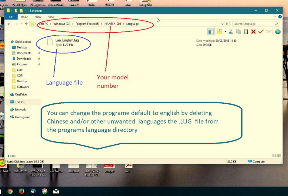

I've also read reviews that the SW installs in Chinese, but can be changed to English, if you can read Chinese.

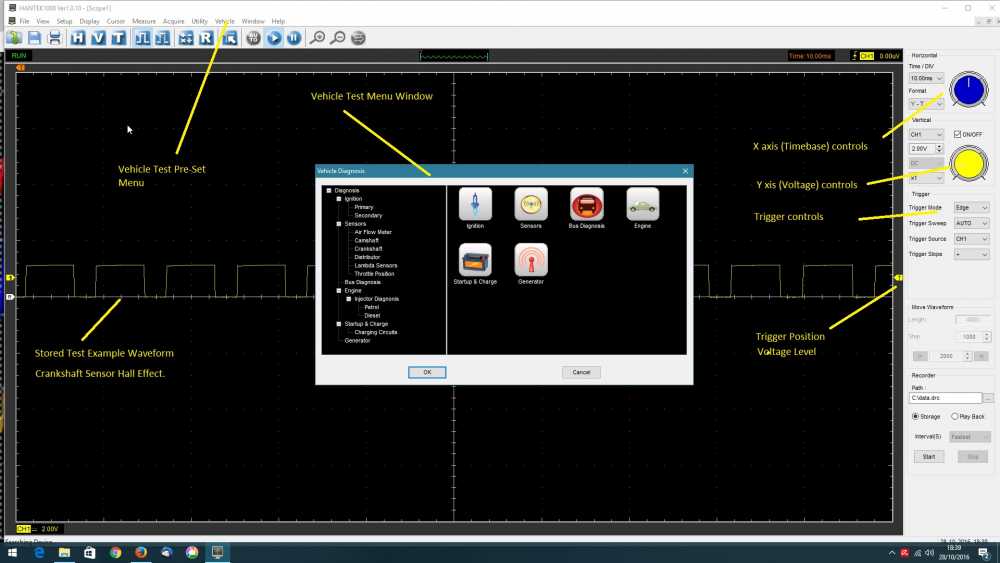

Any of the Hantek scopes offer a lot of bang for your buck
BUT
there are a couple of caveats, the first is Hantek quality control is dubious and the software interface isn't easy to use. Having said that even the cheapest Hantek scope will do most autmotive diagnostics and they usually come packaged a good selection of probes and accessories. If you do buy the scope make sure you get all the probes that were originally bundled with the scope as these cost if bought individually.
The problem with the software interface is the pogrammers have tried make it look like controls on a hardware bench scope and as a result it is very awkward and tiresome to use with a mouse or touch pad.
Added Edit ---- ISTR the Chinese problem it turns out has a very simple solution if the Chinese language file is deleted from the programs directory it defaults to English.

This should help the original info came Enrique Osorio' on his Youtube channel
To switch to English from Chinese : Find the programes directory and delete all the .LUG files except Lan_English.lug (or any western language of your choice).
