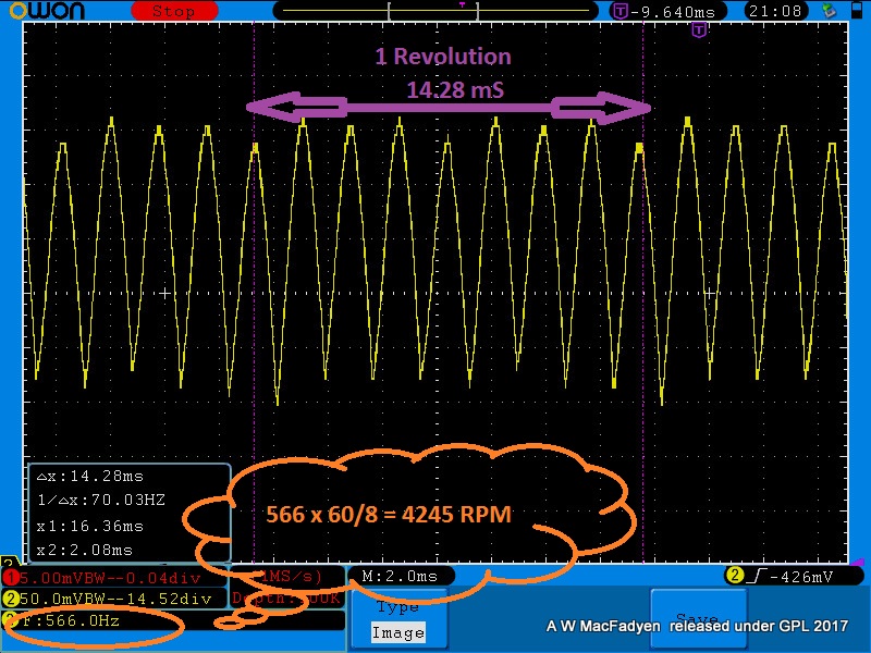

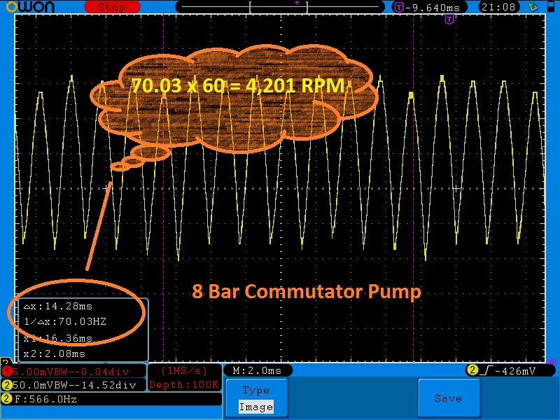

If your scope can measure frequency you can use it as an easier method of measuring fuel pump RPM
Frequency x 60 / number of bars on pump commutator. = Pump RPM
Alternative if the scope can calculate frequency of time included between vertical cursors.
Frequency x 60 = Pump RPM
