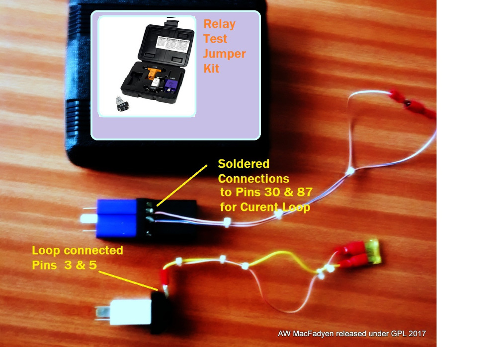

Relay Test Jumper Kit modification to reduce risk of computer damage
9 years 4 months ago - 9 years 4 months ago #10553
Relay Test Jumper Kit modification to reduce risk of computer damage was created by Andy.MacFadyen
Curent loop soldered on to contact terminals for permanent connection reducing risk of shorting computer by misconnection when using curent clamp.

Now that's cool, I was about to buy a set of those relay switches with the loop on them. I have a set like you have modified and will give the mod a try.
Thanks!!!!
Thanks!!!!

Nice!
I have the master kit of those, and I'm ALWAYS nervous about shorting across the control side pins with a test light or something. Love 'em, but you gotta be paying attention...
