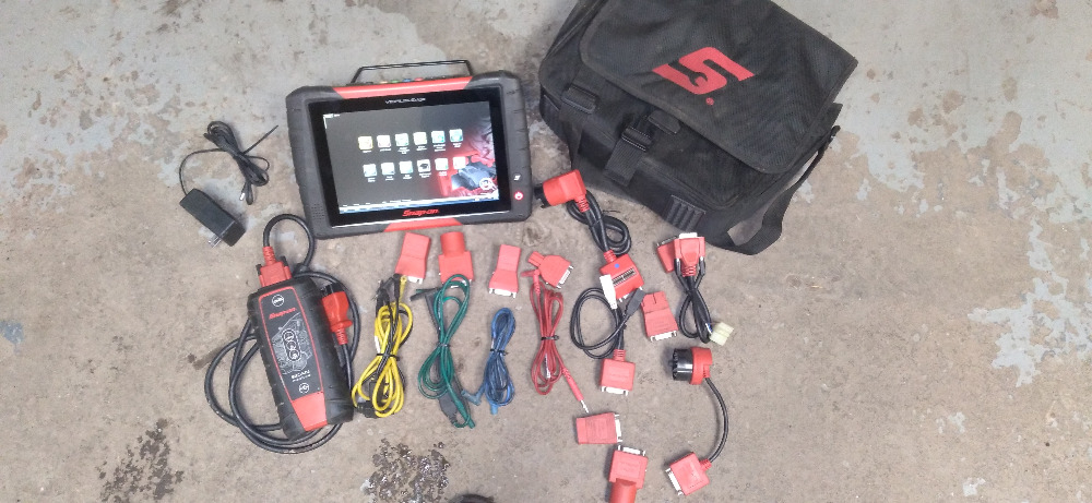

Would your Verus Edge come with the carrying case and all the other cables and accessories?
Could you provide a pic of the whole kit that you would be selling?  I don't want to assume anything.

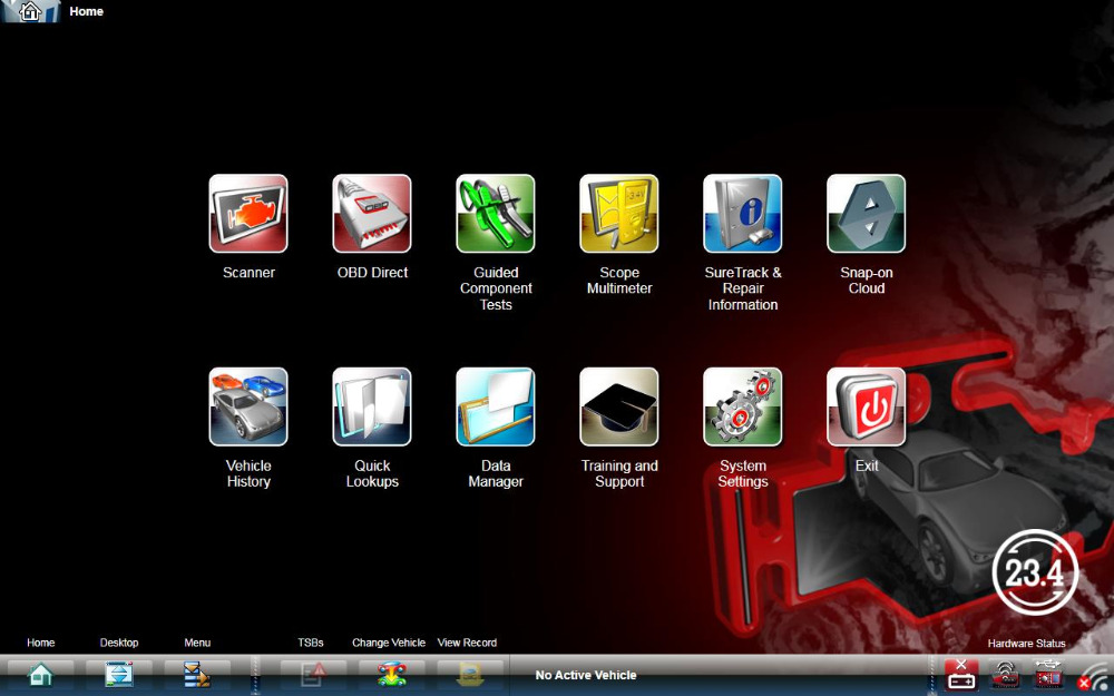

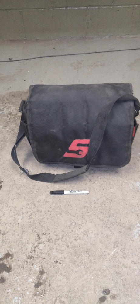

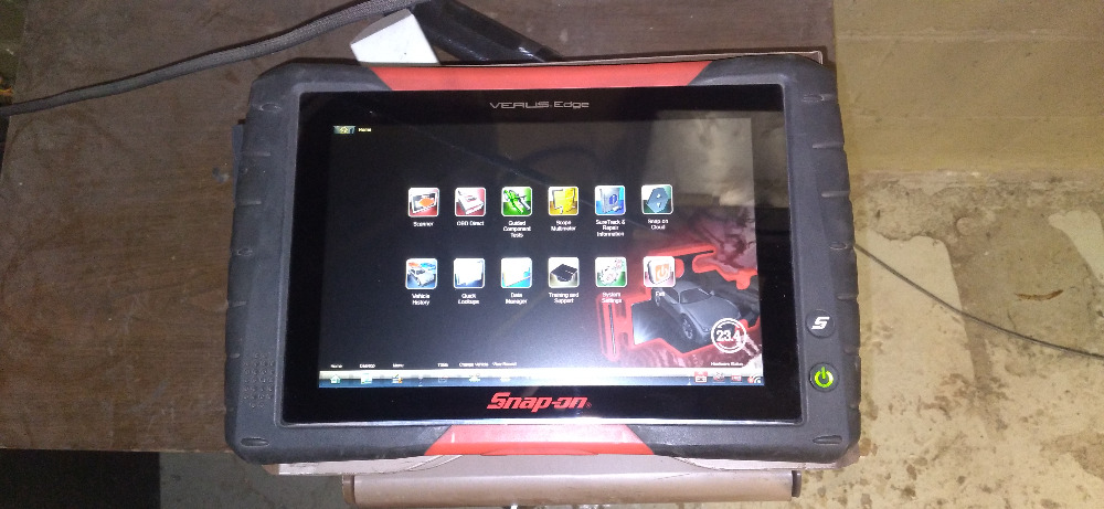

I do not have the original Verus case, but I will give you the case that came with the Zeus.
I, also, have a brand-new Tempered glass screen protector. I removed the old protector, to take the pictures, as it had a small crack. I removed it to show that the scanner screen is not cracked, or scratched. The new one is, still, in the package and will need to be installed.
I will include a set of test-leads and an AC adapter, for charging. (The battery is, only, about a year old...maybe, two.)

2 years 11 months ago #63702 by Timmy the Toolman
Replied by Timmy the Toolman on topic Snap-On Verus Edge (Is it still worth purchasing?)
Hey Chad,
Thanks for the pic of everything. Would the test leads also come with the alligator clip ends? I saw that those came with the original kit.
