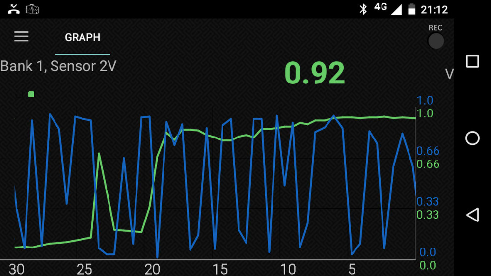

For Android software there are few option Torque Pro is the most commonly used but very slow to setup a pid list OBD Car Doctor Pro once you get to know how to pre-set up the custom combined widgets gives very good graphs.
This a screenshot from of OBD Car Doctor Pro from my Moto E4 Plus
Another one worth looking at is EOBD Facile it hs a great range of features but] the graphs are unuseable
