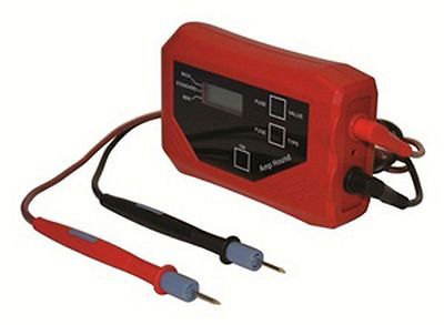

Hey guys, wanted to share a very nice tool with you fellas. Not sure if it is old news, but thought it is worth posting if you have not seen it. If any of you do parasitic draw tests, you know it can be a real pain on late model vehicles. When I started in the field we used a test light, and then of course moved to using a meter to see if we had a draw. The meter is still used of course, to confirm if we do have a draw happening. Now when we get to the part about having to start pulling fuses things can become a headache. As you pull a fuse and re install it you can and will wake up different modules. A year or two ago, I found this tool and have used it many times. It is faster and more reliable a method to find the circuit with the draw than any other method I have tried. It's called the Amp Hound.
What I do is make sure driver's door is latched, all other doors are closed, hood is latched on some models and then confirm the draw using a fluke meter. After that is confirmed I begin testing at the fuses with the Hound. This thing is amazing and very reliable to quickly find the problem circuit. Best money I spent on a tool in along time. I am planning to make a video on my channel the next time I have to use it.

I've seen those around but never used one. Does it measure voltage drop across the fuse?

It actually measures current flow across the fuse. Very good time saving tool and as I said, accurate.

It'd convert voltage drop to current flow surely?!

Yes it is really a sensitive voltmeter that is using the resisstance of the fuse as a shunt resisstor to create a tiny voltage drop.
All lot oridinary multimeters even quite low cost ones are just sensitive enough at the lower end of the milivolts scale to do the job but many aren't.
Tables to convert fuse voltage drop to current can be found at a few places on the internet.

Yes, my fluke 88 has been used in the same way. I simply find this tool to be easier and more reliable in testing than using the meter. Amp Hound also converts the voltage for you, so there is no need for formulas.
