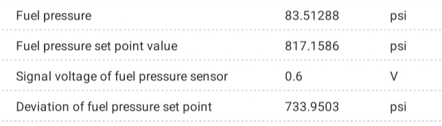

2012 Sorento 2.4L, came in with a complaint of low power and MIL. It had exactly the code you took as an example, P0087 Fuel Rail Pressure Too Low. Engine has a long crank time and low power, just like the owner stated.
Scan data showed this:
Actual rail pressure is 83 PSI, desired is 817 PSI. So the high pressure pump isn't working. The high pressure pump needs low side pressure, a mechanical connection to the cam lobe and solenoid control to work.
I can be reasonably sure the low side pump is working, because 83 PSI is a reasonable value for the low side system. That also means the high pressure sensor is likely telling the truth. If the actual high side pressure was higher than 83 PSI, the engine probably wouldn't have a long crank. If it was closer to zero, the engine probably wouldn't be starting at all.
Amp clamp on the solenoid control wire shows good circuit current. After that, all that's left is the camshaft and the follower. Engine isn't noisy, engine oil doesn't have glitter in it. I sell the high pressure pump and a careful explanation that any damage found to the camshaft or follower will require additional repairs. High pressure pump fixed it.
How would you definitively pinpoint the root cause of this problem without removing a single component, without disconnecting the steel pipe, without inserting your own pressure gauge? Can you develop a formal diagnostic procedure that can powerfully arrive at the correct diagnosis -- each and everytime?
Is the above a 110% accurate diag? No, the camshaft is a loose end. But It's pretty thorough, doesn't require gauge installation and has no unnecessary disassembly.
In my experience, in a repair shop environment, this is about as good as it's gonna get. You could pull the high pressure pump for a visual, sure, but what happens when you find no camshaft damage? You can let the car sit in your bay while the customer doesn't answer their phone. Or, you can put it back together and hope you make the time back doing the repair. If the customer buys it at all. They may price shop you and take it down the road.

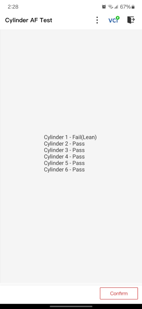

I completely agree with your lack of trust in scan tool injector balance tests, but for different reasons. My experience with performing the balance test before and after injector replacement shows that the tests themselves just don't have the consistency needed to accurately ID a problem injector.
As an example, this '17 Pilot 3.5L came in with a P219B Air/Fuel Imbalance Bank 2. There's an injector balance test (Cylinder A/F) available, and it generated this:

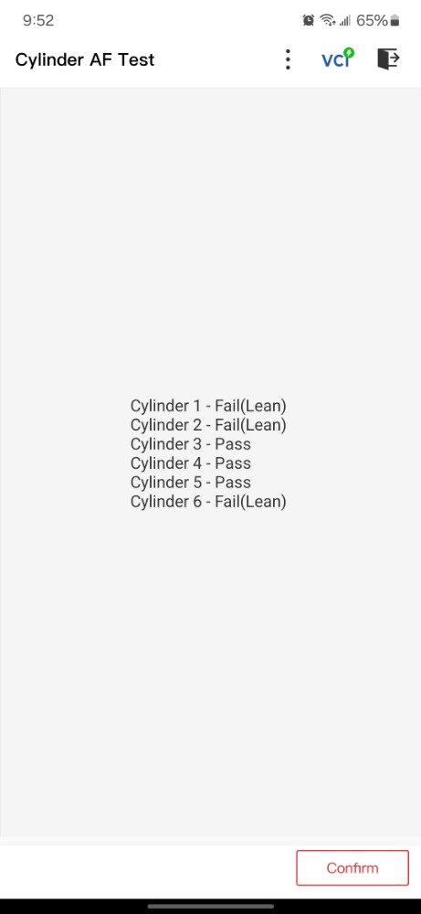

Sure looks like there's some issues, right? After I put a set of Honda injectors in it, I reran the test and got this:
So, my new OE injector is bad? Test drove multiple times, no fault codes came back. I feel pretty confident I fixed the P219B, so I can only assume that the test itself just... sucks. Plus, my understanding of the Cylinder A/F test is that the results aren't based on the high pressure rail sensor readings, but on the upstream air/fuel sensor.
But you cannot perform manual injector balance tests on a GDI system. The high pressures and disposable steel pipes in a GDI system mean that all injector balance testing must be done through the vehicle's computer... which is vulnerable to breakdown because of their harsh environments.
