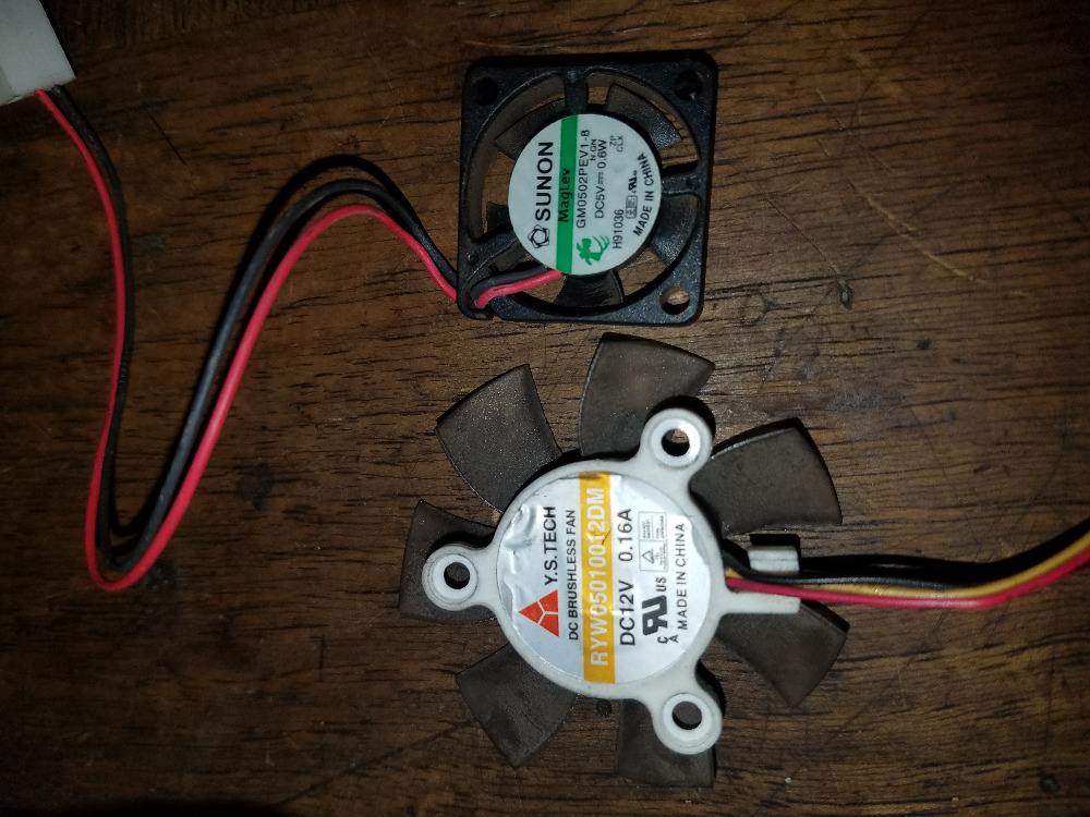

The fan on one of my Veruses has begun to squeal. I have tried to find a replacement fan, but my search has come up empty. I can find a lot of web sites that have the fans listed, but none in stock.
Does anyone know where I can find these fans? Or, possibly, does anyone have an nonoperational Verus that can be used for parts? The larger fan is my main concern. It is the fan for the processor heat sink. It is frame-less and 3-hole mounting.

another option, a lot of times underneath that sticker there is a flat cap That if you pry off you can score a little WD-40 or lubricant that may help you. At least the smaller fan should have this. You can also check for a bearing cover on the other fan at this point couldn't hurt, and you might get yourself up and running while you wait for a more permanent solution. Most of the time dust is what stops these motors anyway, compressed air like the kind you pick up at Staples or Best Buy or OfficeMax will dislodge whatever's impeding the motor and then followed up with a little lubricant.. Hopefully this helps
