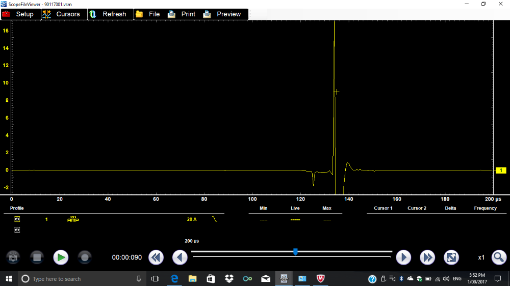

As I am very new to a scope and have been following through Paul's book and classroom lecture videos, I was doing some playing around with my modis edge I just bought. Looked at cam and crank wave forms, o2 signal, map sensor sig ect and all came out as I had been taught. When I was trying to do some primary current ramp wave forms of both ignition and injectors with the low amp probe, I was getting wave forms that looked like primary voltage patterns not the ramps that Paul shows. I was on the 20amp scale on the probe, picked the 20amp from the probe menu, tried 5,10 and 20 amp scales on the scope and several time bases. Can anyone think of what I am doing wrong?

I think it possible you might have answered your own question I suspect the leads between the amp clamp and the scope are acting as an antenna and picking the ignition secondary, Try routing the cable as far away from the ignition system as praticable.

You were right it was feedback from the ignition through the probe not the leads. Got rid of the feedback but still couldn't get a ramp waveform. I will watch Paul's verus series and see if I can pic anything else up.
