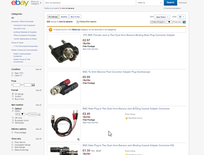

Is it possible and advisable to use a banna plug to bnc female adapter to use a BNC type hantex low amp clamp? I ask because I got a verus but I first got a shitty hantex 1008 puke and it came with BNC type plug ins as a result I have the clips for spark plugs distributer coil pick ups can they be used on Verus? And I also have leads from an OTC 3840 mainly a Black trigger theres pictures but it has a funky end with two plugs I want to know if its possible to use this I know snap on has an Rpm pickup reasonably priced. Also it has nice test leads which have BNC male connectors. Please give me advice gentleman.
9 years 2 months ago - 9 years 2 months ago #12528
Replied by Andy.MacFadyen on topic Snap on verus and the use of banna plugs to bnc female adapter
There all sorts of BNC adaptors avaiable on eBAY try a search on BNC to Bannana you will find a large number of options at a wide range of prices

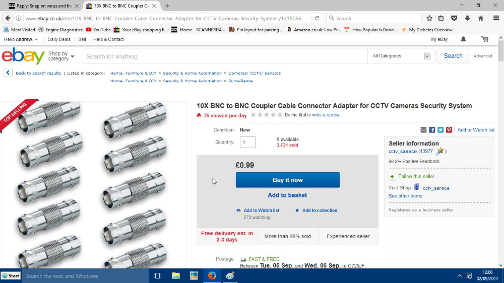

You might also find you need a female to female BNC coupler to change the gender of your BNC connector.
BNC Female to BNC Female Joiner
