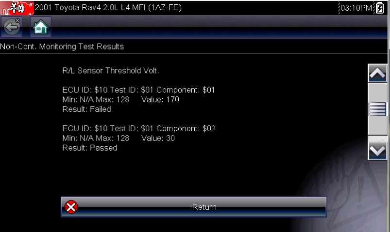

Cool setup - buy one catalyst, you get the other included! :lol: I take a glance at the Mode $06 for the catalyst monitor:

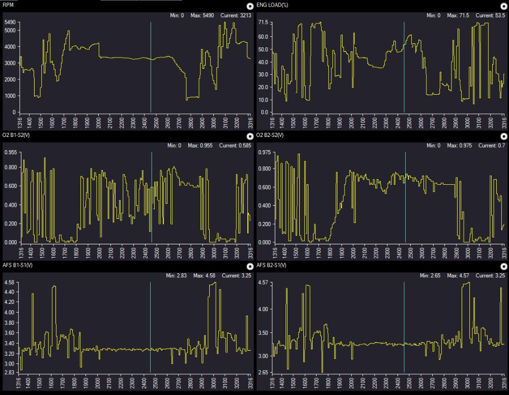

Agreed, I look for the same. Unfortunately, the data rate is so painfully slow on this year of Toyota that it's very tough to get an accurate picture of the rear switch rate.
This is what I saw on the initial test drive:

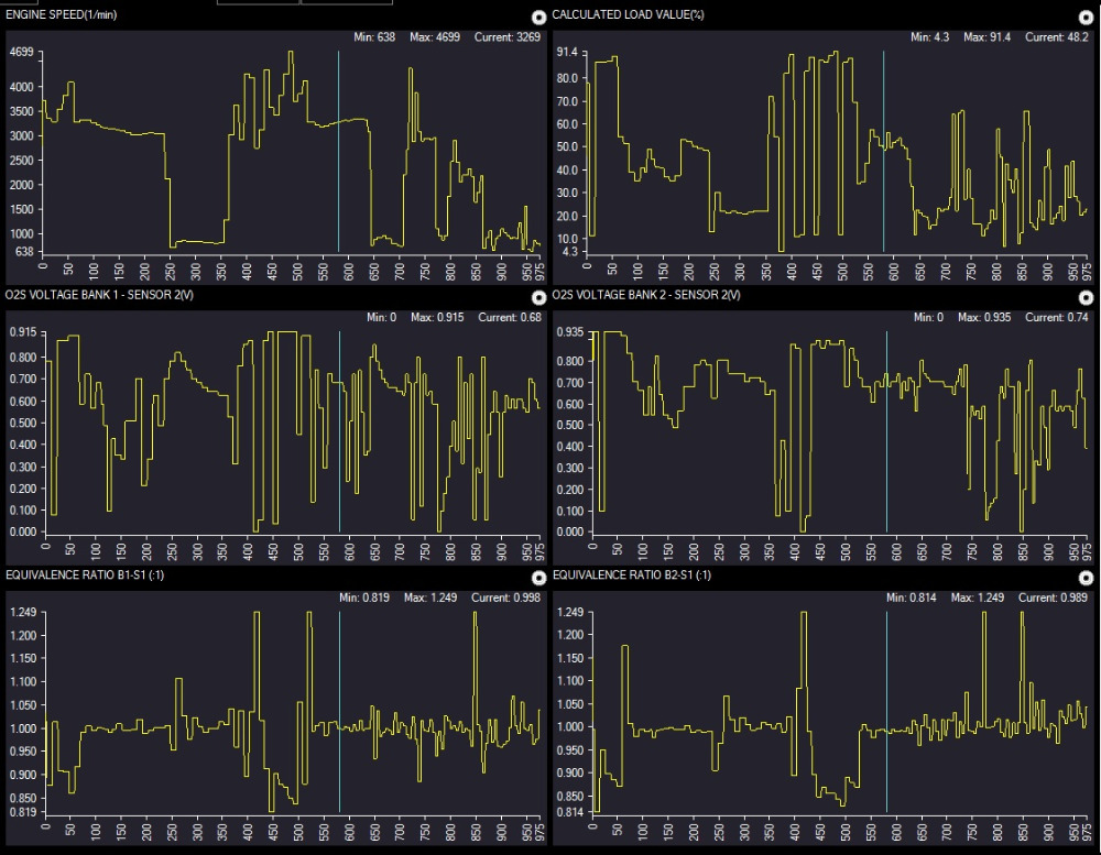

Definitely a switching issue on bank one, especially compared to bank two. I didn't have as much time to play with the data on the second visit, but I did grab this Global data:
Still a switching issue.
The more I look at this, the more I have to think that the bank one cat is still on it's way out...

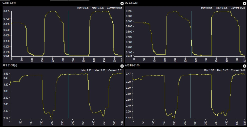

I remember that video! :lol: I thought of the oxygen storage test, and performed one on this vehicle. I used the bidirectional A/F Rich Lean test, which jams the fuel trims 25% positive and 12% negative on command. There's a clear storage difference between the two. Didn't have a chance to repeat the test afterwards.
