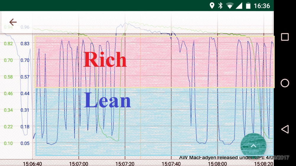

Dears,
I want to know the rich and lean condition of Lambda. I want to test fuel delivery issue using lambda as my source of diag. what is rich and lean condition of Lambda?
Thank you
Thank you

Replied by matt.white on topic Re:O2 sensor Lambda Lean and Rich
Are you referring to a wide band oxygen sensor?
If not, a rich a/f ratio is less than one. A lean is greater than one.

8 years 11 months ago #12653
Replied by Tyler on topic O2 sensor Lambda Lean and Rich
Listen to Matt and Andy.
.9 lambda or lower is not unusual during wide open throttle. Very positive numbers (1.5 or higher) are expected during fuel cut deceleration.
