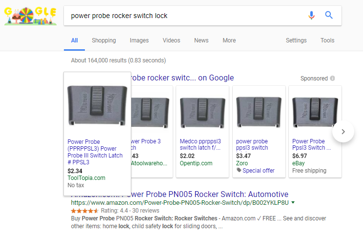

This latch is a handy accessory for keeping power applied, or making it more difficult to hit the rocker switch. It does make it difficult to apply a quick, momentary power.
