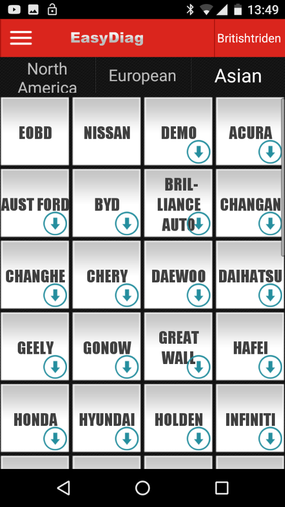

The Launch Easy Diag 2 looks like a viable tool for advanced hobby level diagnostics. The software runs on any Android or Apple Phone or Tablet. The software is modular you buy the software modules for a particular manufacturers you require. The range of manufacturers and systems covered is huge similar to that covered by the Launch X431. The Amazon price of the basic device without software modules is around £50 in the UK or 60$ US but to this you have to add the cost of software module subscriptions which are roughly £24 or 30$ each. The system coverage for each manufacturer appears close to that of the Launch X431
This makes it a fairly attractive for anyone working on limited range of vehicles.
I have order one expected for delivery expected on Monday and will test it and write up a review.

It arrived today software registration was pretty painless although Bluetooth pairing took a few attempts. As soon as the dongle is registered and paired you select the manufacturers modules you want to buy and download.
At this point there is a hidden charge plain as vanilla OBD2/EOBD is charged as a manufacturer I chose the option to choose a bundle of three manufacturers (Rover, Nissan and Renault + OBD2) . There are a huge range of manufacturers to choose from and if you work on cars from really obscure manufacturers such as GAZ or Zotye the Easy Diag 2 is probably the most useful scan tool you will find short of buying a full Launch X431.

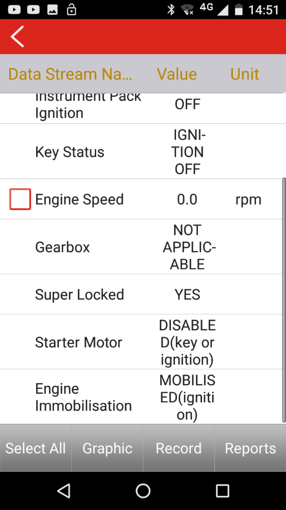

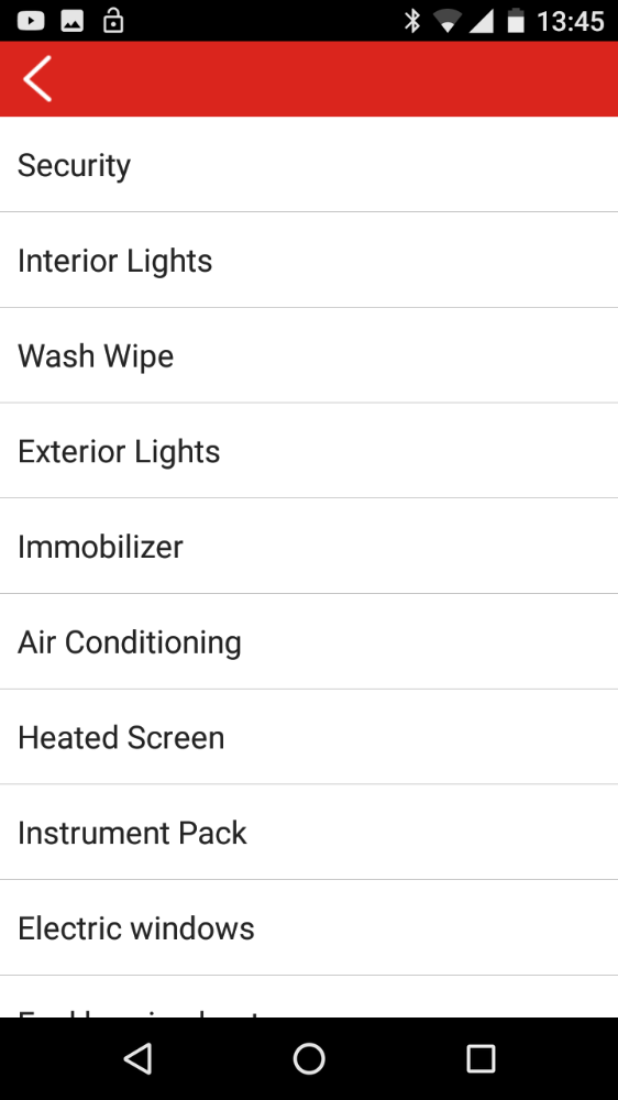

My reason for buying this dongle was do a lot of work on an orphan brand (MG-Rover) that has zero coverage from nearly all scantool manufacturers with the notable exception of Launch who cover it on their X431 but not on the Touch Pro or CRP ranges. In particularly I needed to be able to diagnose the Rover ABS system and to my surprise the module will talk to every module on the vehicle although there is no modules present check so on poverty spec cars modules that aren't fitted are listed.

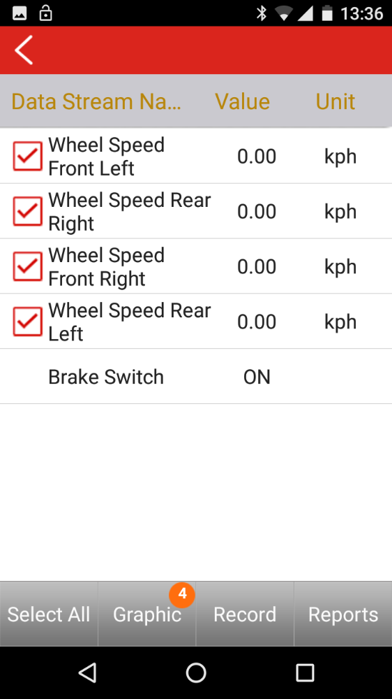

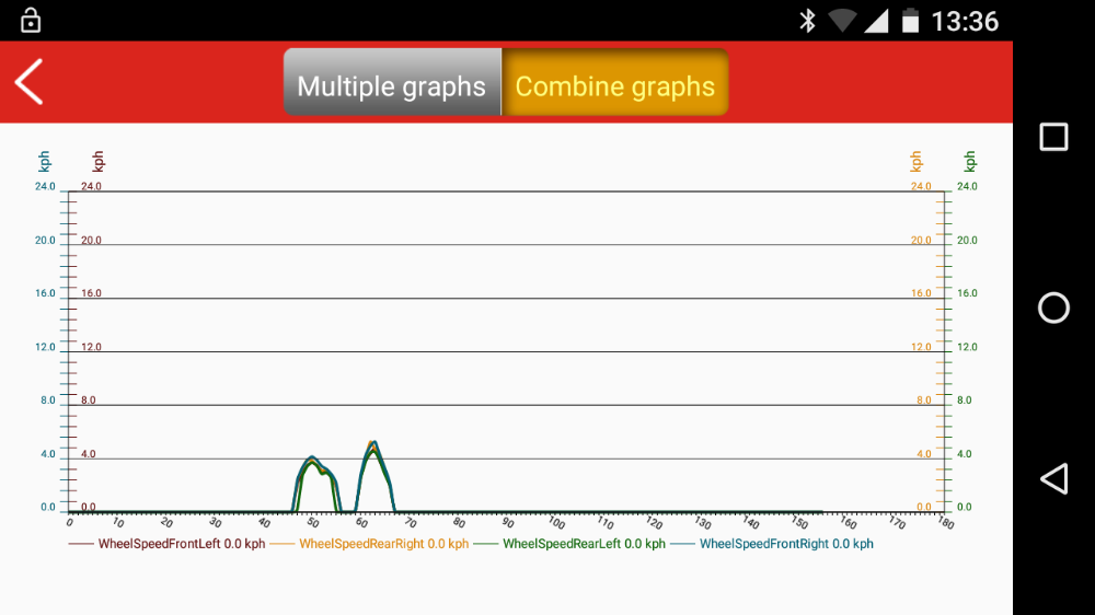

ABS live data works nicely however graphs can't be scaled.
