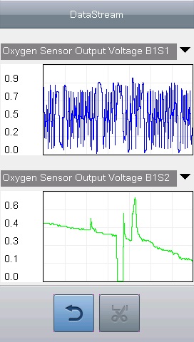

OBD2 is a bit iffy connection is a bit hit or miss. OBD2 has two options auto detect protocol then select manufacturer or select manually protocol strangely these produce different data lists. As a result if I want OBD2 I use a cheap Bluetooth dongle.
Graphing works but is very small --- graphs and screens can be saved to SD card.

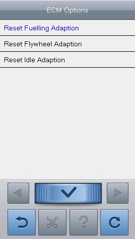

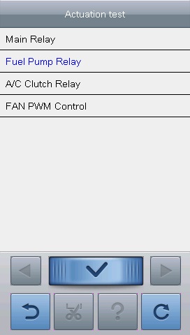

In manufacturer mode MG-Rover mode works up to a point for example ABS diagnostic usually won't connect and bi-directional control won't work curiously If I connect to an MG ZT telling the scanner the car is Land-Rover Freelander 1.8 bi-directional controls works.
BMW mode seems to work okay at least on the E39 and E46--- I can connect to most but not all modules and alter options.
Nissan Note some bi-directional tests seem to work
