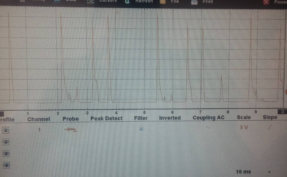

Dears,
I have done a relative compression test on my toyota avalon 2012 v6 3.5 engine. Here I have uploaded the picture and I want to know your opinion of this test
Thank you

Replied by Dylan on topic Relative compression
Aloha
I prefer to do a relative compression test with an amp clamp.

Replied by Ro-longo on topic Relative compression
Very difficult to make anything out with the picture provided. Can you try to upload a better image, thanks.
Check this one out from Motor Age if you want to perform a relative compression test without an amp clamp. Also notice the AC coupling.

Thank you all.
I used Low Amp 20 .... relative compression test on Toyota avalon 2012 V6 3.5L. Photo updated.

Replied by Tyler on topic Relative compression
Can you show us the same capture, but zoomed out? 500mS or 1 second on the screen would be great.
It seems like the amp probe is struggling to measure current consistently... If you were to use the same probe on a steady draw (headlight, blower motor), does it behave the same way?

Replied by Andy.MacFadyen on topic Relative compression
With a 3.5 V6 the starter will take a huge current out of range of your clamp, as already suggest do a voltage relative compression instead .
When working single handed I do voltage relative compression test by just plugging into the cigar lighter socket. I first do an DC test to check the cranking voltage to check battery condition and charging then switch to ac for relative compression.
