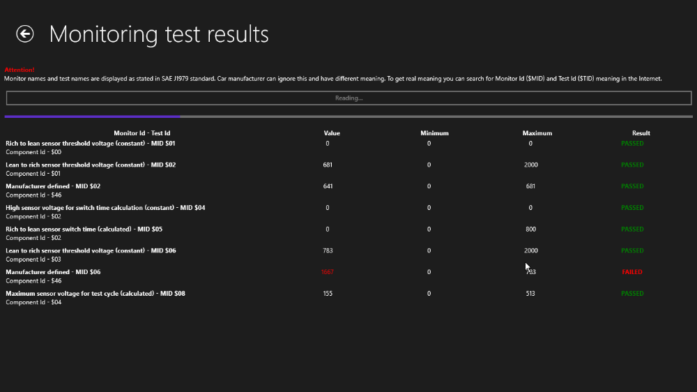

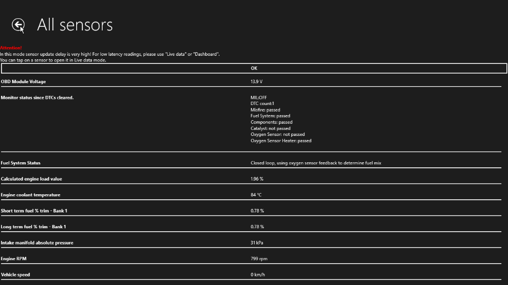

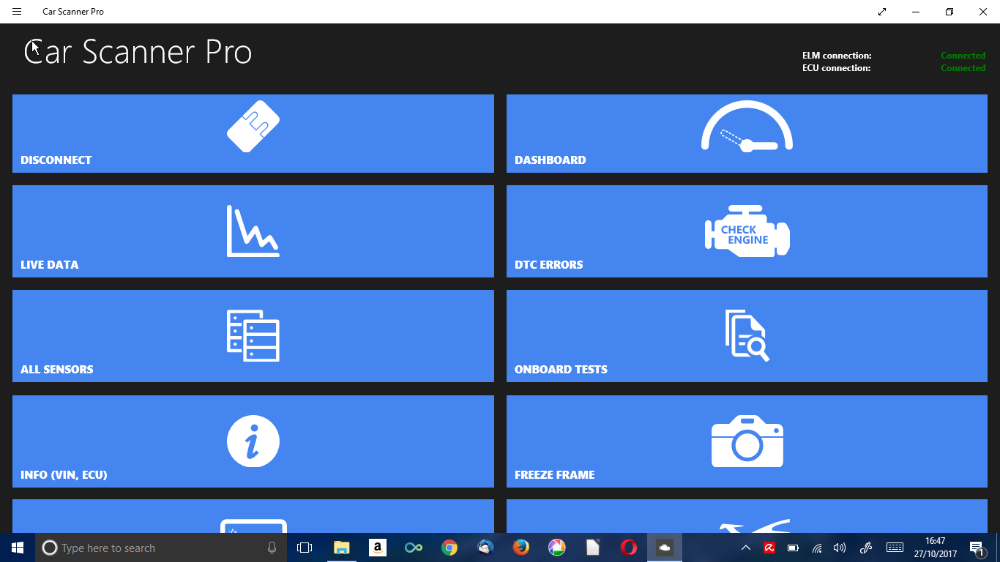

Out of curiosity I down loaded a Windows app from the MS Windows store Car Scanner is a pretty standard OBD2 app but it works well and the full version costs less than 5$ or £3 It can be used on Windows 10 or Windows phones, it works very nicely with a touch screen

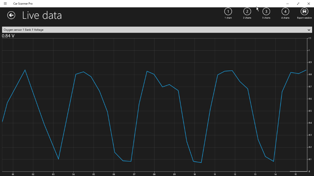

The main main faults I found are it failed to retrieve the VIN on the vehicle I tried it on, it reports condition monitors that aren't complete as failed and the graphing could be better although the graphing is better than the Torque Android app.
