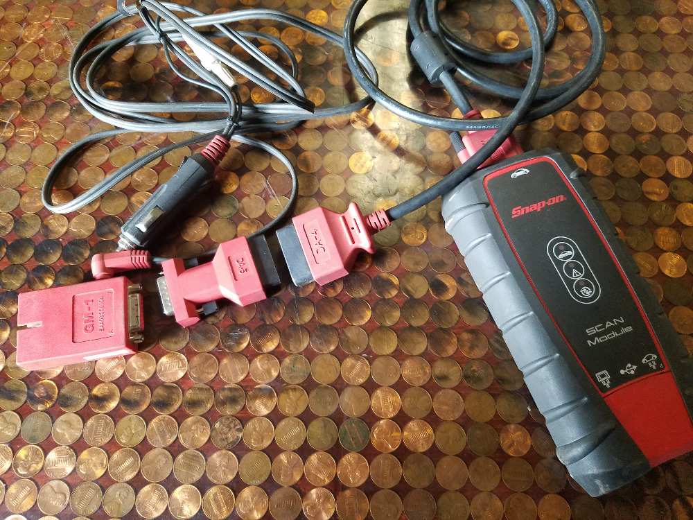

Clearly, you still have a need for OBD-I. I do, as well. Adapters sell for less than $20, each, on Ebay....A whole set for $150.

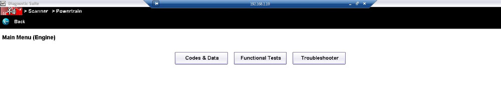

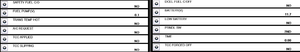

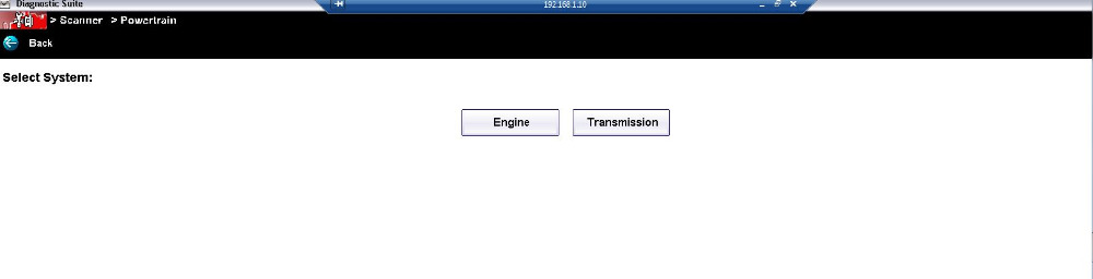

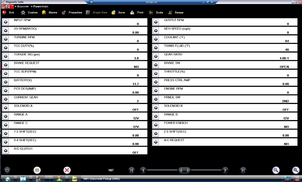

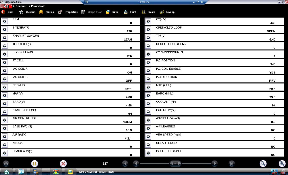

My personal truck happens to be OBD-1. (1991 Chevy K2500) I'll connect it, tomorrow, and post a screenshot.

You asked, specifically, about fuel trim. Block Learn and Integrator are your LTFT and STFT. 128 being Zero. Anything above is positive. Anything below is negative.

Or is there a chance that the Snap-On reader shown in his posts might be able to pull as much as a Tech II?
