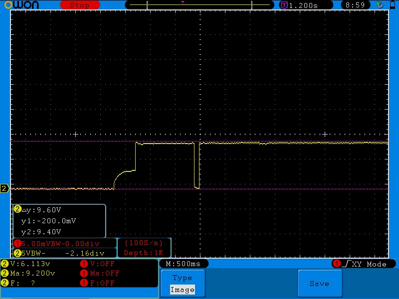

Scope picture giving nice confirmation of airbag impact sensor repair.
  • Andy.MacFadyen
8 years 11 months ago - 8 years 11 months ago #14916 by Andy.MacFadyen
My auction buy's airbag left side sensor post repair diagnosed with Launch Diag2 and cleared. Repair then confirmed with scope. Before new part fitted it was flat lined - water ingress, Same basic impact sensor is used by many other Euro boxes.

Alright, I'll be the one...
What are we looking at here Andy, lol?

These impact sensors are only 2 wire but have a processor, at key on they do a self test and if it passes the sensor signals to the air bag control module by pulling down the power line for a few ms.
The front impact sensor on this Chevy truck in Paul's video is similar

8 years 11 months ago #15076 by Noah
Got it, thank you!
That first rounded hump coming off ground was unexpected for me. I would have guessed that there would have been only high-low signatures.
