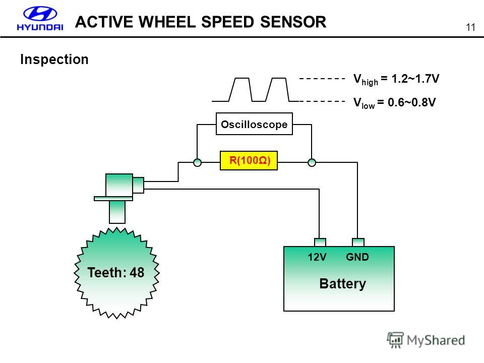

Interesting simple bench Test Method for Bosch Active ABS Wheel Speed Sensors
  • Andy.MacFadyen
8 years 11 months ago #15072 by Andy.MacFadyen
More on the Hyundai Bosch 8 ABS ESC here
