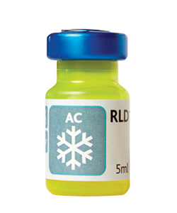

9 years 10 months ago #2893 by ian.broadbent
Replied by ian.broadbent on topic DIY smoke machine
hi there
Yes I got the glasses in with the purchase as well.
Cant open the ebay link
Ive included a pic of the uv dye Ive used, AC dye by ring.
Certainly using a smoke machine is the best way Ive gone for detecting air leaks,but the car I have now is defying diagnosis.With the long term fuel trim pegged at 23% saying air leak still.Fuel pressure flow are good and the injectors arent plugged or partially blocked.
Short term trim is all over the place +- 20%.
one thing I have noticed,oil fluoresces as well and alloy corrosion,I thought Id hit the jack pot until I looked at the smoke with the uv light direct from the hose
cheers Ian

9 years 10 months ago - 9 years 10 months ago #2918 by tony.redolfi
Replied by tony.redolfi on topic DIY smoke machine
this is my exact mix,,, 2.5 ml of ac dye to 14oz of plain Johnson's baby oil
it works great for me,, as seen in my video. I can just hold the light up to the oil bottle on the shelf and it glows bright
I cant seem to post links on this site.... but you can search these words and it will come up
" UV Fluid and Gases Leak Detector Kit Car A/C System Dye&Glasse w/ 28 Leds Light "
