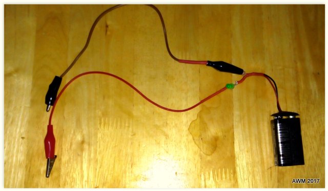

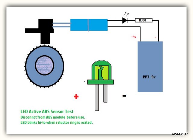

Home build Simple ABS active Wheel Speed Sensor Test was created by Andy.MacFadyen
Further to this thread --
Link to ABS sensor bench test
I put this together using info from a few websites

Is it possible to get more info on how to build this for the non electrical folks? I am retro fitting a Ford Racing ABS unit to my race car and would like to check the active sensor function since I don’t have access to trouble codes.

Hmmm. He's just using the LED inline instead of a scope. I would prefer to use a scope since I wouldn't have to count flashes and a scope would be more likely to show if a single tooth or two were damaged. ABS is not the focus of my work though and I've yet to need to check out any "active" systems.

I don't think I would want to retrofit any complex electronic system to a car if I had no means of talking to it with a scan tool. The LED tester was really intended for checking junkyard parts off car and as a make do measure for checking cars that no diagnostic system was available for. There is actually a commercial tool available that works in a similar way. For checking individual sensors the best way is use an oscilloscope even the very cheapest sub 100 dollar scope will do the job.
7 years 6 months ago #28918
Replied by Andy.MacFadyen on topic Home build Simple ABS active Wheel Speed Sensor Test
