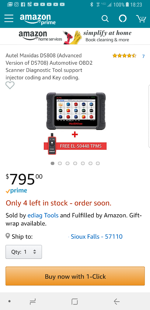

8 years 10 months ago #16277 by Dtnel
Replied by Dtnel on topic Verus for sale opinions
rockp2 wrote: Well arbez, I pulled the trigger and ordered the brand new Maxisys MS906 from a tool supplier. $959.00 with free shipping and also comes with a bonus TS408 tool. Possibly could have got cheaper from ebay, but didn't like some of the reviews I was reading concerning the sellers,and with all the clone and fake crap out there... I will tell you I was reading some great reviews on the tool itself. I think it will be a good fit for me for now. I seemed to "outgrow' the Autoengunity tool capabilities I've had on my my laptop for a few years. I'm a red-blooded-American-boy...I want "MORE POWER!" grunt, grunt, grunt :) (tool power that is) One of the auto technician magazines reviews I read stated this was probably the best tool for someone like me. Thanks very much for all of your help! Your advice was very helpful. Now if you (or anyone else) could take a few minutes to explain what the advantages are of having a DSO? I kinda thought my Vantage Pro fit the bill in in the oscilloscope area. What are the advantages of having a DSO also?
I don't know how the numbering systems go but how would this one I posted a pic of compare as I saw you guys were talking about the above and when I was on Amazon I saw this which when it comes to numbers don't know if the higher is better.
  • rockp2
  • rockp2's Avatar Topic Author
8 years 10 months ago #16278 by rockp2
Replied by rockp2 on topic Verus for sale opinions
There's a couple OS differences (kinda slight I think) and the main tool outer difference is the Maxisys 906 comes with a flashlight and camera mounted in the back panel (not that it had anything at all to do with my choice). In a side by side comparison they state that the MaxiDAS 808 functions almost the same as the MaxiSYS 906.
