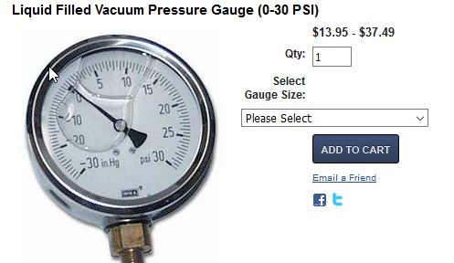

Pressure -- vacuum gauges in imperial/US units usually have scales in PSI above zero (ambient atmospheric) ) and inches hg below atmospheric I wonder if this what is going on here.
Easy way to check is to do a sanity test against shop air pressure above atmospheric and a vacuum pump with gauge for sub-atmospheric.

Who in their right mind would make a pressure transducer automatically convert everything below atmosphere into inches of mercury yet the whole scale is in psi??? That would be dumb! Oh wait... This is Snapon we're talking about... I could see them doing something like that!
As funny as that would be I don't think that's the case. I went over a capture I have on here and the exhaust plateau is at -12psi. So if the whole waveform is shifted down by 12 or 13 psi then that would make the largest vacuum reading of -23psi actually be -10psi. Which would put it around 20inHg which is a sensible reading.
