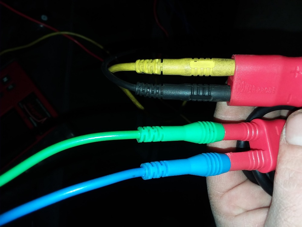

Is there a way to use the 20ft spare extension lead that i got with my kit to hook up to my dvom ? can use the probes and other leads as they are standard but the extension lead is keyed?

8 years 9 months ago #17413 by Noah
Replied by Noah on topic Power probe 3 question
The yellow and black is the one that came with my Verus, and the other two are out of the Lisle Relay test kit. They were just the first two I found that fit in there from my bag-o-test leads.
