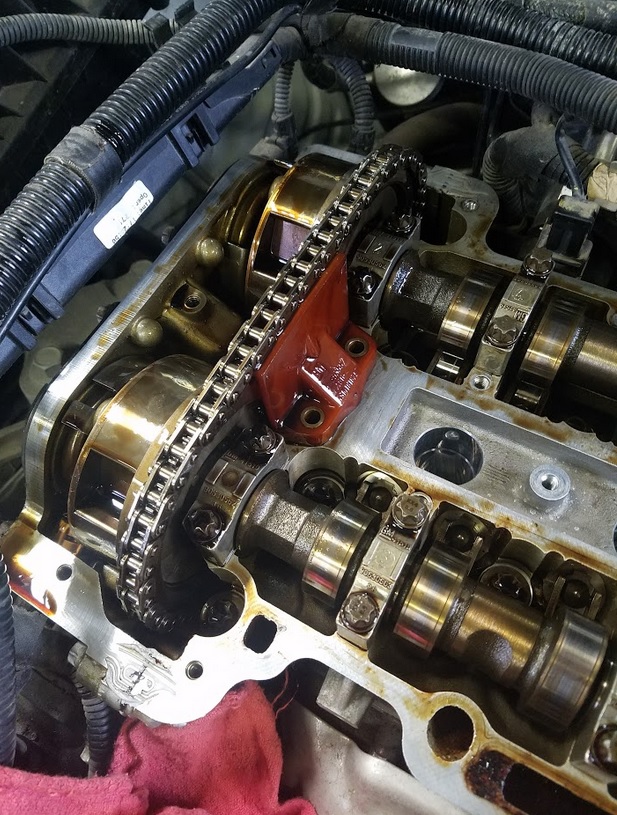

Just another heads up for the hard working folks around here. :cheer: This particular problem wasn't mentioned anywhere in SI, Identifix, or TSB's/PIP's. One obscure reference in the iATN TechHelp archive. Was this a one-off problem, or something more common? Dunno, but I feel like there's the opportunity for misdiagnosis here, thus the post.
2012 Cruze has a complaint of engine noise, no power, and the check engine light. They got their codes read at The Zone/Advance/O'Reilly/wherever, and they looked like this:

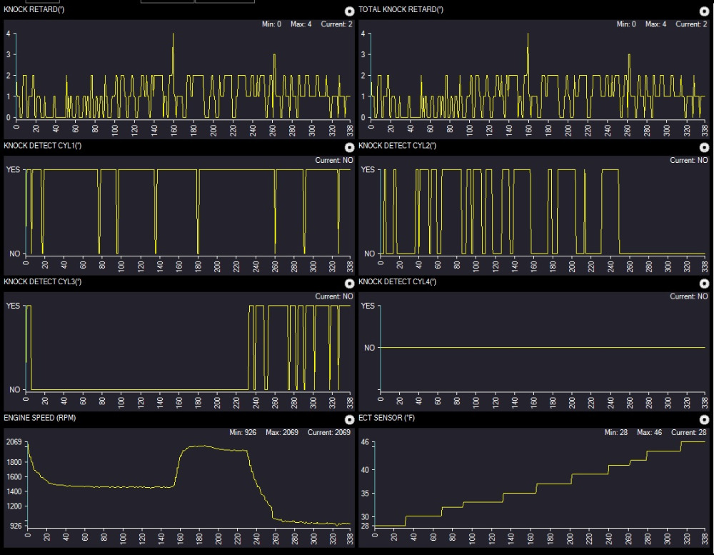

P00B7 is almost always caused by low coolant, so I skip that for now. Start the engine, and something's definitely ticking away under the hood. :dry: Doesn't sound like a rod is gonna try to escape or anything, but it doesn't sound good. I check the available scan data for anything useful, and I'm surprised to find this:
Not only is there the usual Knock Retard data that we find on GM's, but it's also got PIDs for cylinder specific knock. :huh: The data seems pretty confident that cylinder #1 is the problem, so I remember that for later. Is this accurate? Who knows. :silly: For giggles, I run through a power balance test to see if there's any weak cylinders, or if the noise goes away/gets worse. All cylinders are contributing, and the noise never goes away.
I poke around with the stethoscope for a bit, and decide that I'm getting the worst of it from the valve cover, above cylinder #4. Definitely in the upper end. This kinda flies in the face of the scan data I saw earlier. :unsure: Whatever, stethoscope don't lie, so the valve cover comes off.

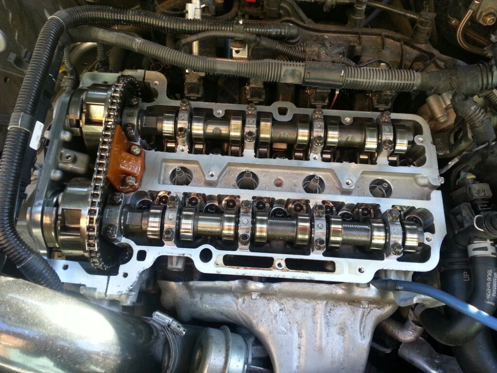

Not my image, just providing a lay of the land for anyone unfamiliar. I poke at the rocker arms, and find both intake lifters for #4 and one intake lifter for #2 are not pumped up at all. :blink: That'd be our noise. But why? Could just be a case of bad lifters. Before I move on, I shake the timing chain between the cam actuators, and find the upper guide is finger loose. :ohmy: The bolts are loose, too.

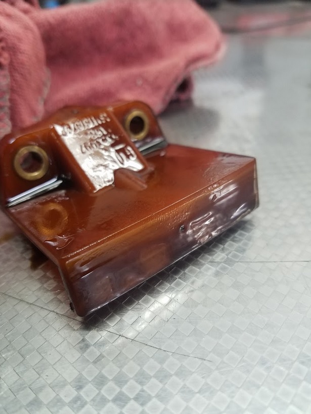

That's the one. But why does that matter? Look underneath.
There we go. :cheer: A oil pressure leak in the upper end could definitely cause lifter issues. Tightening the bolts made everything quiet, no codes returned.
FYI, reason for the oil passage beneath the guide is because the guide also has a small port to lube the chain as it goes by:
I don't know the service history on this one, so I can't say if the loose bolts were the result of a previous repair or not. The cylinder specific knock PIDs were cool, but ultimately not that accurate, so I'll pass on those for now. I can easily see someone throwing a set of lifters, a knock sensor, a module, and who knows what else at this one.

The scan data was accurate in that it identified the cylinder firing at the time the knock occurred. Remember, those PID's are intended to identify knock from detonation, not mechanical knock. This was a good example of the importance of a good, thorough, basic mechanical inspection. Great work! Thanks.
